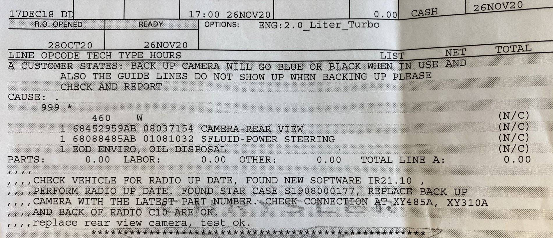

Hmm.. the dealer apparently fixed mine by replacing the camera unit and harness.
Never had any issue with the camera since then. (been 6 month)
I used to have this issue once or twice per week.
Arterius2
Jerry
Dec 29, 2018
42
3,527
4,858
Vancouver, BC
2018 JLU Sahara 2.0L
It is a known issue higher than the dealer can handle. All they will do is flash your computer then the lines will be there. When you get home and back in they will be gone again. The issue is being worked and there will likely be a patch at some point. Until then the recommendation that I support from earlier in this thread is to make a game out of whether you will or will not have lines! :CWL:
Also for reference sake here was the record for what they did.
Jeep Wrangler JL Lost backup camera guide lines C70882CA-CAB3-48AA-9673-F043BE49606D

Maybe the "blue or black" part was able to put you over the edge to be replaced. I don't have those issues. Just the intermittent lines.
Black and blue will always put you over the edge. :)
My guess on this issue is that it is related to the 8.4" Uconnect. @Arterius2 - My guess is that you, in fact, had a bad camera.
@JeepAustinWeird - Sounds like you may have a deeper issue.
