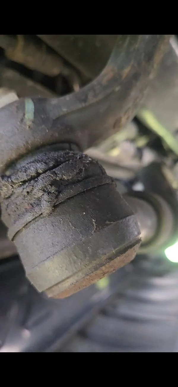

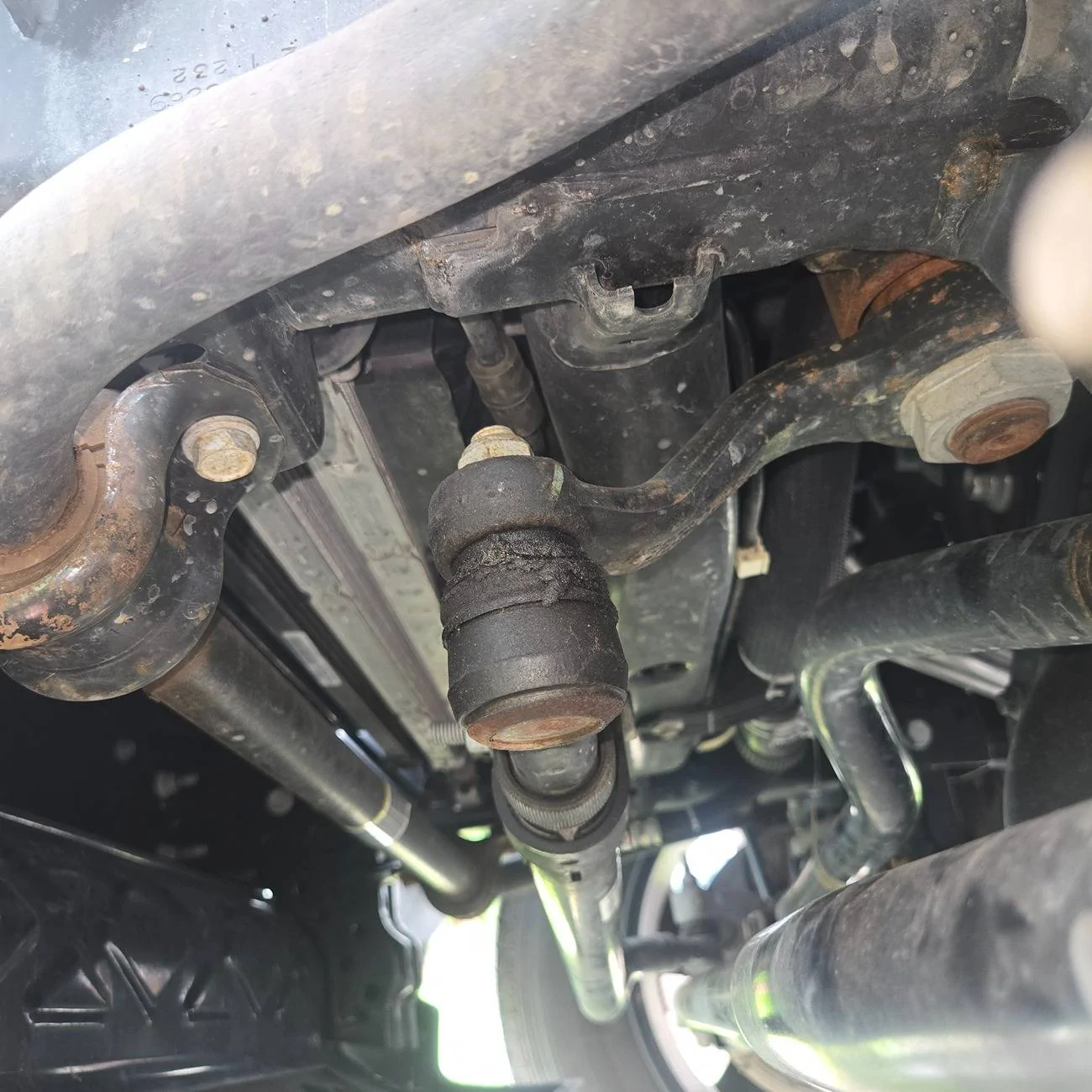

I purchased a stock jeep back in april. First few weeks were smooth sailing. Had it inspected and rear shocks needed replaced. After shocks were replaced dash threw a code for the clock spring going bad, so had that replaced. Started having very loose steering and wobble in the front end. Had the oil changed and tires rotated and torqued to spec. Still having issues, mechanic says everything looks fine but to keep coming back that it could take time for what's actually wrong to show itself. I decided to crawl underneath the jeep. I found a tear in the boot that connects the drag link and pitman arm. I'll share a small video of the movement that appears to be normal but there is a ticking that im not sure is okay when the wheels are moving side to side. I want to update the sterring and suspension, but I have a service warranty under ally auto that pays for failing sterring, suspension and all other major components on the jeep. Any help is greatly appreciated! i wiped off boot to confirm tear Jeep Wrangler JL Loose steering, wobble in front end 1000010925 Jeep Wrangler JL Loose steering, wobble in front end 1000010919 https://youtube.com/shorts/rLH9yJPNTRY?si=i9AL0c68s4QC-LtB

As mentioned, check the torque of the castle nuts on your ball joints to see if that makes the clicking go away.
As far as the torn boot, I am surprised that your mechanic didn't catch/mention it. Good catch that you did. If there has been a drastic change between April and now, it's probably more than just "a Jeep thing." Unless you want to use this as a chance to upgrade to a heavy duty drag link, it might be worth at least replacing the stock drag link outer socket:
