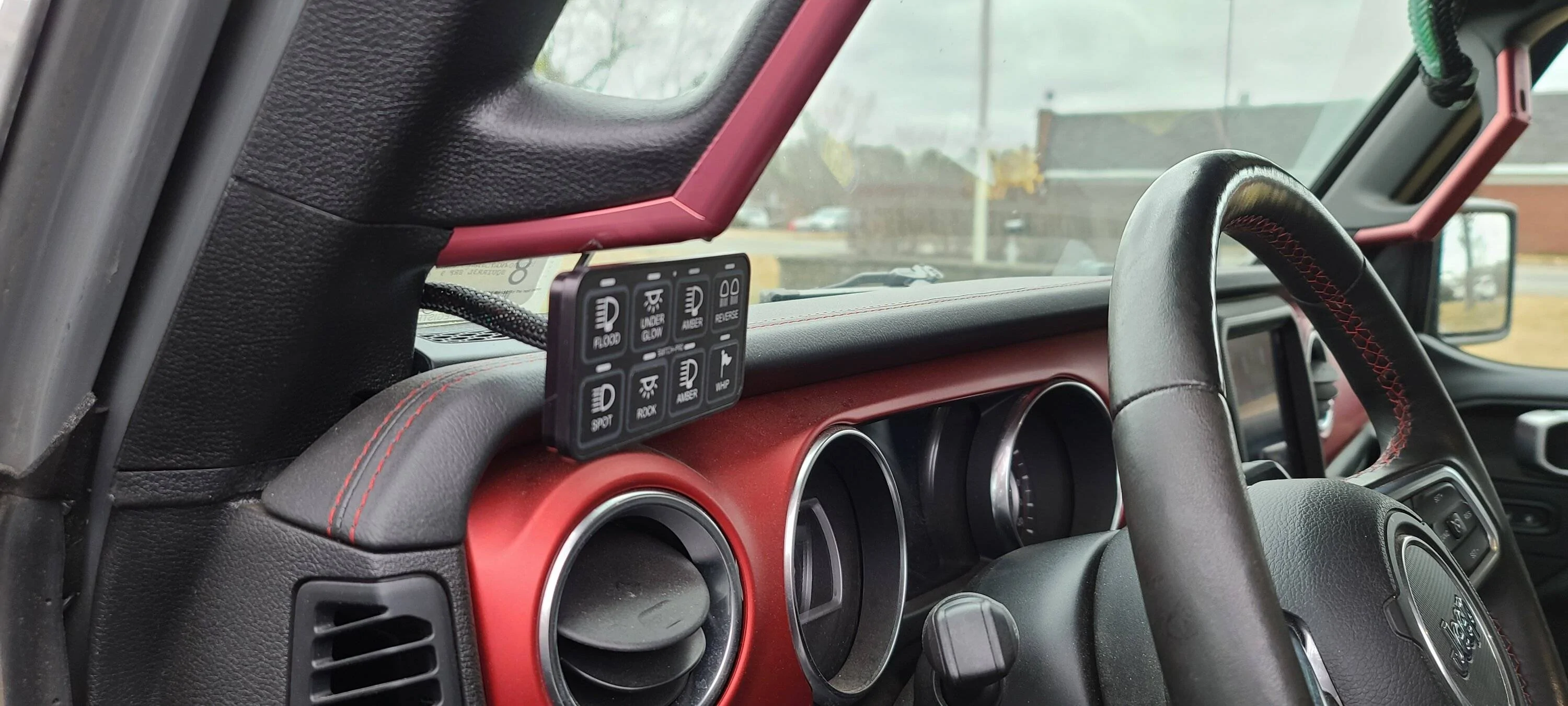

I opted for the SwitchPros SP9100 programmable 8-switch system. It has 2 main parts. A fully sealed and weatherproof controller that mounts under the hood, right next to the battery. It houses the relays, fuses, and provides the color coordinated wiring pigtails for each of the 8 available circuits. And the switch panel that mounts in the cabin, which only requires a single communications cable routed back to the controller. I'm using their mount that positions the switch panel at the bottom of the drivers side a-pillar grab handle.
