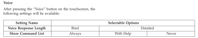

  1. Every time I place a call, I get the voice message telling me I can end it by pressing the phone disconnect button on the steering wheel. Knew that before I ever used it so that infinite repetition is a tad annoying.
I don't have my Wrangler, yet, but a quick scan of the user manual (what else can I do with no Jeep?!) shows:
Jeep Wrangler JL Looking for Fixes to Alpine Annoyances Screenshot 89
Try "Brief" length, maybe?
Thanks for that. That took care of her reminding that you can hang up when done. Still have the phone crap stuck on the screen after the phone call is complete.

That worked like a charm. Just left with the phone page issue.
Cool. I had a feeling that would work. My GM has the same sort of setting.
