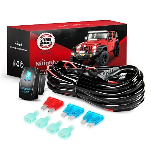

Gary,
Be careful when adding additional accessories to factory fuse/wiring. To do this correctly one should find out how many amps the factory wiring is rated for and how many additional amps your adding to it.
I use a kit or something similar (see link) this way I know the wiring is the correct amperage to handle the accessories I'm installing. It also makes it easier to troubleshoot should you have any future problems. Wiring, fuse, switch, relay - accessories.
I'm certainly not telling you or anyone else what to do with your jeep, just friendly advice. I've done this multiple times with flawless results.
Best of luck.
https://www.amazon.com/Nilight-Wiri...hvlocphy=&hvtargid=pla-4583451676199711&psc=1
