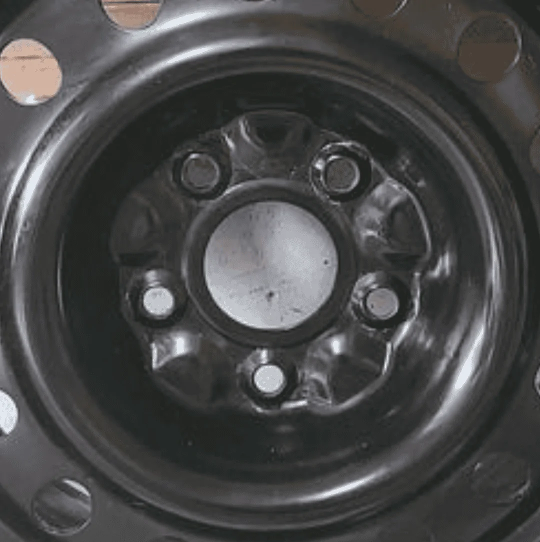

So I assume you are talking a wheel like this if I want to put a hub center cap on from behind the wheel (see pic). I was originally thinking of something more like what the stock Jeep steelies use that gets held on by the nuts.

See how the center bore I.D. is flanged up? That allows a center cap to go behind that section and you're fine with that setup. If you look farther out around the bolt pattern there are punched sections that seat the wheel to the hub. When you torque down the lug nuts you're pulling those sections tight to the wheel hub. If you put a center cap in the center bore and it stops the wheel from pulling tight you'll have problems. Not all center caps are created equal so make sure whatever center cap you get seats in the allotted flange area without stopping the wheel from seating.
