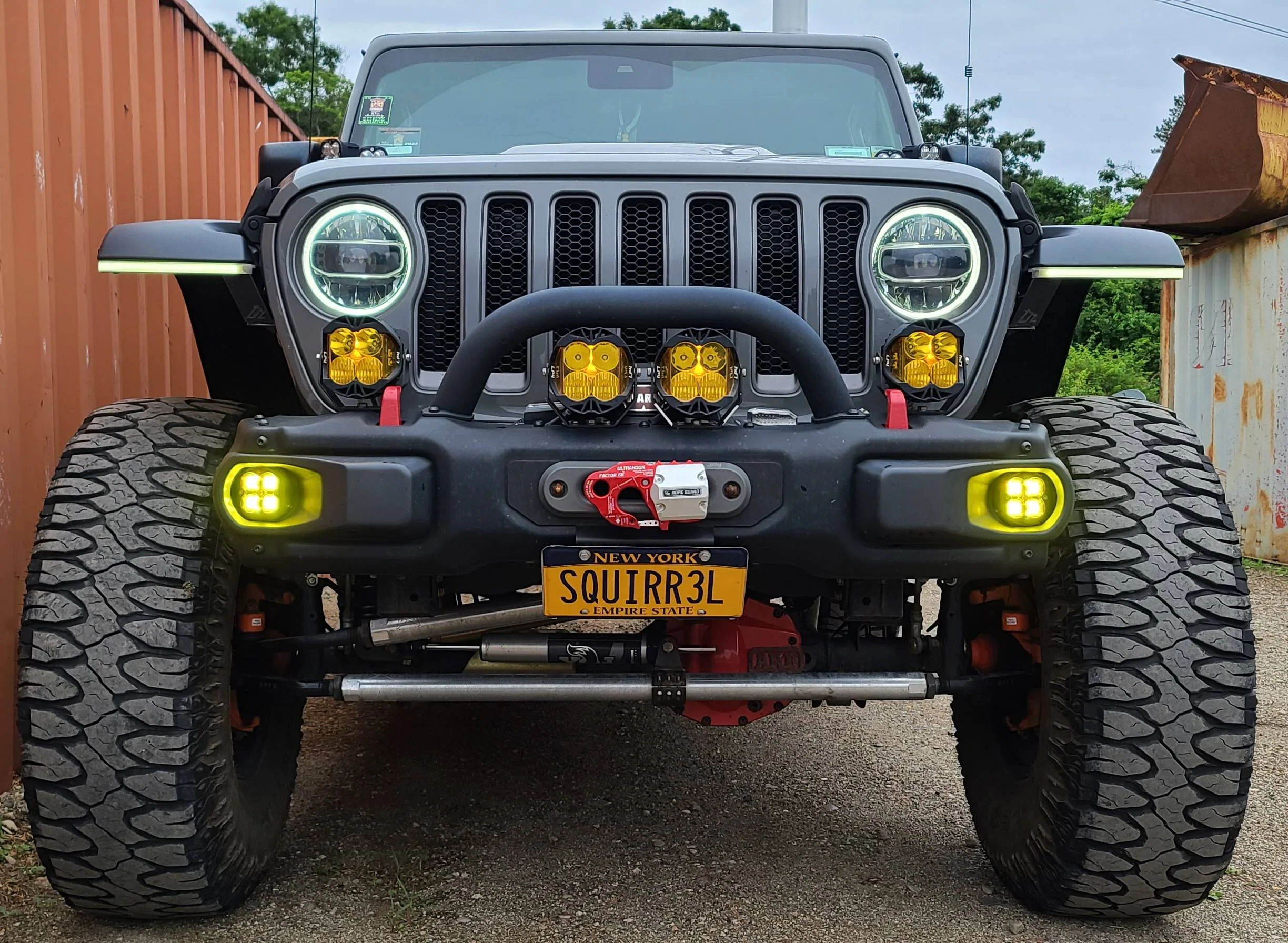

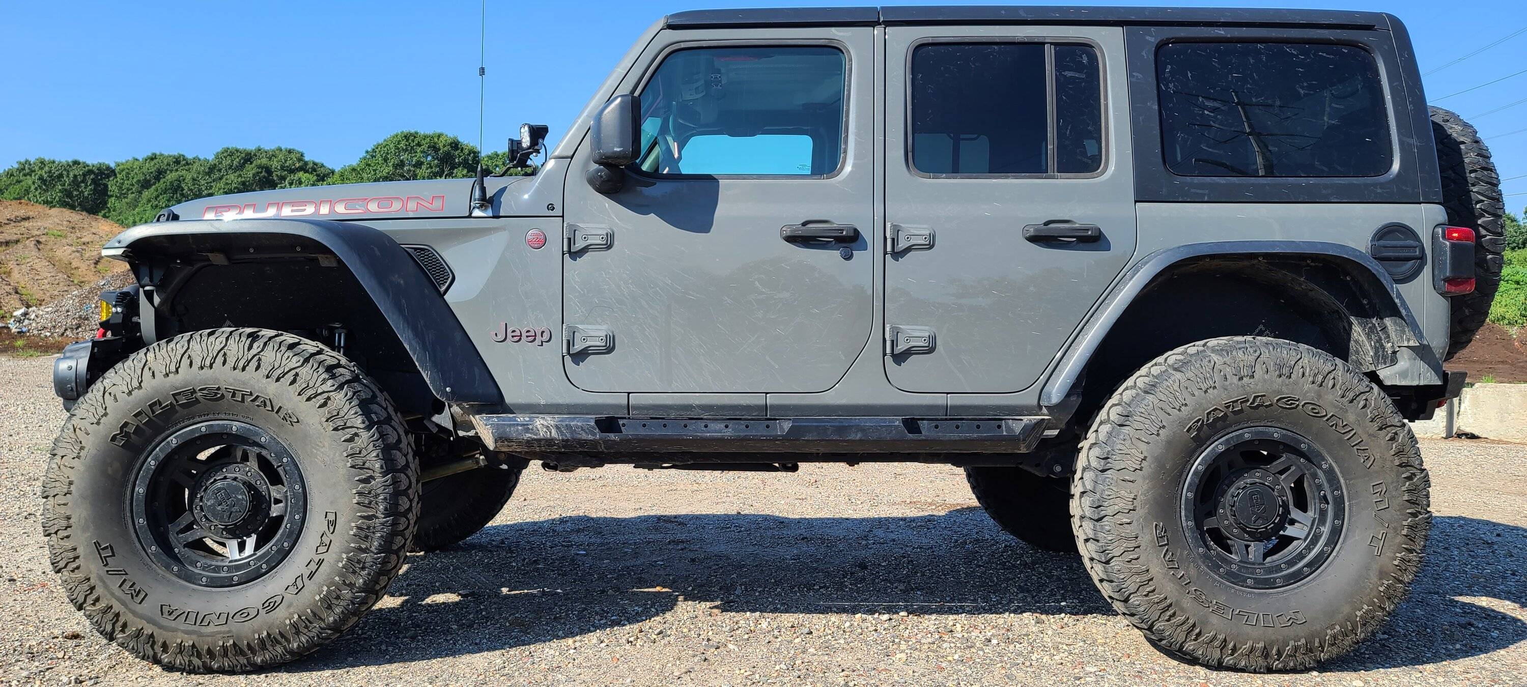

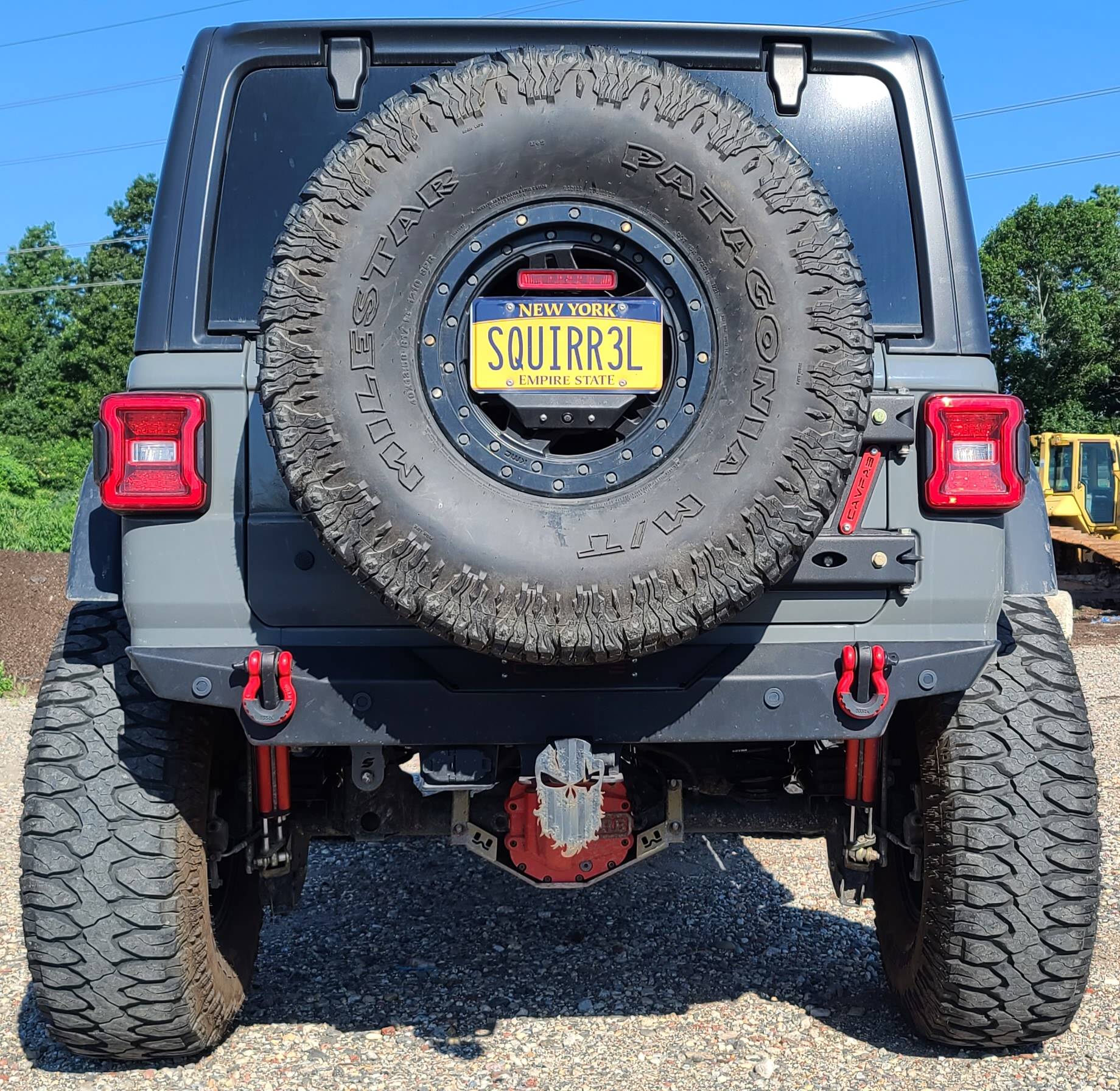

My 19 JLUR has the 4.5" Metalcloak Gamechanger and 40x13.5 Milestar Patagonias. It sits about 81-81.5" tall at the highest point of the hardtop.
Jeep Wrangler JL Looking for an approximate height 20220806_091606
Jeep Wrangler JL Looking for an approximate height 20230622_065704_resized
Jeep Wrangler JL Looking for an approximate height 20220806_091830_resized
Different brands of lifts will net different actual height increases, because some are designed to support more weight before sagging below the advertised height. My previous 3.5" Metalcloak springs netted about 4.5", and the Jeep sat pretty damn level. Their 4.5" springs netted 5.5" up front and 6" out back, giving a slight rake.

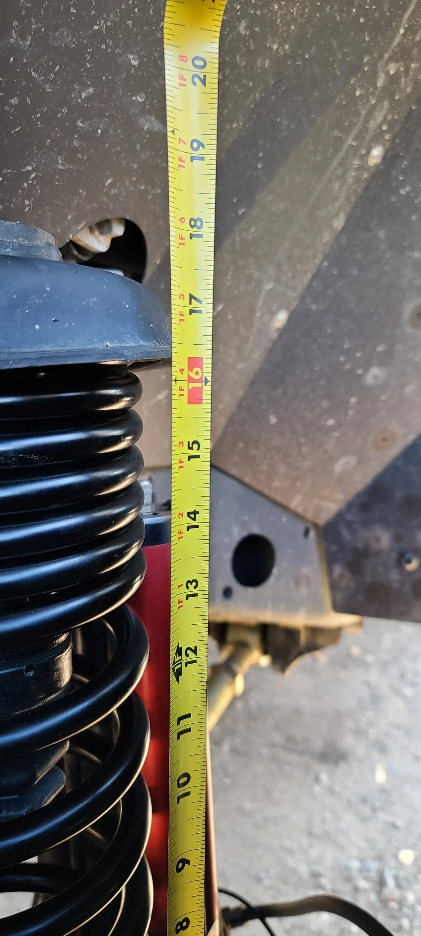

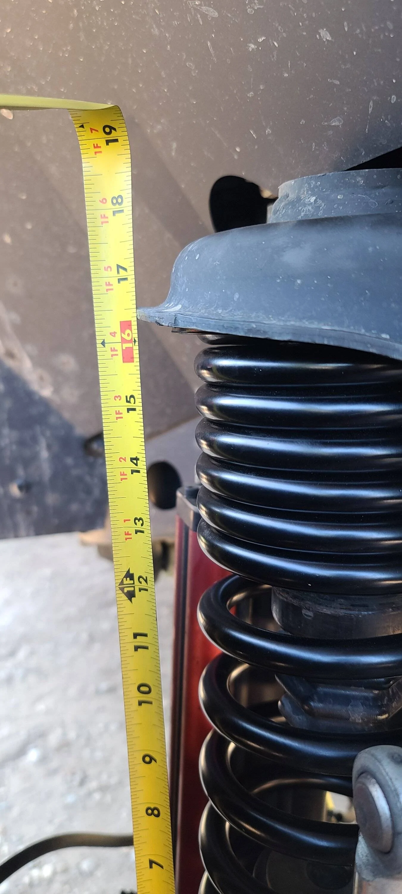

Here's some measurements of the front 4.5" springs, taken from the top of the axle tube to the outer lip of the upper spring bucket. It's the most accurate way of gaging actual ride height increase before and after a lift is installed. Jeep is on level ground.
Jeep Wrangler JL Looking for an approximate height 20220806_090732
Jeep Wrangler JL Looking for an approximate height 20220806_090850
