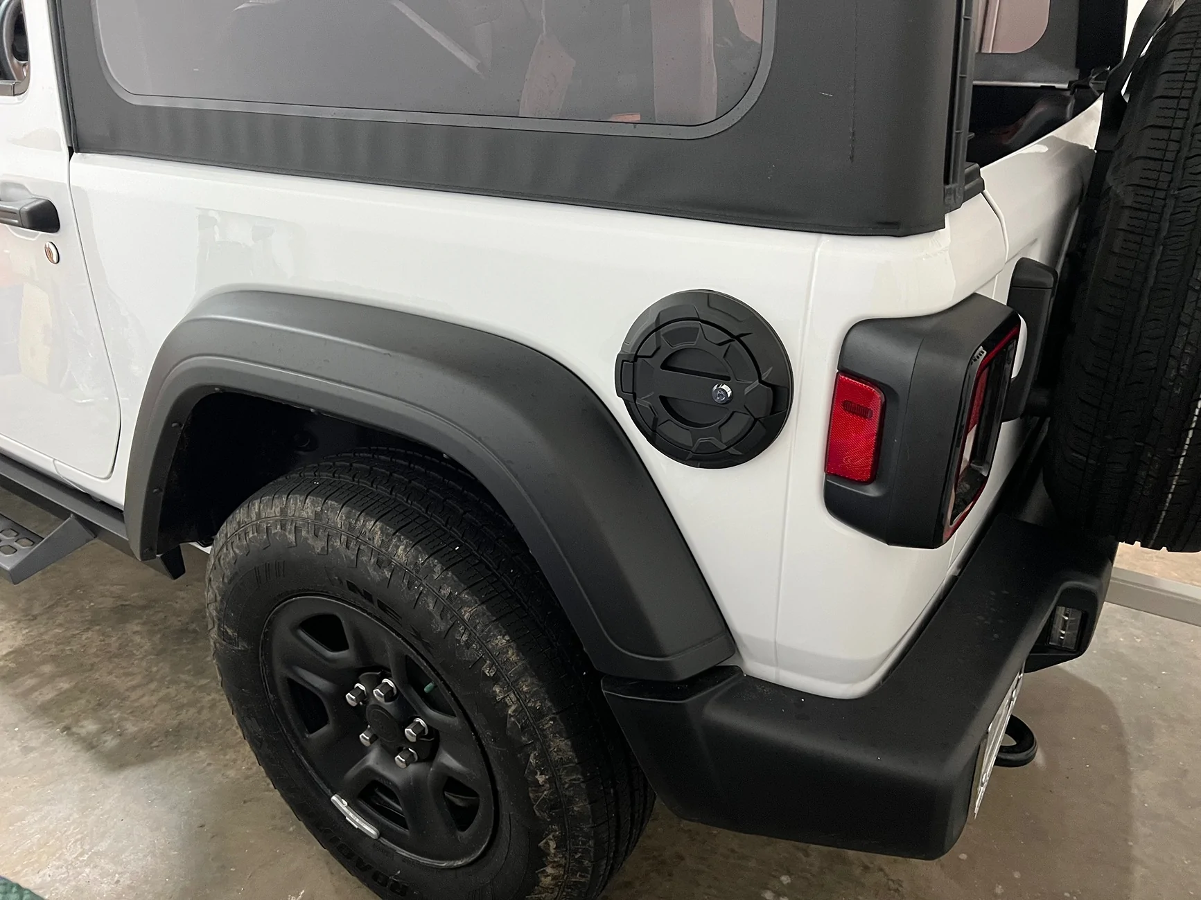

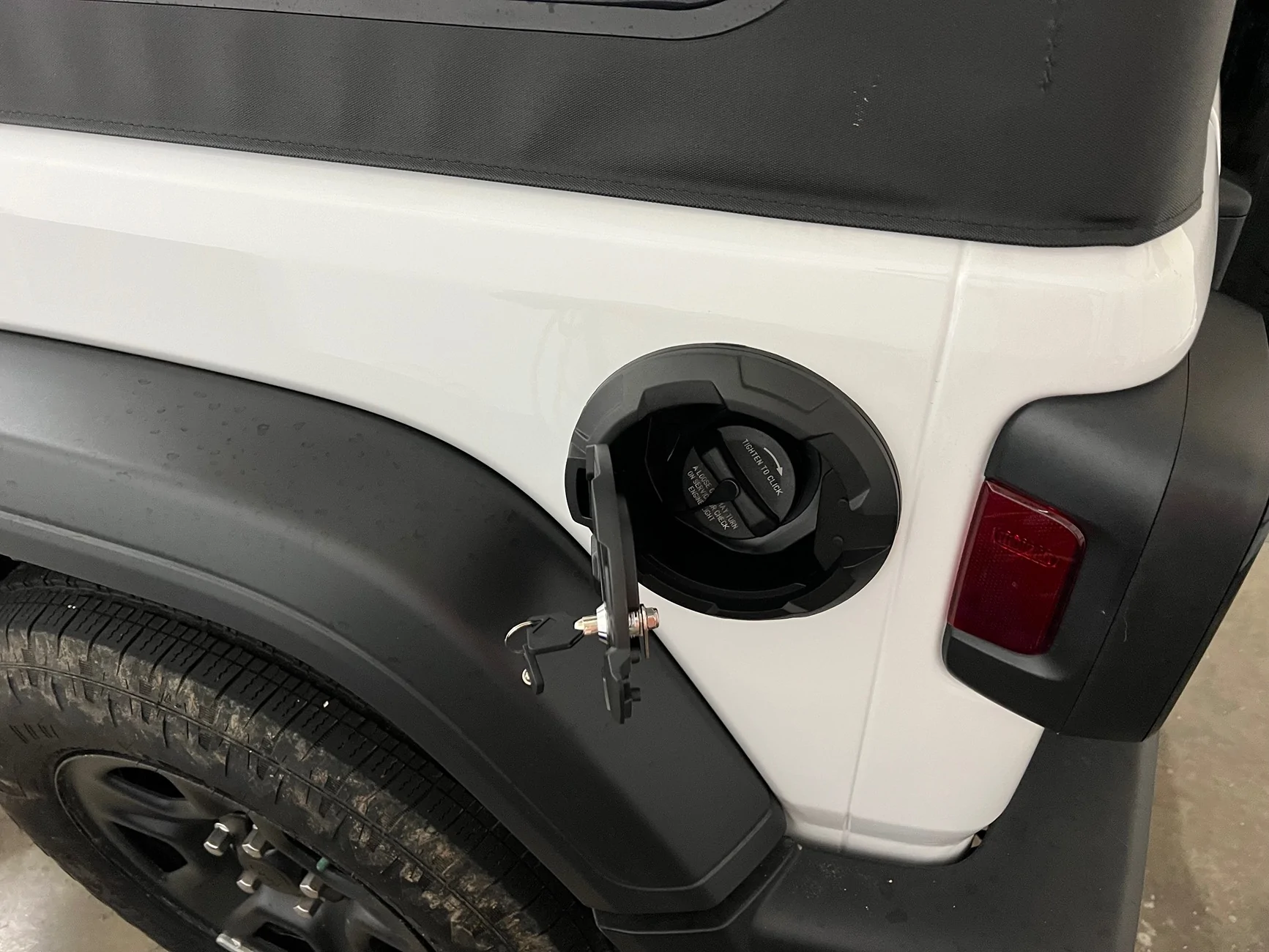

Next up on my list was a locking fuel door. This took about 10 mns and was way easier than I anticipated. Basically, remove the rear tail light, then pushed out the housing which is held in by a couple tabs. Lastly, just reverse the process and push in the locking replacement. Easy!! Here’s the one I used… https://a.co/d/57LVlCo
