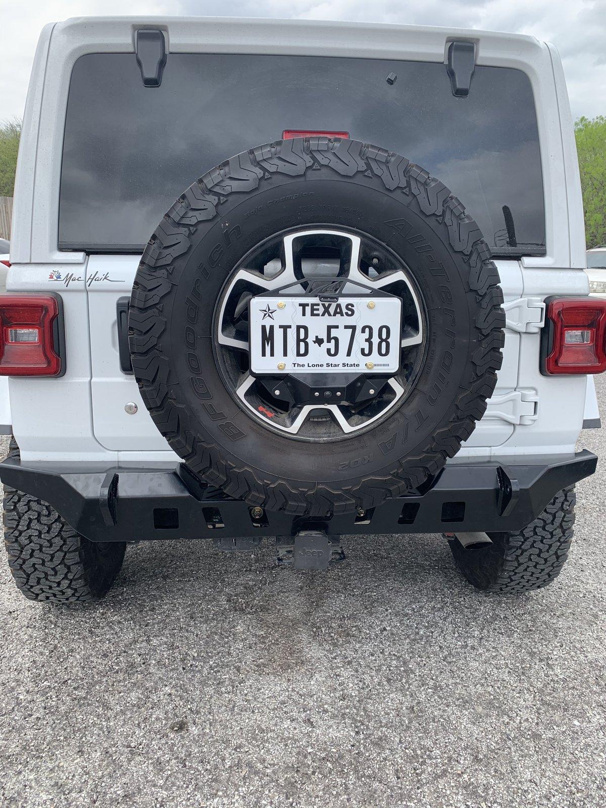

Using motobilts relocation kit.
How was the install? Does moving the camera location matter at all? How is the fit with a factory wheel? Thanks!
also, I don’t mind some branding but any reason the logo needs to be on the top or can that whole part be zipped off?
Smart_Hulk
Oct 7, 2019
2020 JLUR
The install isn't bad. Most troublesome part is cutting off the plastic housing for camera to maintain the factory tire carrier with the new license plate bracket. The camera location doesn't really matter. I can't tell a difference to be honest. This bracket is adjustable so with wider wheels or factory it will work fine. Also, the metal isn't that thick where the logo is so you could easily chop it if need be but Motobilts overall branding on any of their products is pretty subtle so that's why I went with them for all my bumpers and this relocate bracket.

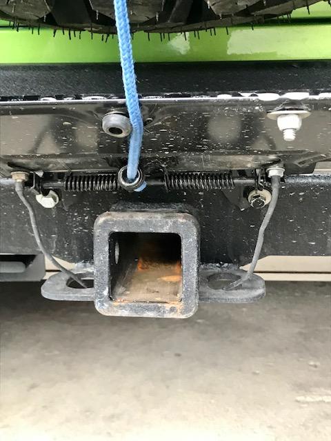

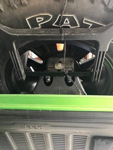

I made my own using a rear plate mount for a YJ, the spring-hinged one that covers the fuel tank filler. I mounted it upside down covering the receiver. If it gets caught on something off road, it will just flip up out of the way and spring back down. (The bungee cord is holding it up so you can see the bracket). I also fabricated a simple bracket that allows me to use the original third brake light. Total cost was about $24.

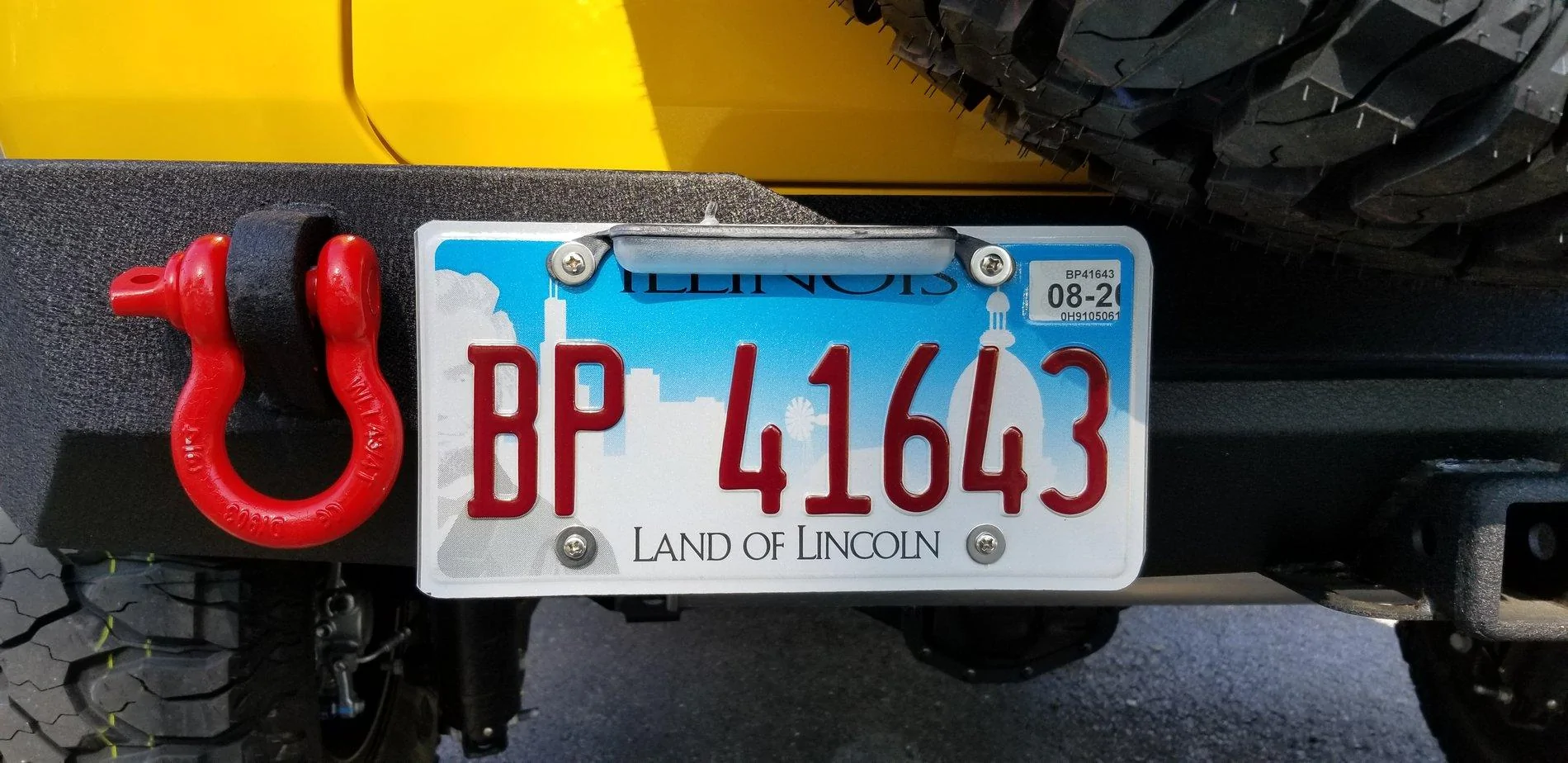

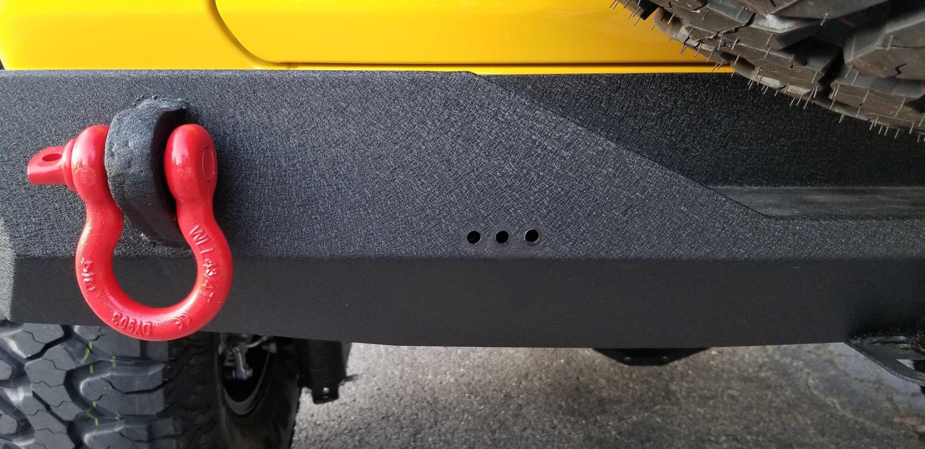

I'm not a fan of relocating the plate to the spare. I bought the Aries relocation bracket which is for a front bull bar bumper. I was able to use it on my rear bumper with a light I bought off ebay.
I drilled three holes in the bumper. I used the two outside holes to mount. I ran the wire for the light through the center hole. I used the wiring harness from the stock bumper so I could just plug in without hard wiring.
Can you post a picture from a bit further back?
