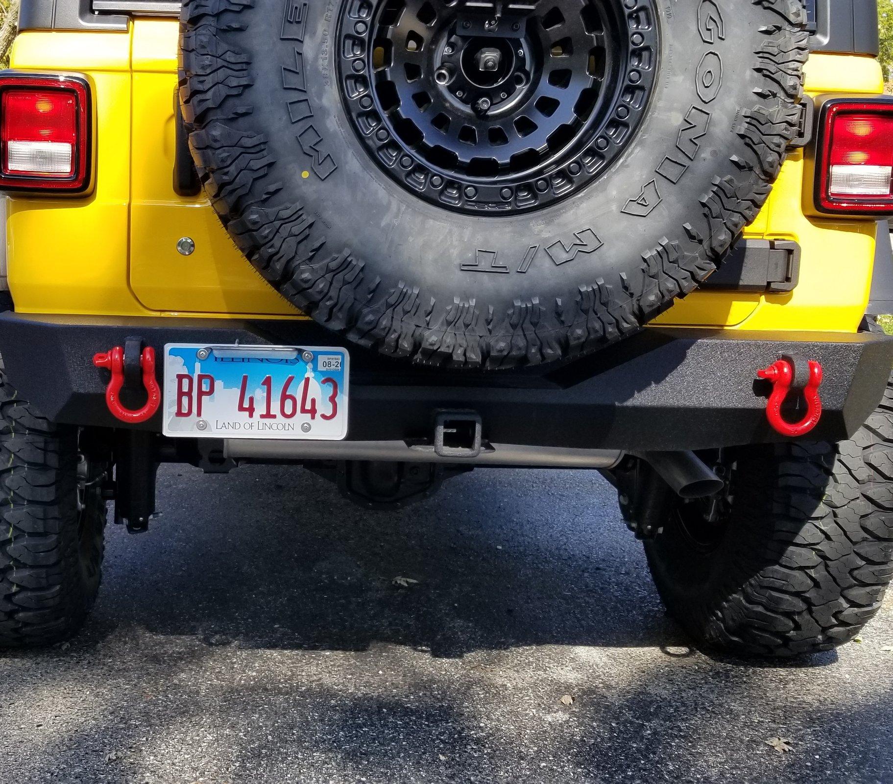

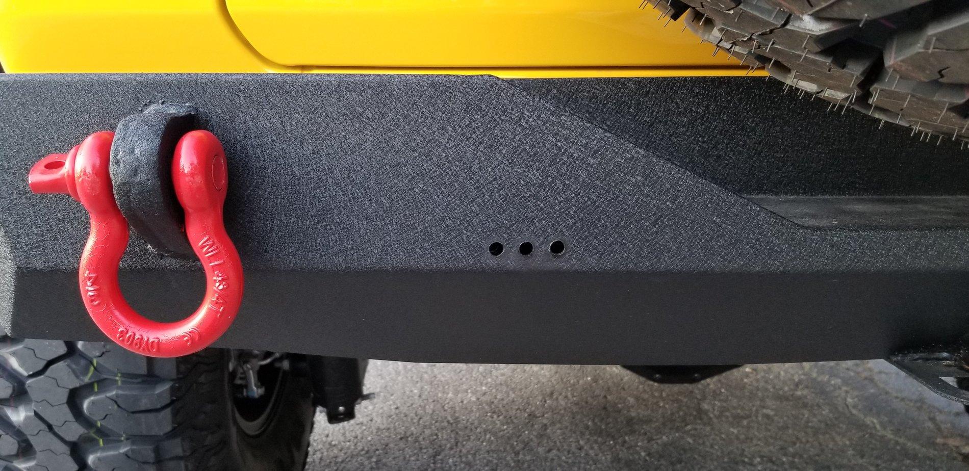

We put LoD's bumper with tire carrier on mine last weekend. The license plate was the simpler part when you get the little "bolt lights". They splice into the existing wiring and work pretty well. The back-up camera was more intense to re-locate onto a swing-out but works well. You get a really long patch cable in that kit to make it work.

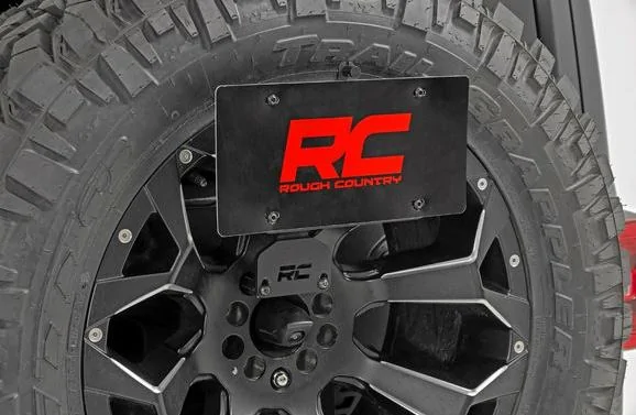

I researched this as well....I have a Teraflex alpha carrier with rear brake light above camera. I didnt like the plate mounted above the bumper on driver side because it sticks out about 3" past the body to allow clearance for opening the tailgate and could easily get ripped off wheelin. I ended up drilling 2 holes in a RC plate mount to lower it a few inches just above rear brake light. It comes with a LED plate light that you splice into a tailight and doesn't block the camera while allowing use of a nice looking center brake light. Seems to check the boxes..

I like the look...but it's begging to catch on a tree/rock if you ever wheel in tighter spots.

Gave that some thought, but it doesn't stick out any farther than the fender flare. So will definitely try to avoid spots that tight!
