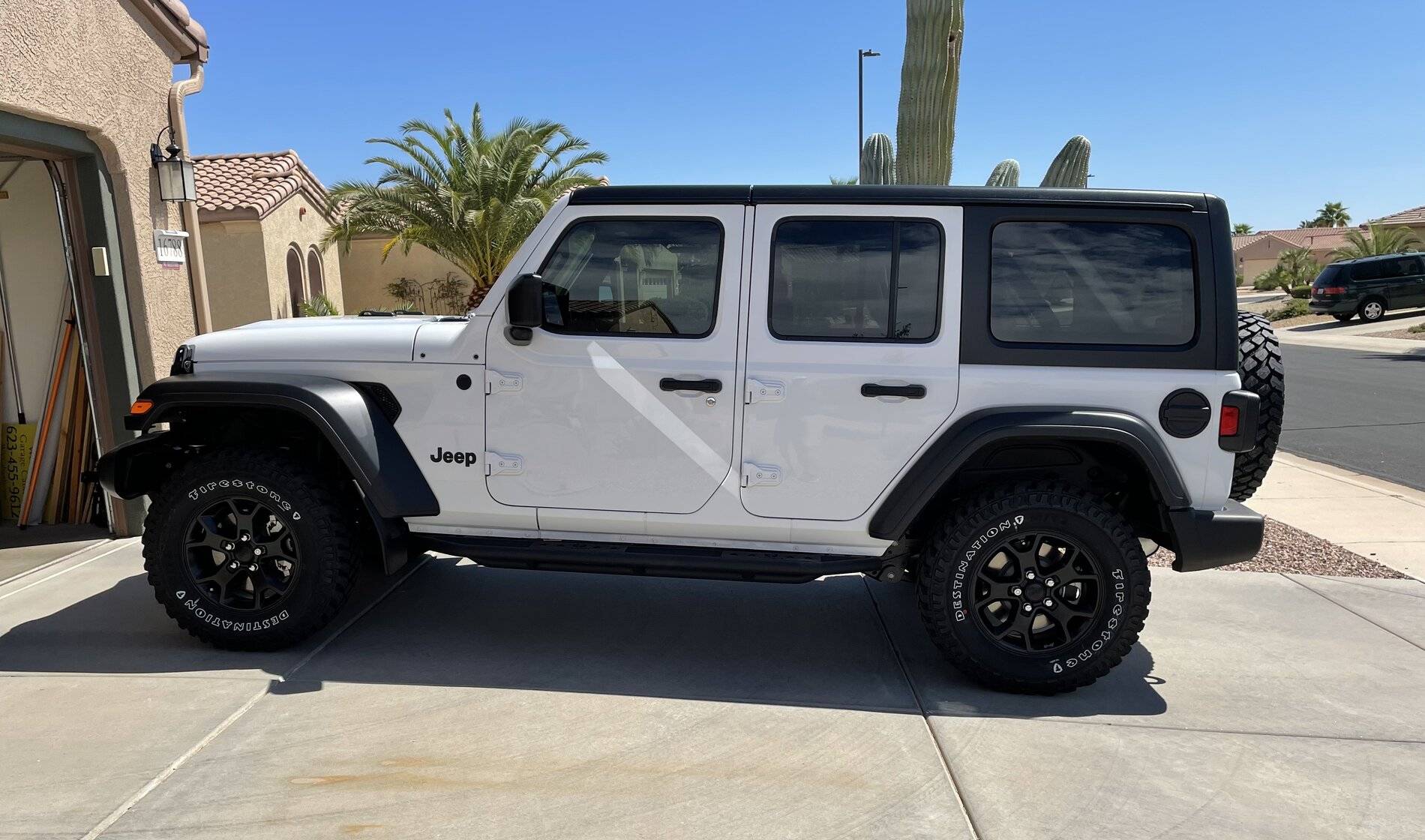

Hi all,
May be overthinking it....have a '21 JLU Willys that is a half inch lower on the front. Was going to put in the teraflax .5 coil over spacers in the front to level it out, for now. May do more of an official lift when it comes time to look at new tires.
Is there any issue with this? Can't seem to find anyone who has just put the small spacers in the front to fix factory rake, as opposed to leveling out some sort of suspension lift.
I had a RocKrawler leveling kit installed. 2” in front and 1.5 in rear. It’s now level and rides like stock. 2021 Willy’s.
