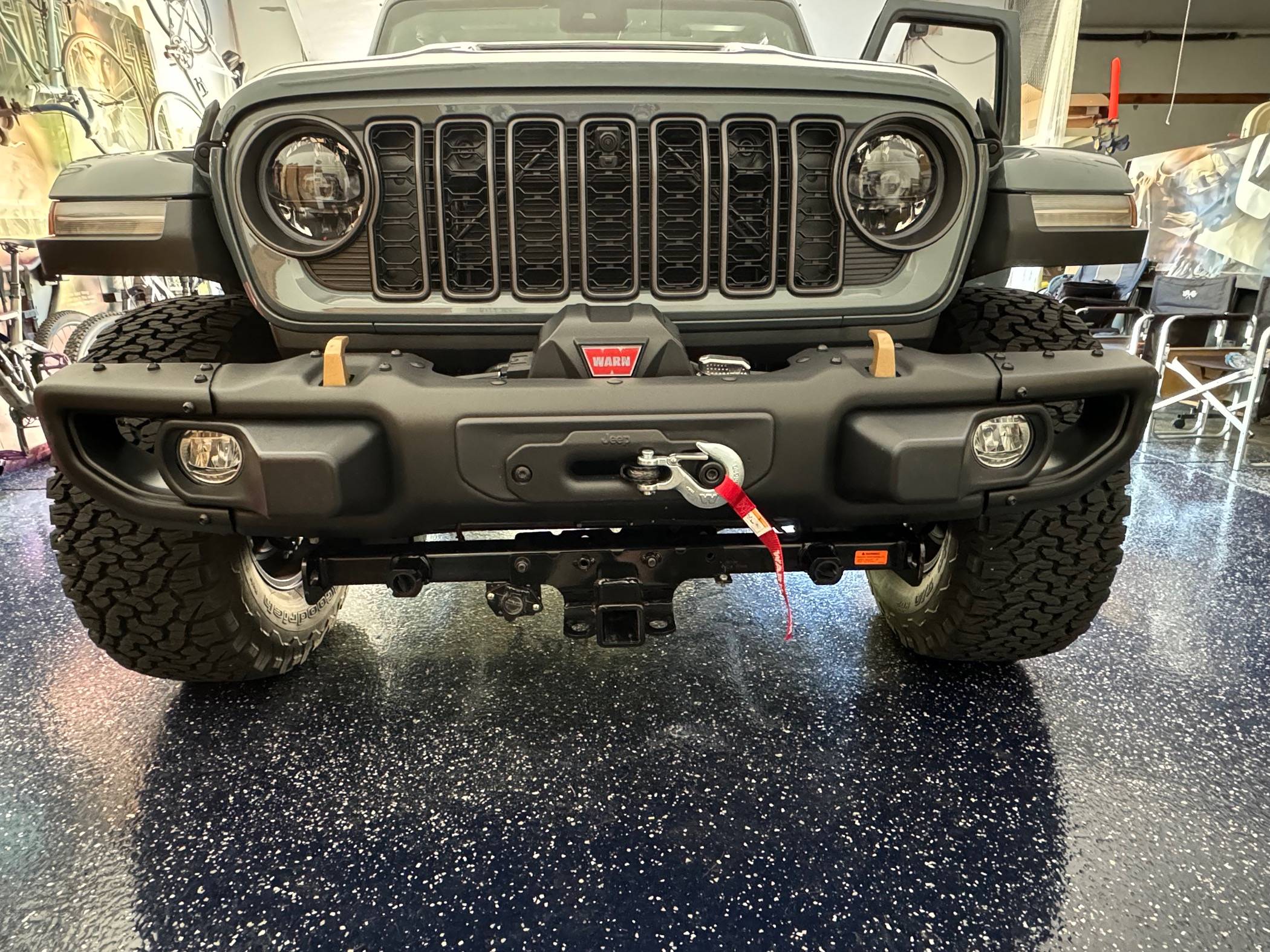

I put a 2” receiver on my blue ox tow base plat e for the front. Indispensable for precisely moving my commercial wood chipper.

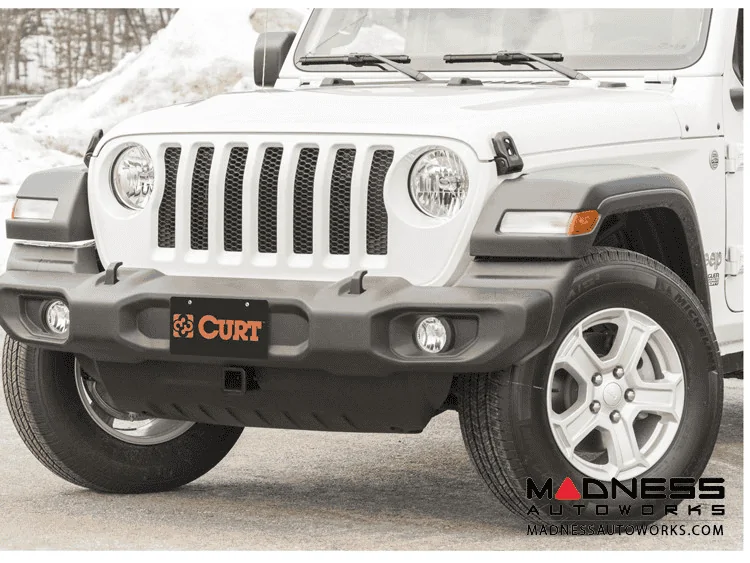

Curt (or DrawTite) - for Wrangler or Gladiator.
Handy for maneuvering long trailers into tight parking spots, you can see where you are putting that trailer when you have almost no room to turn it around.
Jeep Wrangler JL Let's see those front Hitch set ups. 1716389731765-29
They don't hang down that low and you can trim the skid plate to fit around the receiver.

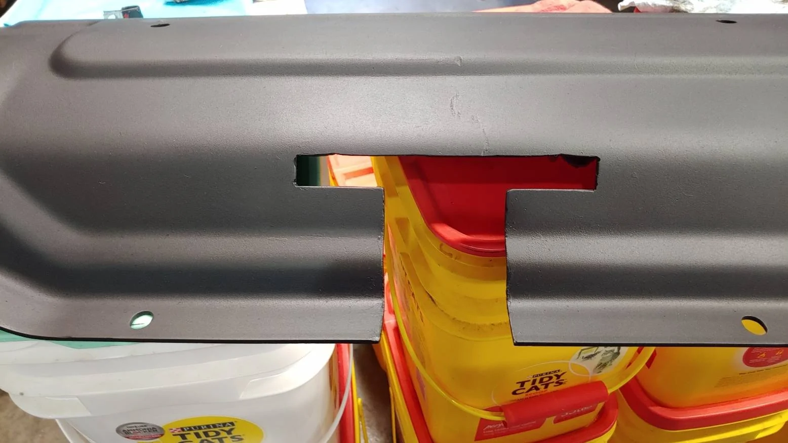

Lets talk about this "trim" the skid plate. Do you have pictures and how much "trimming" are we talking about? Is it absolutely necessary?

While i liked the curt, it wouldn’t work with both the factory winch and the blue ox base plate.
so I ordered this:
https://www.amazon.com/gp/product/B07MGPZ4LR/ref=ppx_yo_dt_b_asin_title_o02_s00?ie=UTF8&psc=1
and shimmed it out to fit on the base plate front bar. I only used 2 of the 4 1/2” bolts it came with as I’m just putting around my lot. Plenty strong.
sort of mickey mouse, but very useful, plenty strong.
Blue ox themselves was very uninterested in providing or helping with this.

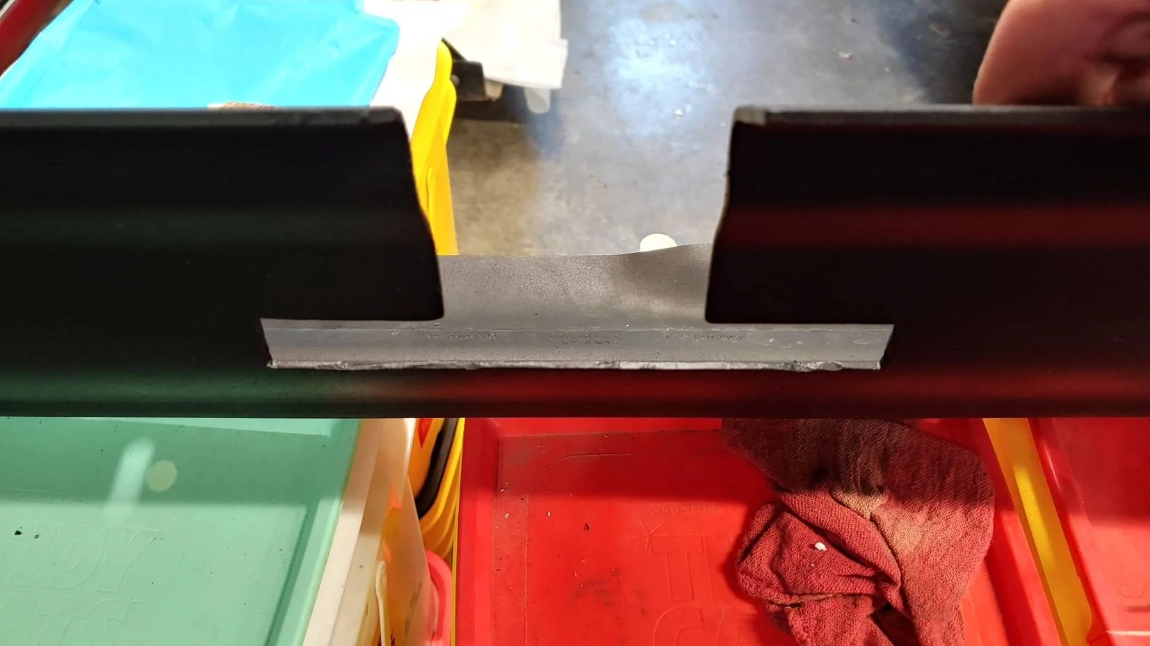

I had a DrawTite receiver but it didn't play well with the winch plate I originally had, so switched to a Curt receiver. It's still a bit fun to make the Bulldog winch plate work with it, but I got it done.
I cut out the skid plate to go around the Curt - then had to pull the skid plate off after I bought the snow plow because the brackets for the plow mounting bar require removal or trimming of the left and right ends off the skid plate.
This setup is actually on my JT but it's the exact same parts - same frame front, same bumper, same skid plate and so on.
I'd rather plow with my wife's JLU but she'd kick me out of the house and hide the fobs to her Jeep if I even threatened to install all of the wiring and brackets on her baby. "not on MY Jeep" is what I hear.
The plastic air dam on the Sahara (or Overland of the Gladiator with the plastic bumper) is easier to trim.
I used a Dremel with a cutting wheel to do the cutting. It's a little rough, but then few people get down there to critique it.
The slot area has to be a bit wide because of the angle of the skid plat as it's installed.
