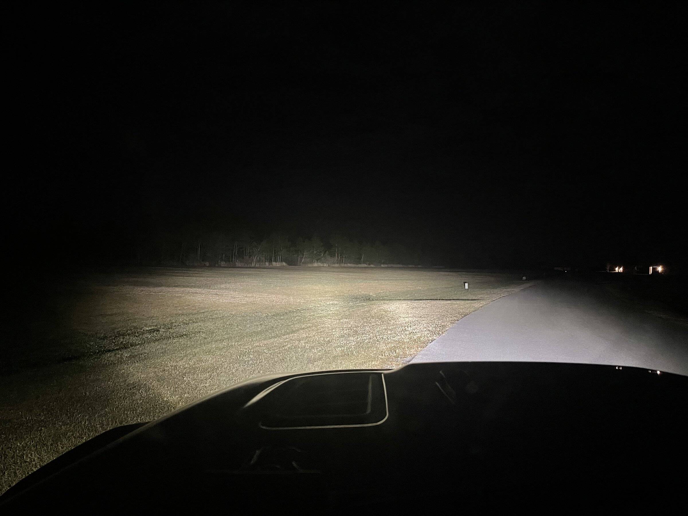

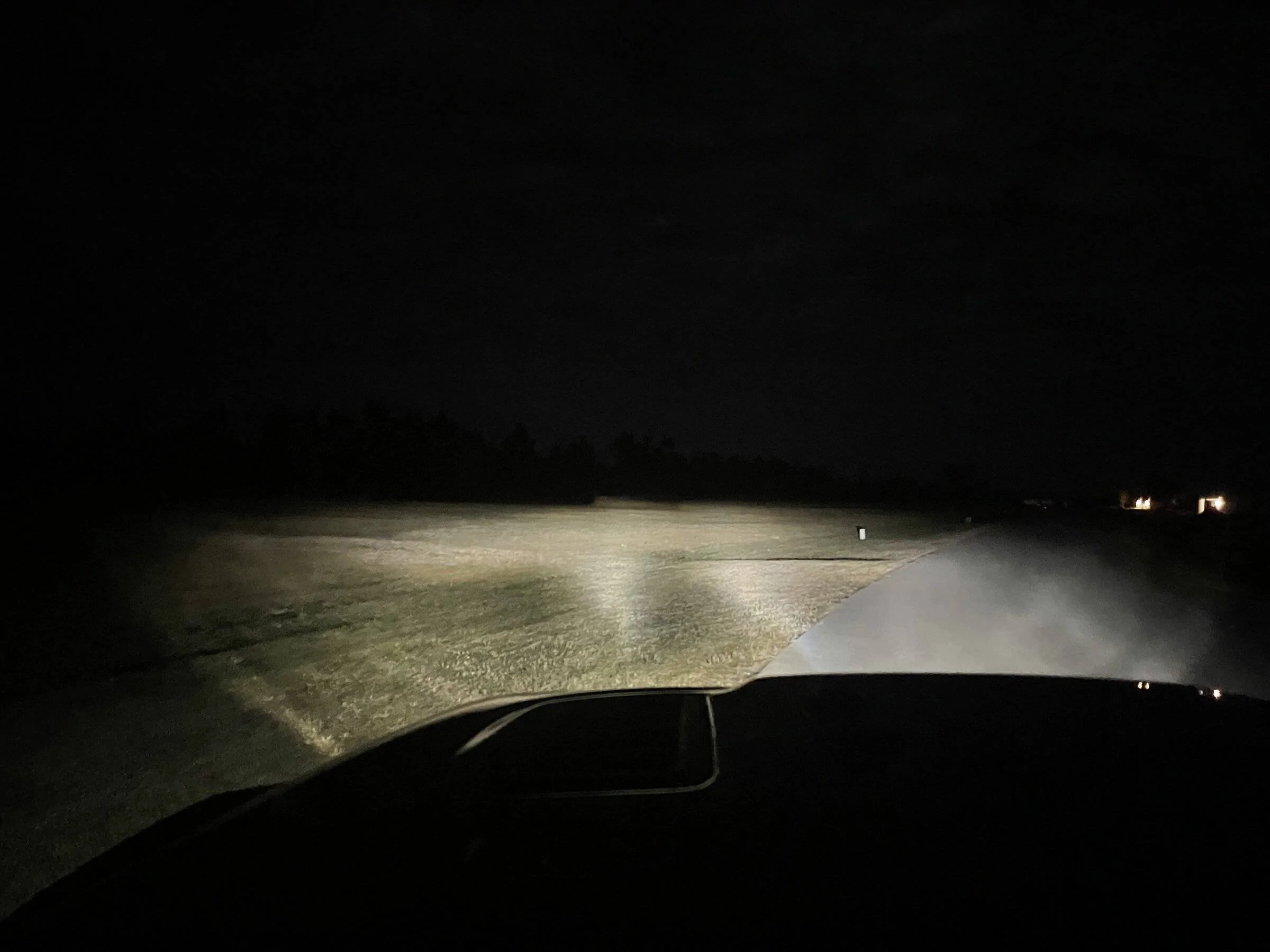

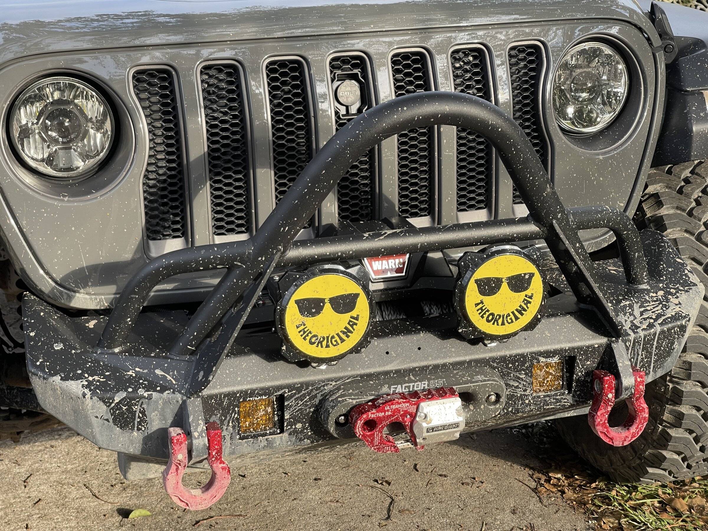

I don’t see why they wouldn’t fit. But you will most likely have to program from halogen to LED with something like a Tazer. You could go with a plug and play option like my Gravity headlights by @KC HiLiTES
Jeep Wrangler JL LED Lights 8D6ADB92-5776-4E0E-996C-38E6C49F0401
Jeep Wrangler JL LED Lights FC878D71-B62F-4B48-9E0D-4C59AF7BE5B7
Jeep Wrangler JL LED Lights 7DD850D6-6CC7-4478-ABEC-D2F55E2E2327
KC Gravity headlights low beam
Jeep Wrangler JL LED Lights AF938E3E-3518-4856-BA79-05C12F61D310
KC Gravity headlights high beam
Super easy to install.
