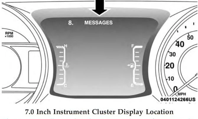

For me the dream has become a 7.0 inch reality you will find on the modern cars and modern and sophisticated
