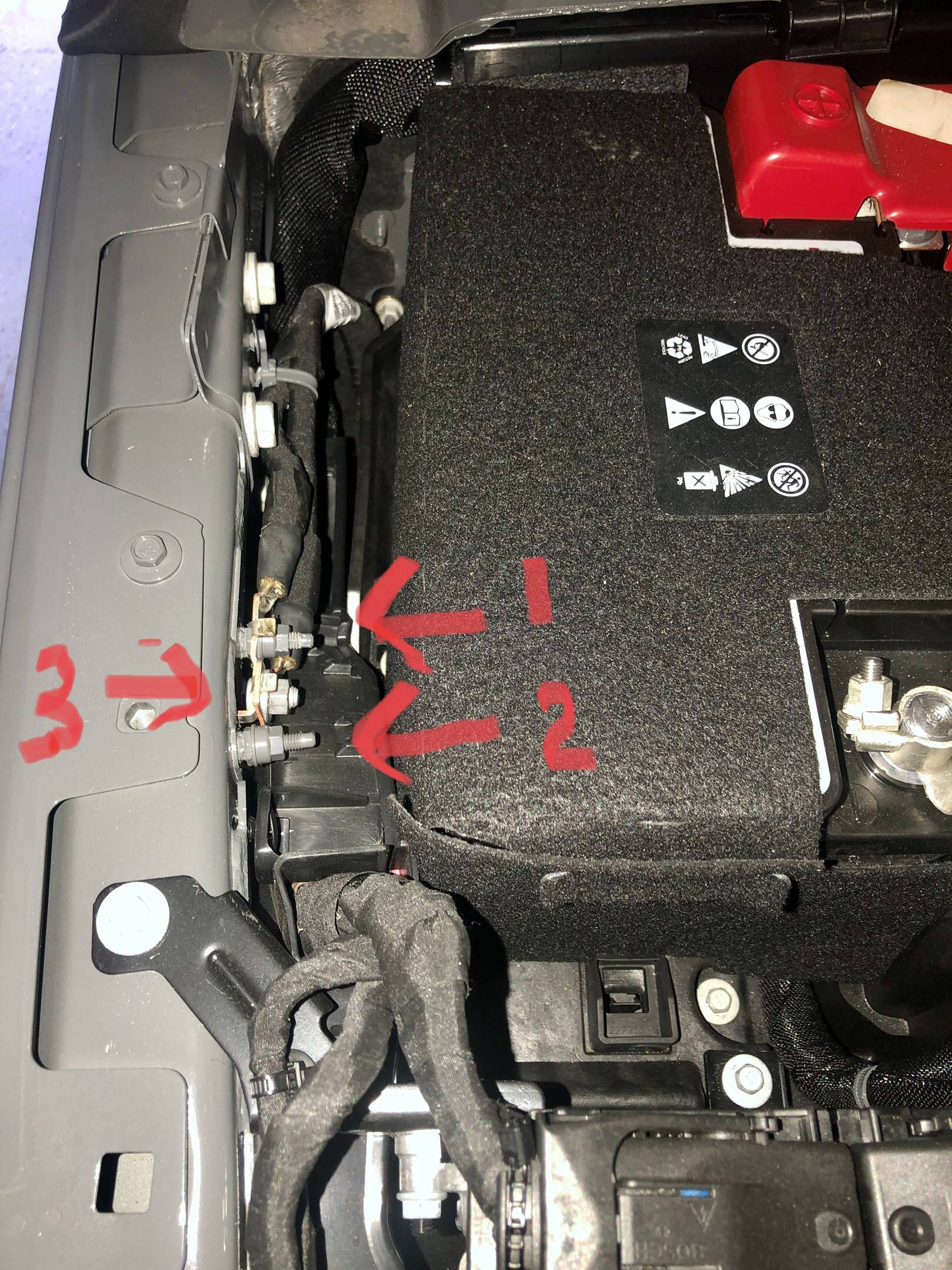

Hello forum members, will be installing KC C3 LED light pods this weekend. Question on wiring them up. Should I hook negative (ground) wire up to negative battery post or to one of the following in attached photo? Any benefit or complication with either? Thanks.

I used one of those studs you pointed to and works great for grounding!

Ok, thanks. Any particular one, or doesn't matter?

Use the fender stud. Keeps the battery clean and clear, no performance difference and that’s what the studs there are intended for.

I use the center one the two outside ones are painted, not quite as obvious in your photo, but mine is purple
It doesn’t matter. The painted ones aren’t painted where it matters (at the connection point).
