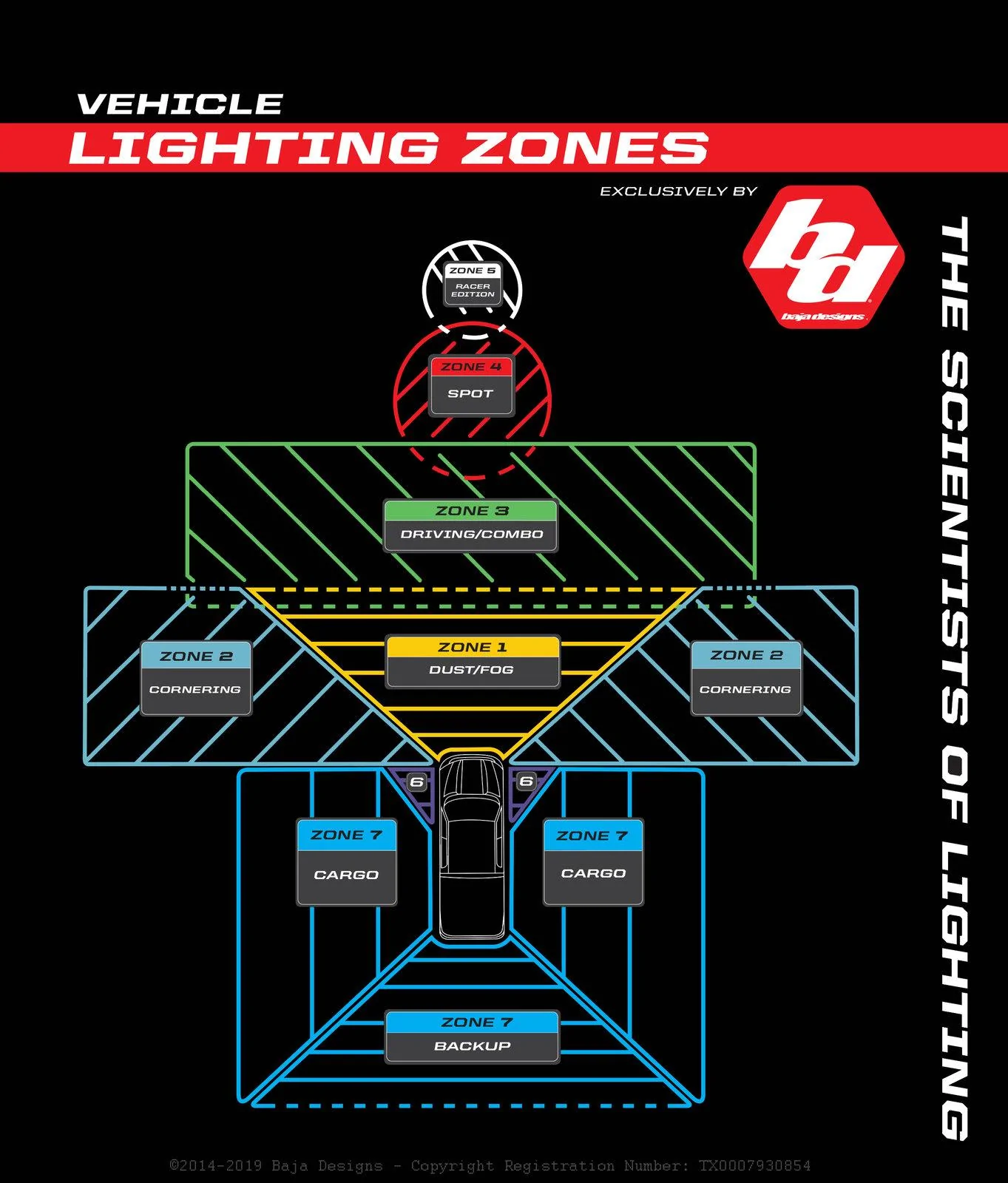

The @Baja Designs image below does a GREAT job of explaining how different lights work together. You can't go wrong with either of your choices. I'm a bit biased towards your Baja Designs option, as I've replaced my stock LED fogs with the Fog Pocket Squadron Pro's and they're extremely bright/helpful, but not DOT approved for road use. The ones you're looking appear to be DOT approved.
I didn't find that the stock LED fogs did too much, which is why I replaced them. It kept my future options open for filling a missing area of need (see chart below) and didn't require extra wiring, or a precious AUX switch spot.

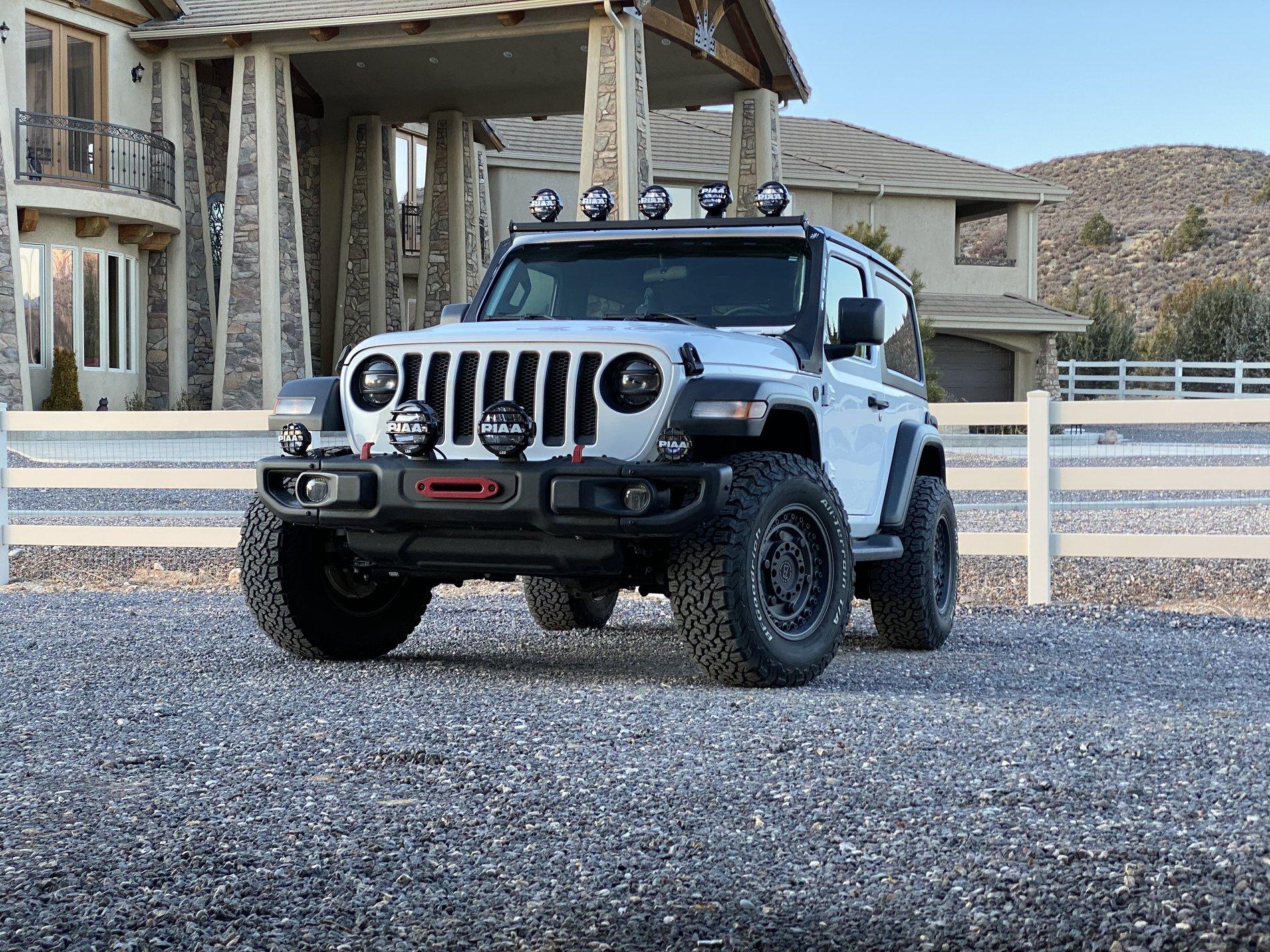

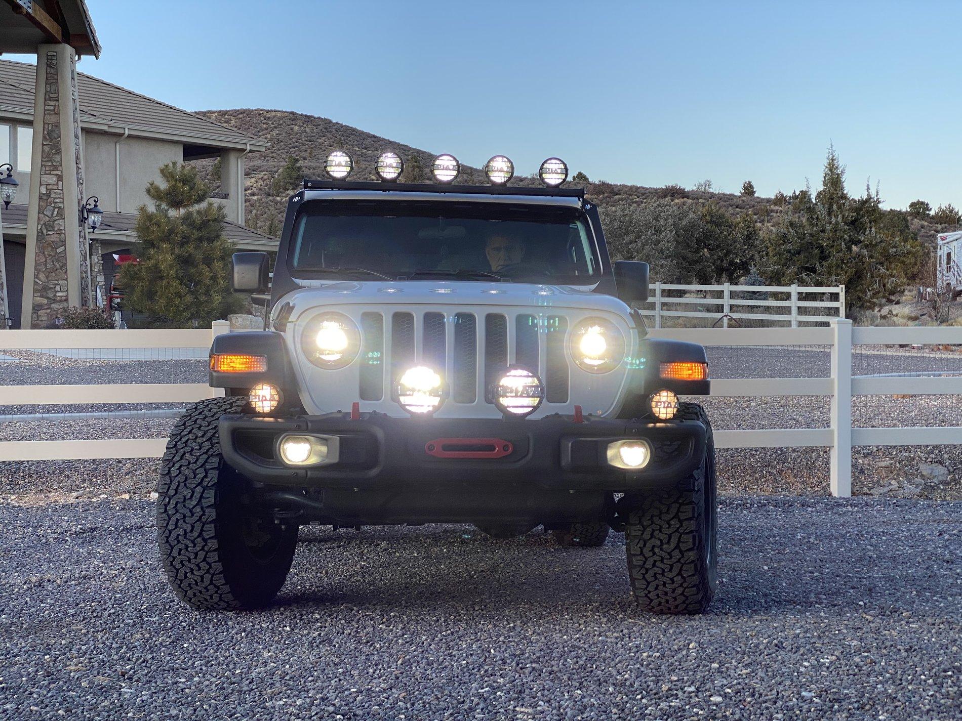

I have a couple of PIAA 570s ganged with the Co’s - reaches out another 0’ without bothering on coming traffoic

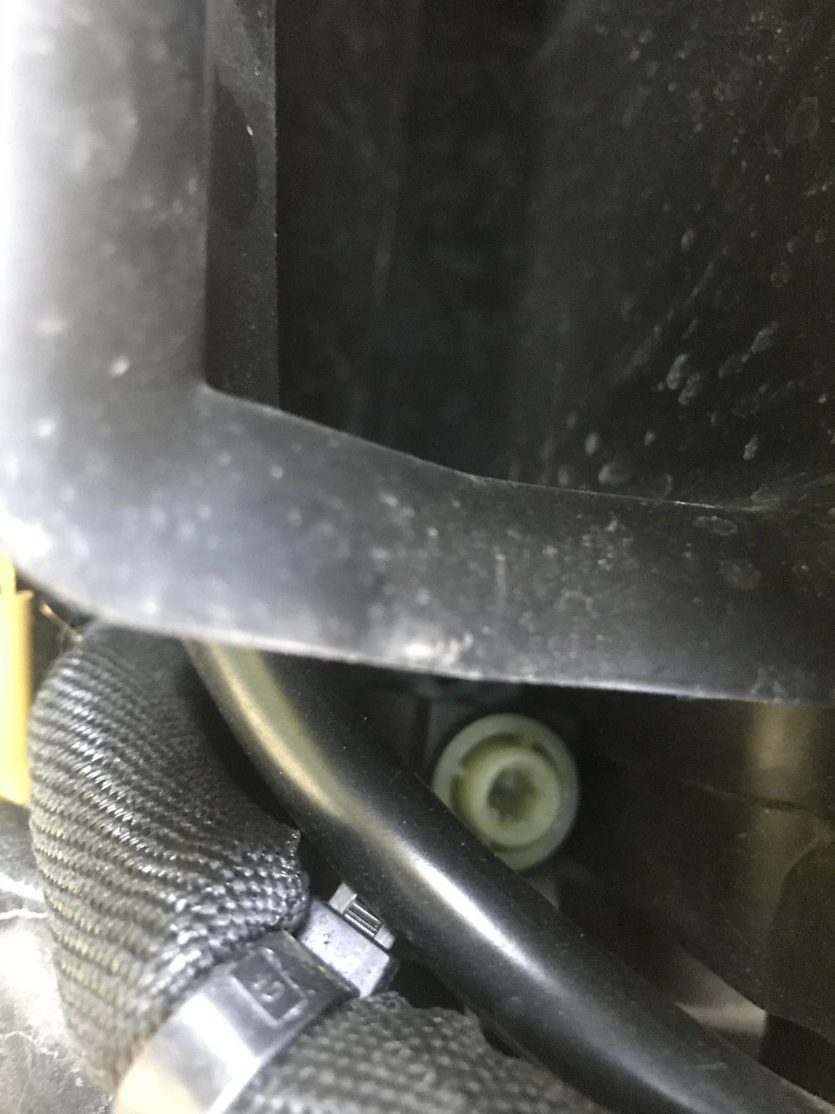

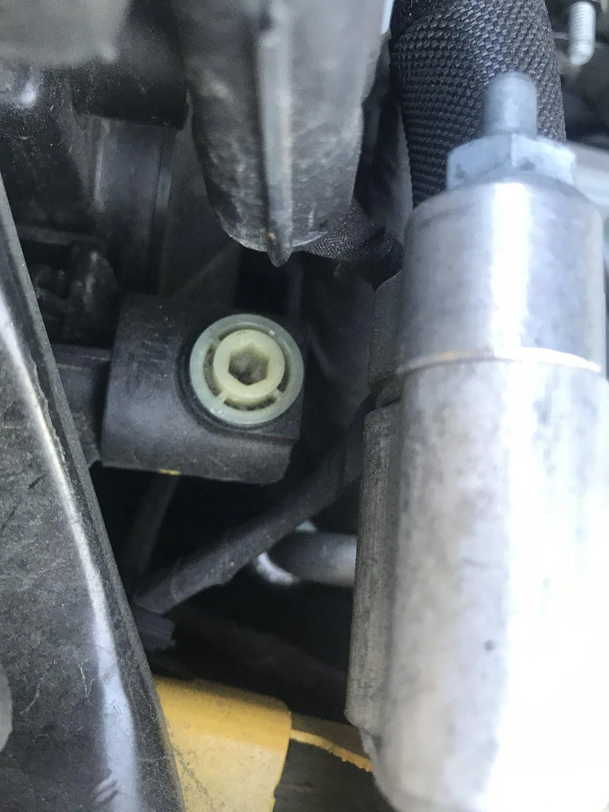

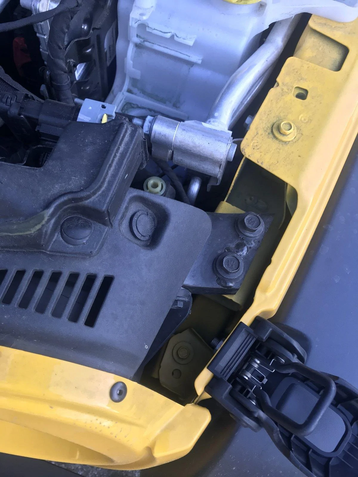

The headlights are easy to adjust, there is a white plastic adjuster for each that a Allen key or torx can be used to turn. Clockwise is down.
The first 2 pics are the left side, the bottom pic is the right (in front of the air box opening).

Hey @Jeepjunkie , thanks a million for posting that up! Now I don't have to research anything. You're da man! :handsinair:

Thanks Eric...ya I already did adjust them...just was thinking I shouldn't have had to,..but sounds like Im not the only one who did...
