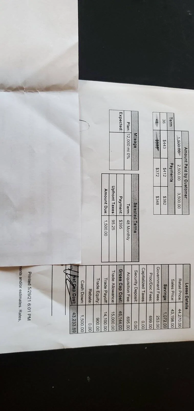

Heres what they gave her
Jeep Wrangler JL Lease assistance 16224104429797448195458421379415

Net cap cost seems off. It should be a $2400 reduction from the gross cap cost if I’m reading that right. Downpayment of $1500 cash plus $900 in trade-in equity.
In this deal, the $900 net trade and 1500 downpayment are almost paying the fees of the lease. It is short about $35. I would guess the reason why the Net cap cost does seem to add up, is that it includes sales tax on the taxable fees for your state.
