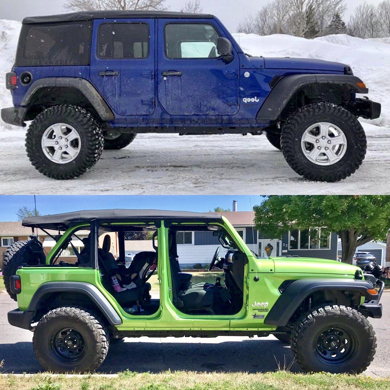

Shortening the uppers with stock length lowers also give it an over bite look. My buddy like his MC kit but hates the look of the axle rolled back and will go to RKs length specs once he gets adjustable lowers
He’s running Metal Cloaks 3.5 Rock sport (blue JL) and I’m running RK’s 2.5 adventure series 2 so I also have the rear uppers but I measured Center to center and I’m almost 2” longer wheel base

goal should be to add longer LCA's to center the axles within the wheel wells (i.e. to get back to factory wheelbase specs). Once that is done, then you adjust the UCA's to correct the caster / pinion angle. pretty simple, and any good off road shop can handle the job

Now that really gives meaning to RK's earlier comment, "The idea should be to protect the wheelbase of the vehicle..." A two inch wheelbase difference is pretty significant. This pretty much validates my idea of installing new adjustable lowers and adjustable uppers at the same time. It seems the lowers are best used set the axle location to center the wheels in the well. And then use the uppers to dial in the caster. I can see how fine tuning is going to be needed since one affects the other. Thanks for the replies!
BTW, I'm digging that ocean blue qeeJ. Is that a special edition or something? :)
