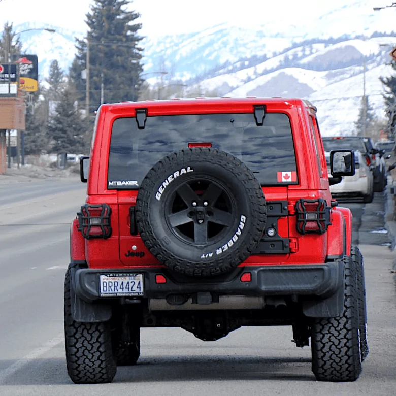

I have a 35x12.5 inch tire on a Quadratec Moab wheel, mounted on my stock Sahara spare carrier. I use a Smittibilt spare carrier relocation bracket to handle the extra tire width and clear the bumper.
It is a tight fit but it fits.

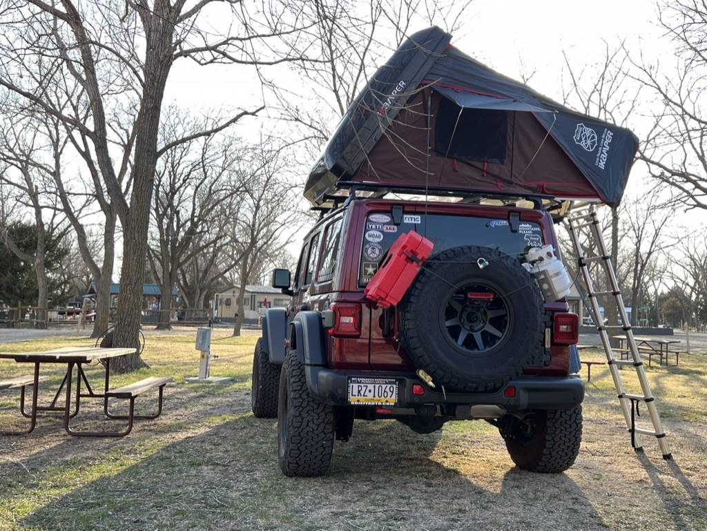

I am running a 35" on her JLURD with the Mopar tailgate reinforcement. That weighs about 85 lbs. I had to add one of these to get the snubber to secure the tire:
https://www.amazon.com/gp/product/B004Y75VWW/ref=ppx_yo_dt_b_search_asin_title?ie=UTF8&psc=1
The tire touches the steel bumper but does not impede the tailgate.
I am running 37's and using one of these:
https://teraflex.com/jl-alpha-hd-ad...ount-kit-w-brake-light-camera-mounts-5x5.html
Mine also came with the Mopar tailgate reinforcement from the factory. I like it better than the stock carrier because it is adjustable for reach and I have that 37" tire tucked in against the factory snubbers. It hangs out less than hers. The closer the tire is to the tailgate, the less force it applies to the tailgate.
