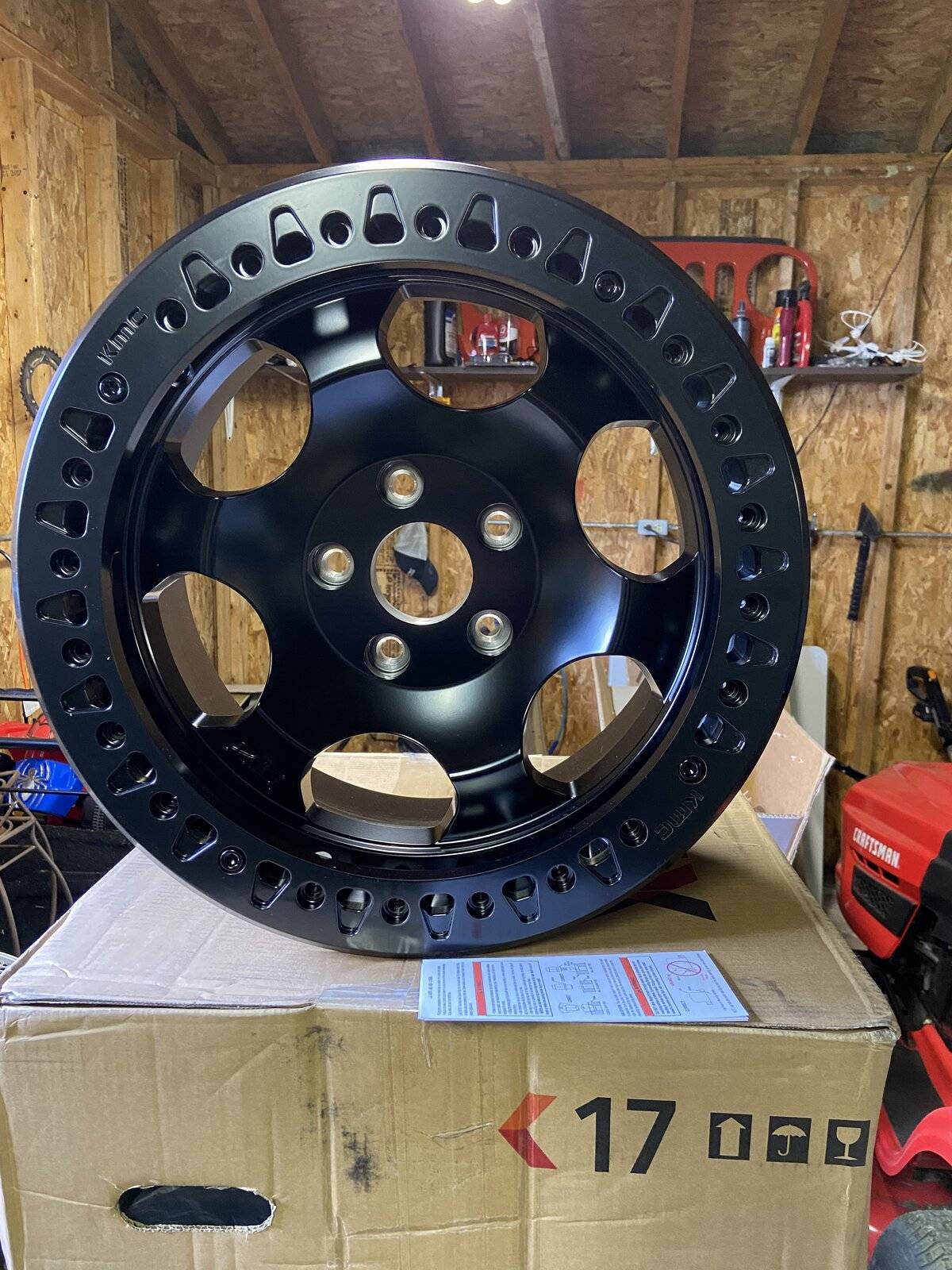

Just received a set of XD231 beadlocks. Just have a few questions
-can I use regular hex head bolts instead of the supplied Allen head bolts for the beadlock ring? I’d much rather have a nice zinc plated hex head bolt.
- how do you guys prevent corrosion on the beadlock bolts/threads without using anti seize? I’ll be driving these year round in the Midwest where we use tons of salt on the roads in winter. I don’t want these things seizing up causing damage when it’s time to change tires.
-center caps, what do you guys have?
-lug nuts, will factory work? Or should a set of gorilla splined nuts work just fine? I’d rather have the acorn style if possible.

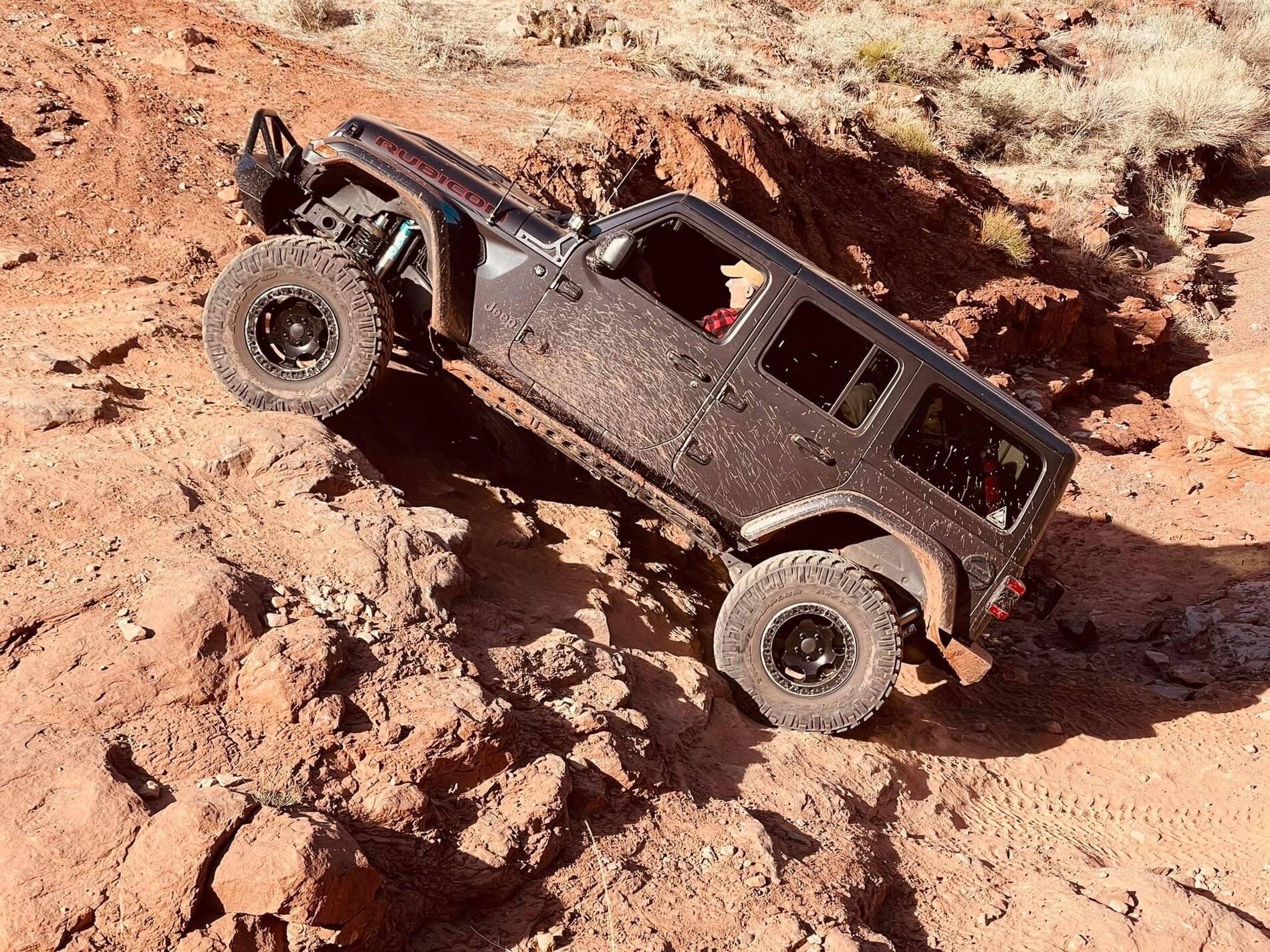

I anti-seized my threads, but the bolt heads have never rusted in a year and a half. I live in Oregon where it rains all the time, I play in the Sand dune‘s, the snow and the rocks. My beadlock rings are scratched all to hell.
I used Omix-ada bumper end caps for the old-man style tube bumpers.
Factory lug nuts won’t work. The gorilla splines should be fine.

I antiseized my threads as well. Also can confirm that the stock lugs will not work. They have a different taper than the KMC wheels. I use the gorilla splined nuts and they work well.
Is there room for a hex bolt plus a socket in the beadlock ring? It’s hard to tell in the picture and I can’t recall on my wheel if there is. Something to check though

Now that I look closer I don’t think there’s enough room for the hex head and a socket.
