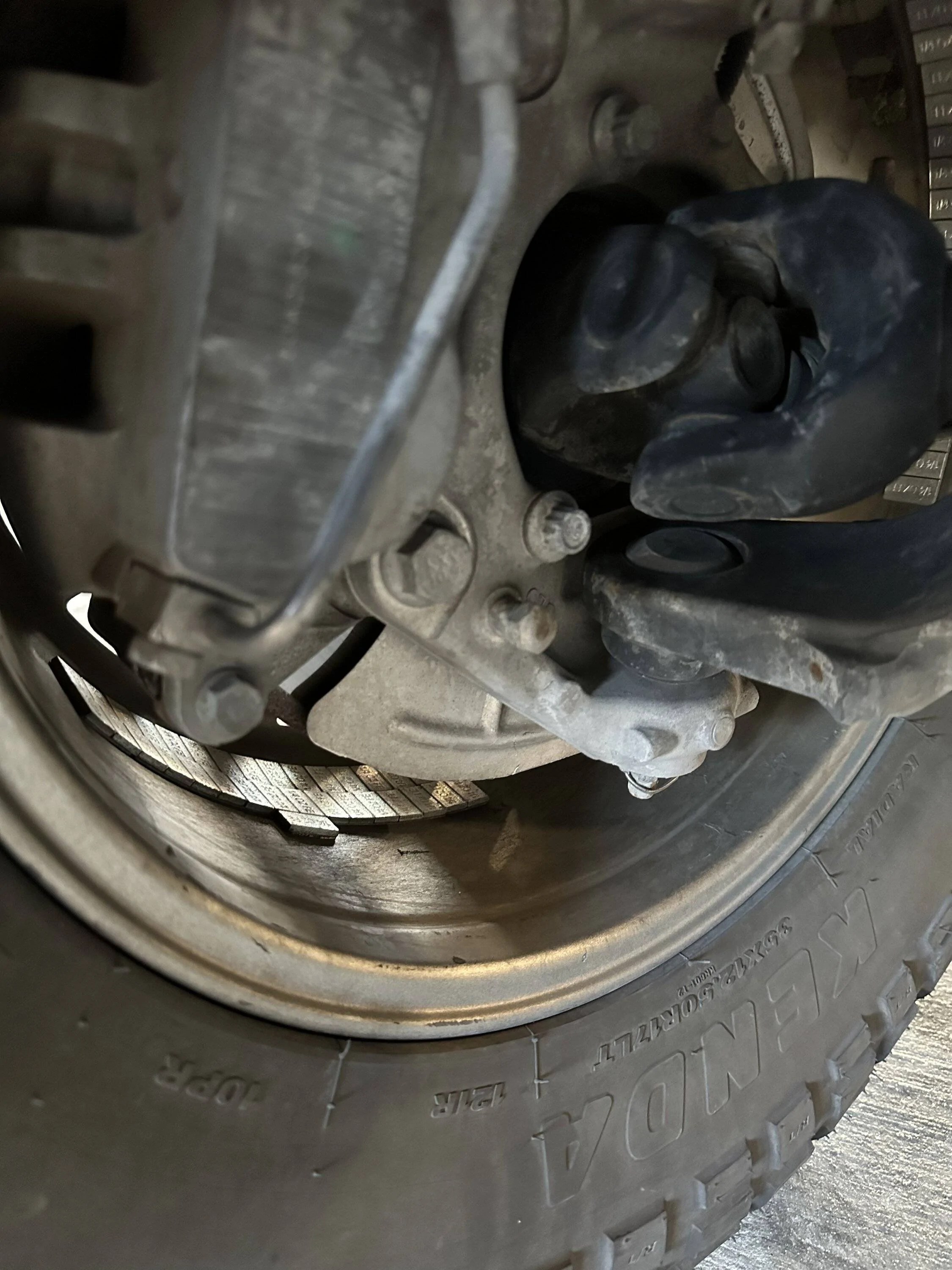

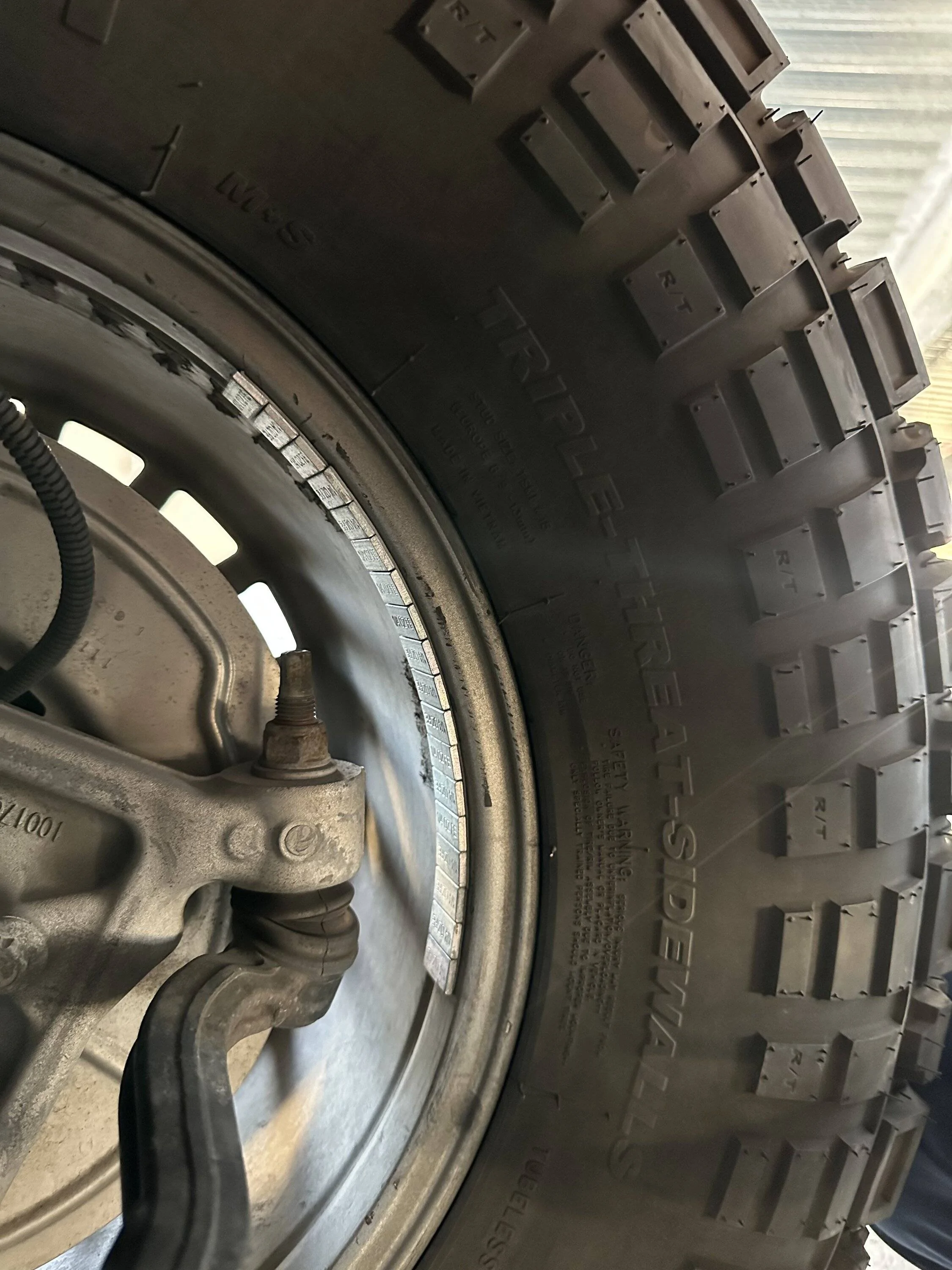

Thought I would update, Im getting a shimmy again after balancing it this past Tuesday. And one of the ones up front has an ungodly amount of weight. Would another road force balance help with rotating the tire on the wheel and balancing again? Or is this tire basically toast?

Have some 35" Kenda Klevers on a Ford truck, and I have noticed they do seem to flat spot a bit if parked on cold concrete for 2 to 3 days between trips. They do smooth out quickly, so it could be a characteristic of the tire. They didn't use a ton of weights to balance them though.
Having to use that much weight could be a couple of things. A bad tire is definitely one possibility, but a few other things that you could check too...
Note: Make sure you dig out any large rocks that are stuck in the treads before you drop it off. Some tire guys are good and will do that before balancing, but some won't, and then when the rocks fly out later, you get unbalanced tires. On "problem child tires", I've actually gone so far as to just yank off all the weights when I get there as well since some tire guys won't even pull the old ones off before spinning them (which could also lead to your mega-weight syndrome)
Does the road force balance include them dismounting the tire and trying to turn it 180 degrees and remount and then balance? Could be that your wheel and the tire both have a heavy spot that just happen to be the same when they were originally mounted. If it doesn't include that, may be worth having them try it just in case.
Also could possibly be a bent / damaged wheel as well.
But yes, could also be a bad tire.
@Discount Tire ?
You are right...That is quite a bit of weight, even for a tire of that size.
There are a few unknowns, but I will do my best to answer.
As a tire wears, the balance needs of the tire do change. It would not hurt to re visit the balancing side of the equation. I would have the tire rebalanced via a road force balance and see if that does the trick. That procedure will help identify things such as bent wheel, out of round, etc...
If the tire is cupped, a road force balance might not help at all. @KevinC11 is on the right track in rotating the tires often to mitigate the cupping if that is indeed the case. If you would like, I can reach out to a Discount Tire location close to you, advise them of the issues you are experiencing, and diagnose it for you. We are here to help.
