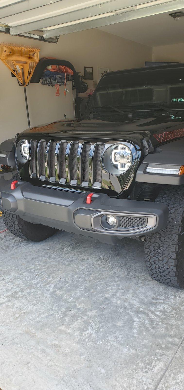

Just got my Kiwi 9" today via Amazon. Installed and tied both the left and the right into one wire then ran it to the fuse box and tapped into fuse 58. Everything went smoothly and the Halo's do look great. I also have to say that the adjustable screws they put do help a lot to adjust. I"ll have to wait till evening to do this but I can see that you can move the light fairly easily by adjusting the spring loaded screw. Excuse a couple pics with the plastic still on the headlight.

I did the exact same thing that @Arterius2 did. A few things to note here:
1. There is no instructions (Not that you will need them if you just read mine and @Arterius2 thread here.)
2. The lights are plug and play.
3. daisy chainl the left and right DRL wire (the red wire that is by itself on the back of the lights) and then wire them to a add-a-fuse and use #57.
4. You shouldn't have to flash them to get to work since the Jeep does not know if they are LED or not. I have a tazer and just configured it for LED anyway. Again, you shouldn't have to.
NOTE: Fuse #57 already has a fuse in it. However, it is for heated driver seat, which I do not have/want. I just popped that fuse out, and put in my add-a-fuse. This is key since this fuse slot is already wired into the battery.
DOUBLE NOTE: You must use the add-a-fuse from Amazon. I tried 2 different add-a-fuse from NAPA and AutoZone and they do not fit in the jeep fuse box.
I took these pictures in the day (not that it illustrates how bright these are), but they are super bright for LED halos! I am very happy as the cut off lights are VERY crisp
