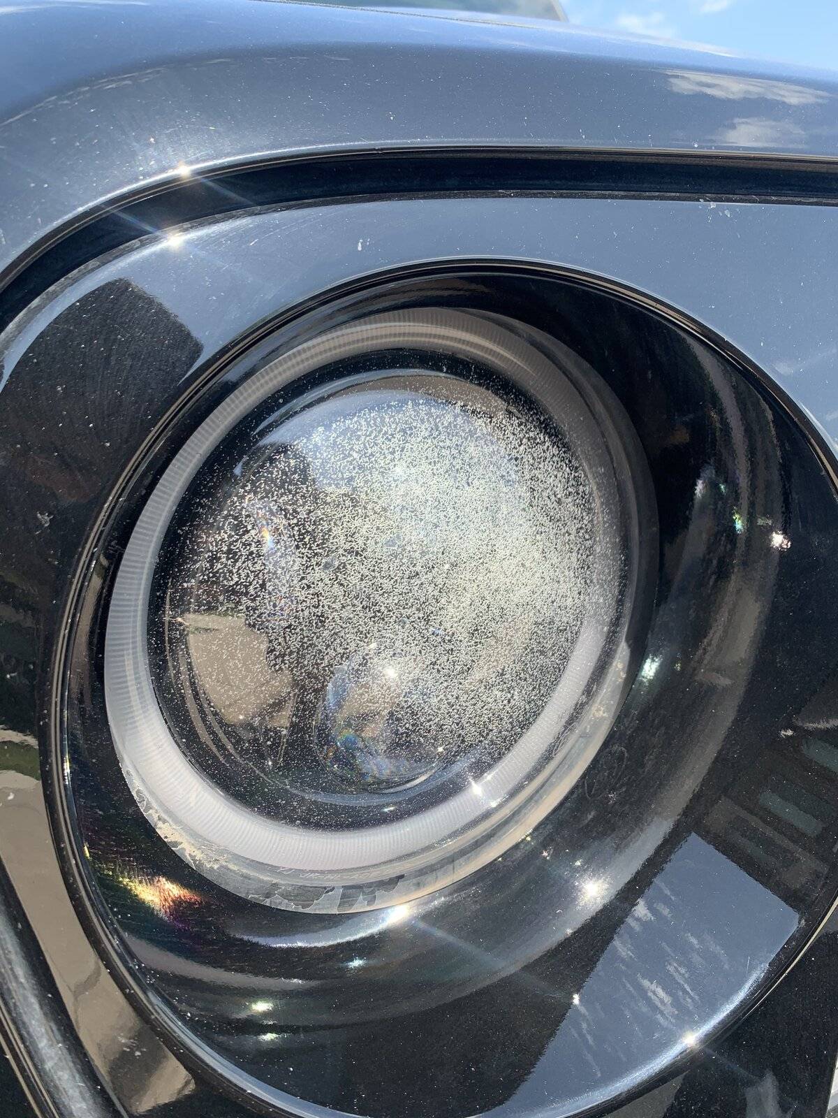

Made a new thread about this but realized I should have just added it here.
Any idea what this could be? Had my KIWI headlights for about a year and about a month ago I started getting these weird marks on the outside of the heads lights. Any suggestions? I love these headlights and want to find a way to salvage them

Any suggestions?
Posted this in your other thread.
Try a clay bar to see if it will remove that. It almost looks like some type of overspray.

Posted this in you other thread.
I'll try that! Thank you

Is it pitting from sand maybe??
