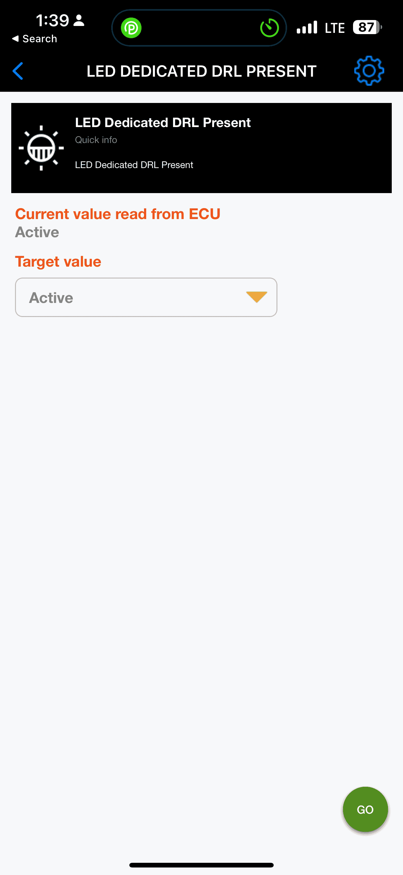

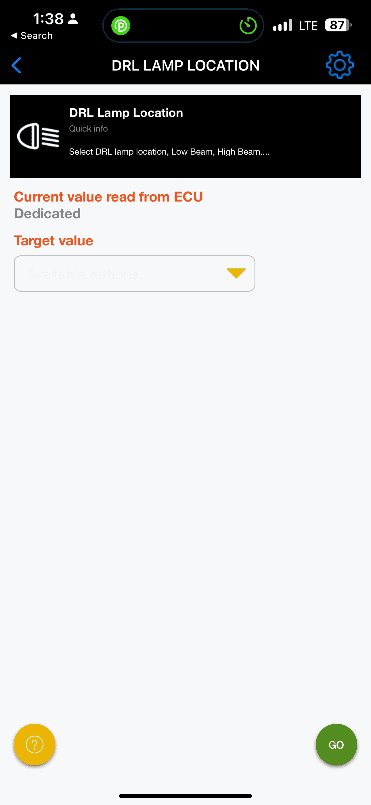

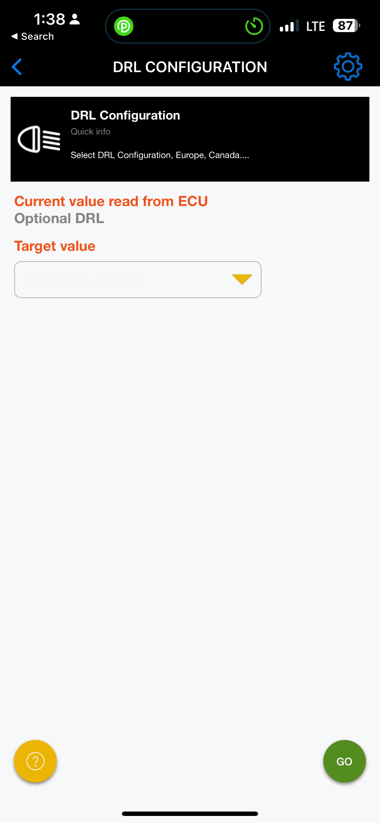

I recently installed kbd fenders and the lights on them are led . I plugged into the oem turn signal plug but they just flash like my hazard lights are on . Any ideas ? I have JScan and changed to led but no luck

With JSCAN did you change the drl to dedicated DRL, and your turn signal settings to LED?

You probably need the resistor in-line if you had halogens. Its specs are on the KBD website. Easy install.
