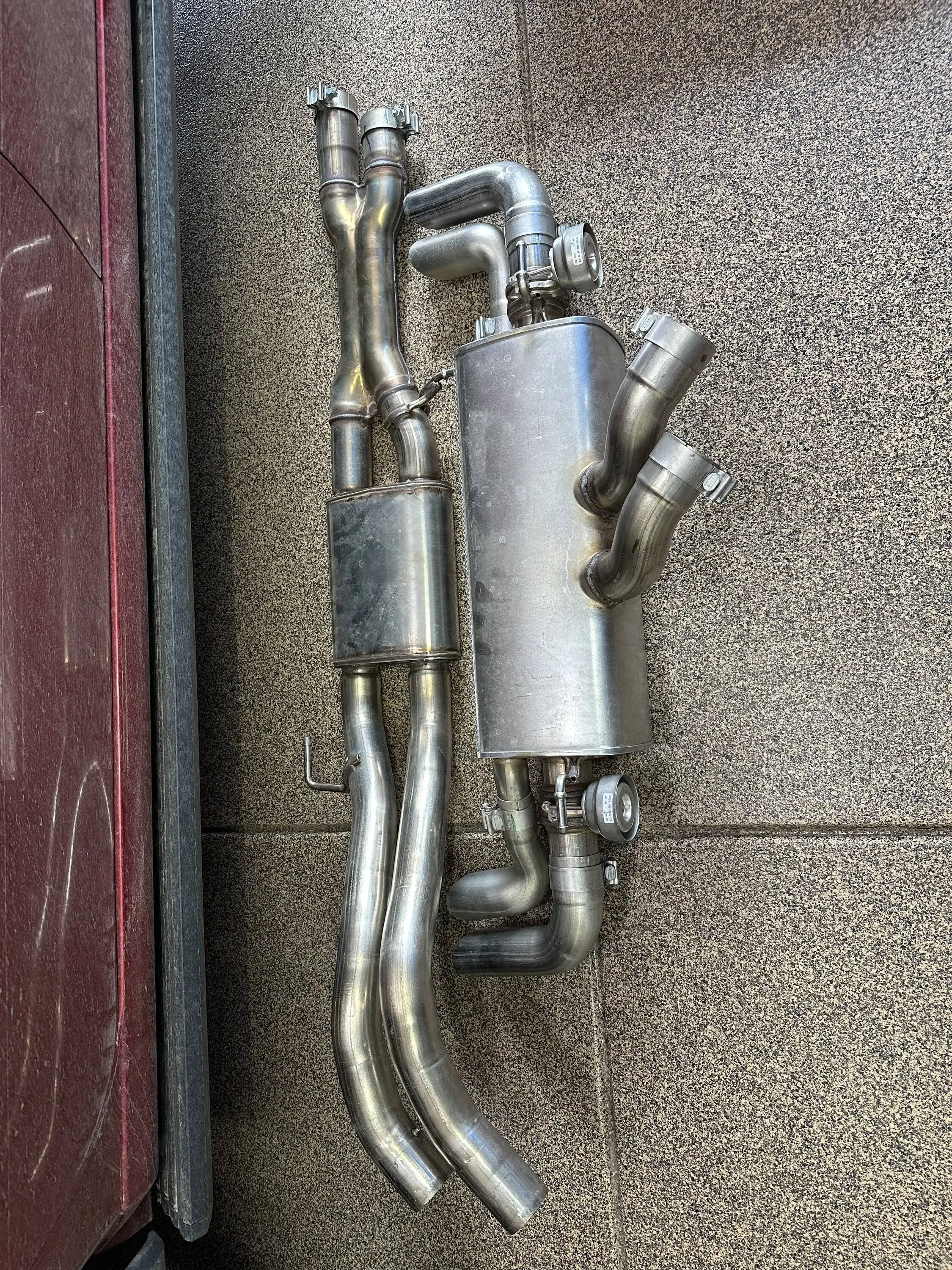

The problem with an axle back kit is that the 392 exhaust is only 2 pieces after the cats. It's the main resonator/x pipe, and then the muffler. And the muffler is somewhat unique in that the inlets are in the center of the body/canister, and not the end caps.

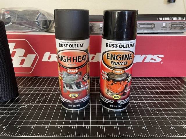

Simple rattle can job, prime with high heat, cure per directions, gloss paint.
@DoneDeal - I completely agree with @2nd 392 - that high temp spray paint is the right way to go. I went this method with most of my previous vehicles and it can be a 1-time job when done right. It is less than $100 in materials and shouldn't take much of your time.
Super easy to do with some automotive tape, painter's paper (for overspray), and high temp paint. I have generally gone with a matte finish but gloss doesn't look bad if you want to catch attention. As he said, pay attention to the instructions for curing the paint or you will need to do it all over again.
