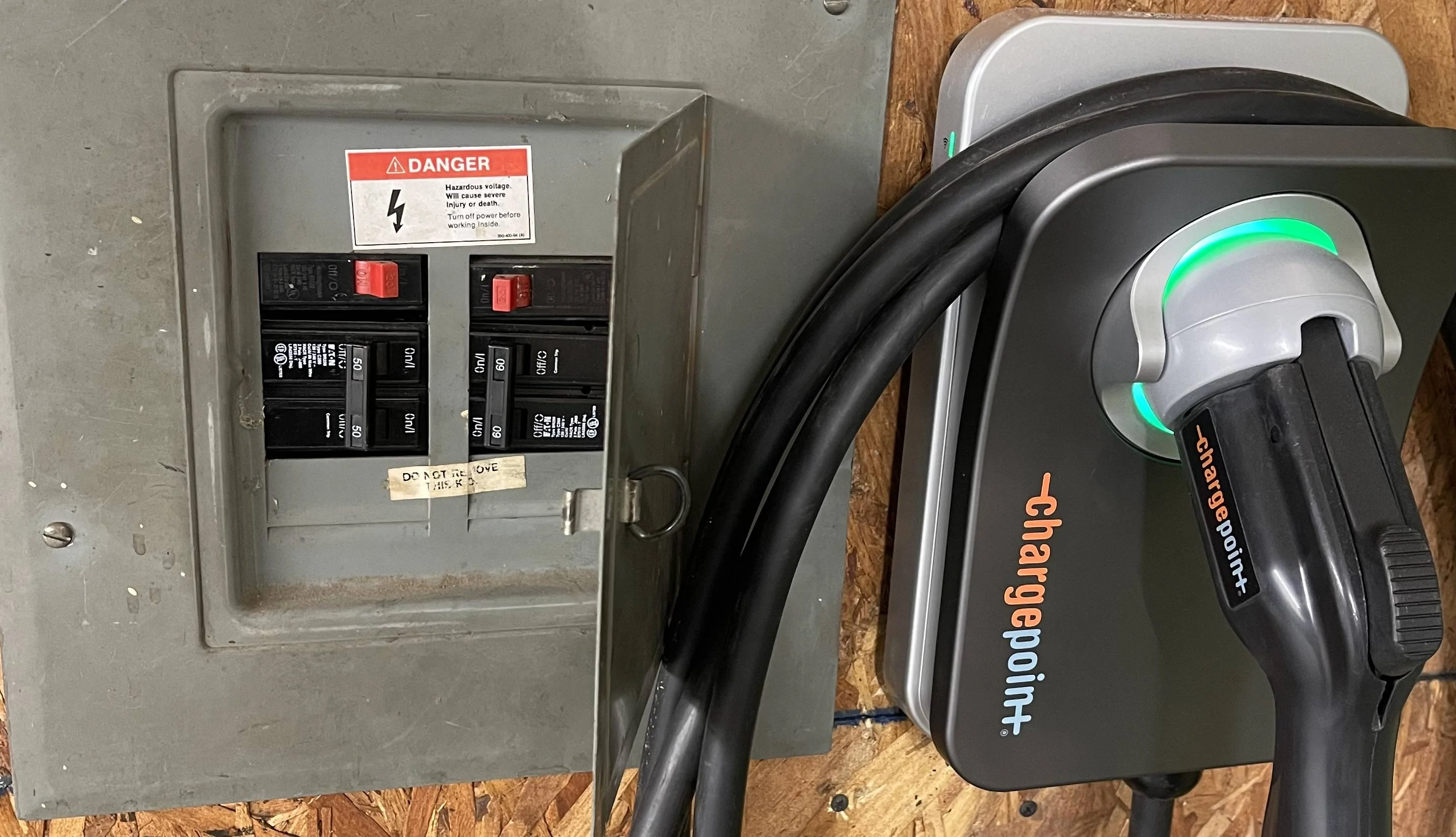

As EV's are becoming common, You are better off investing in a charger capable of delivering more Juice.
ChargePoint Home Flex, is great. In the mobile app you would select 40A breaker and it will deliver 32A [even if hooked on a higher A]
You would be better prepared for a future EV with a charger capable of better delivery and install a 60A or 80A circuit breaker almost at the same cost, if you install yourself [in my case i did myself], it is even better. Do check with your electrician if you are not comfortable DIY.
Check your main panel to which your garage subpanel is linked and on what circuit breaker it is linked with. Whats the total Amperage on it. If it is below 50, You probably will have to upgrade the wiring [unless you know the guage of the wire and capable of load]. Just be mindful about how many things you are running at the same time.
In my case, on my main panel circuit breaker, 100A Circuit Breaker is linked to garage subpanel. On my subpanel i maxed out at 150, I turn off my use RV plugin (50A) breaker when not in use. I regularly use chargepoint hardwired to a 60A circuit breaker. In your case, if you go that route, you can simply plug into a 50A circuit breaker and adjust settings in the App.

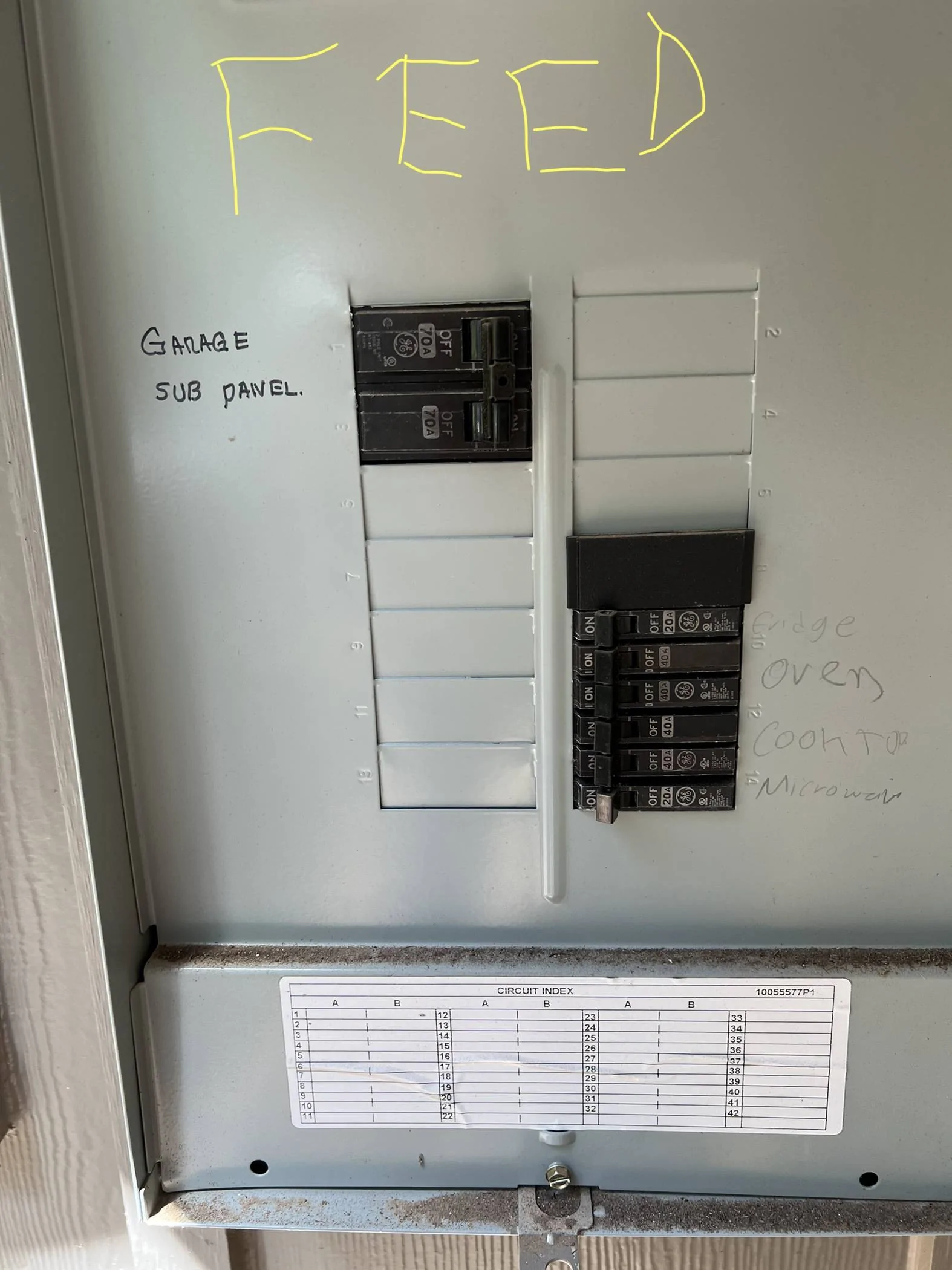

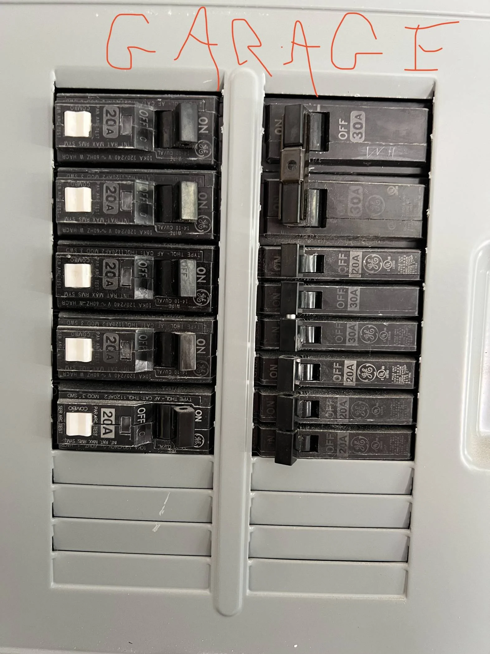

Appreciate the comments here. My house has gone through about 3 remodels over the years and it was built in the late 60’s as well. From what I can tell, I have a sub panel feeding another sub panel to our garage addition.
the feeder looks to have 70A at 240 going to garage. Then garage has heat pump and air handler at 30A breakers each, plus some other plugs/lights. There has to be some derating calculations and assumptions that things are not hitting the system all in parallel. Due to this…probably need electrician to assess as mentioned. Thanks.
