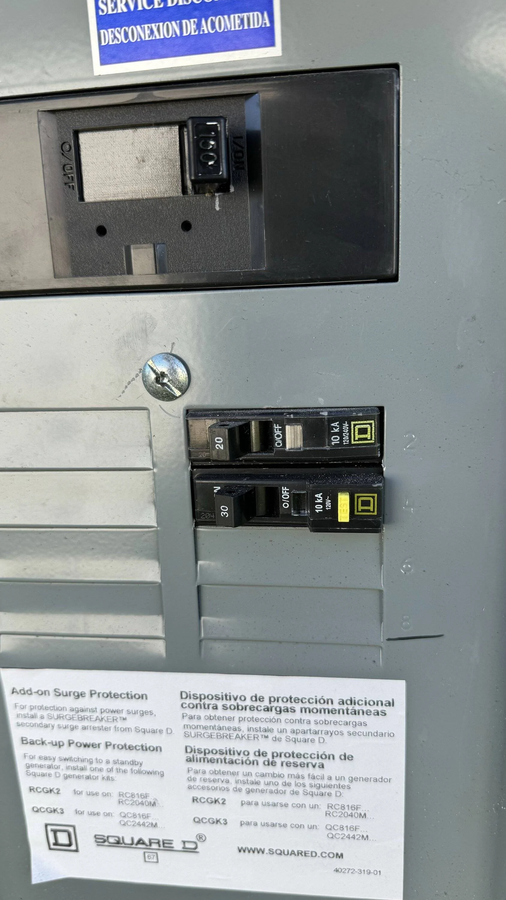

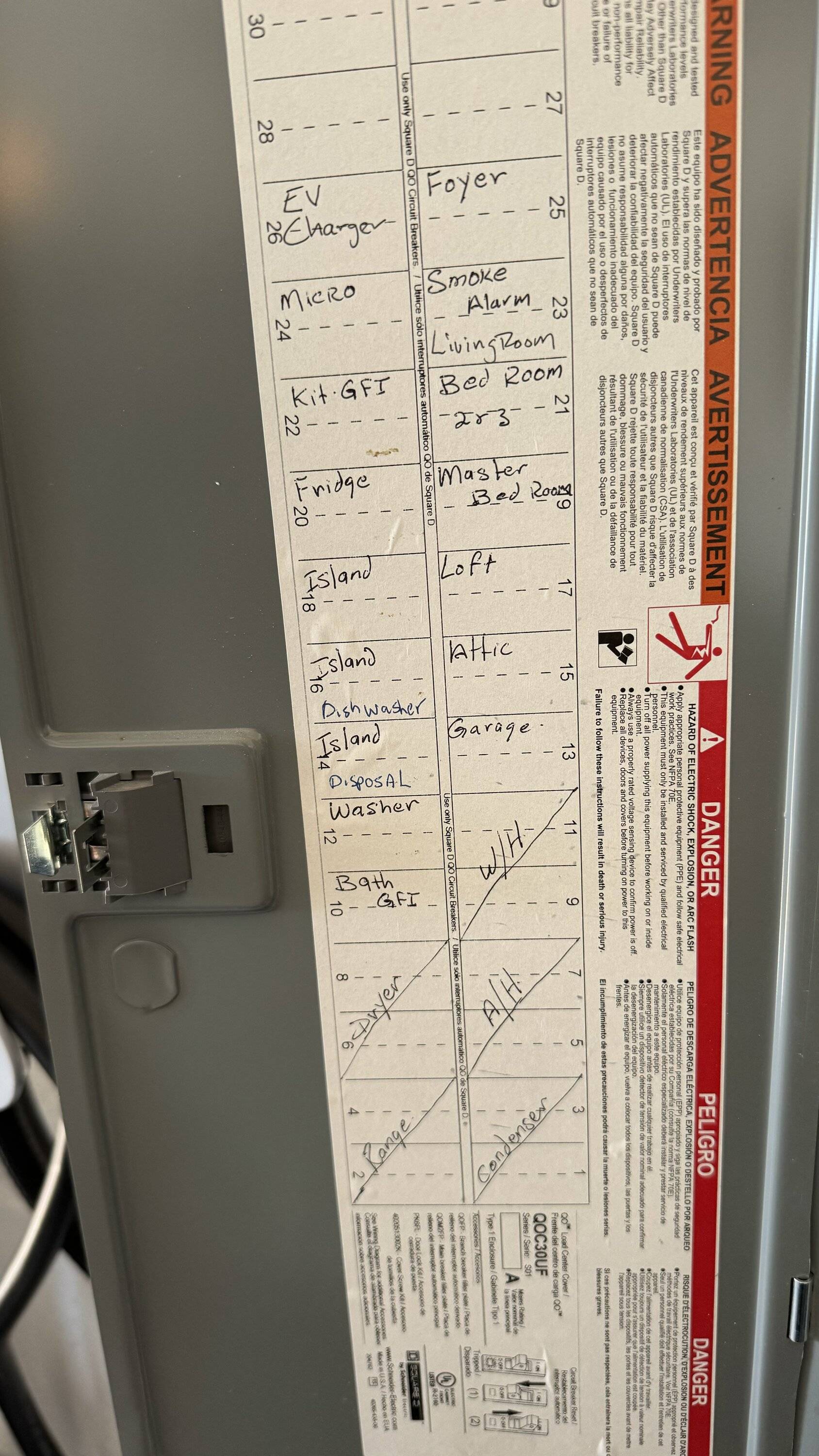

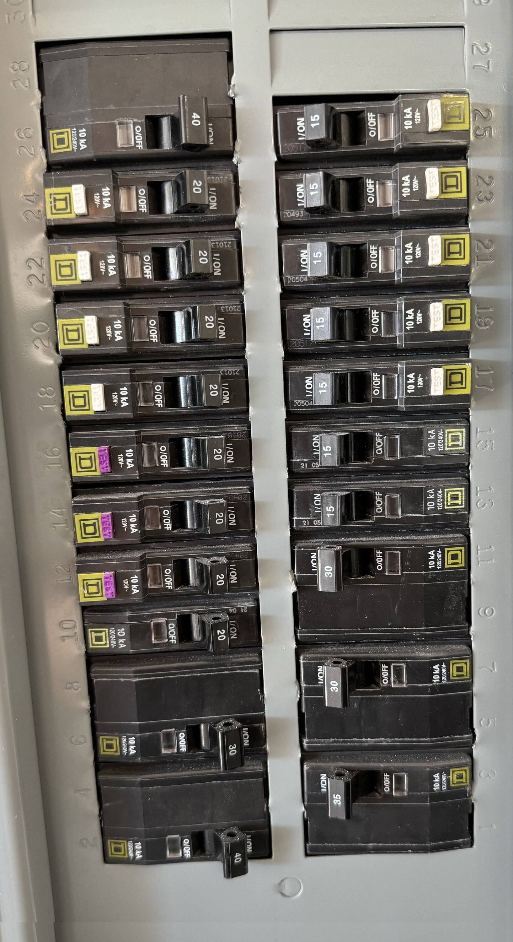

Here are pictures of my panel. The outdoor panel has the main shut off, a 30a breaker for a hot tub, and a 20a breaker for an irrigation controller and some outdoor outlets.
The panel in the garage is fed from the main panel outside. The JuiceBox is on the 40a breaker that's on the top left.
