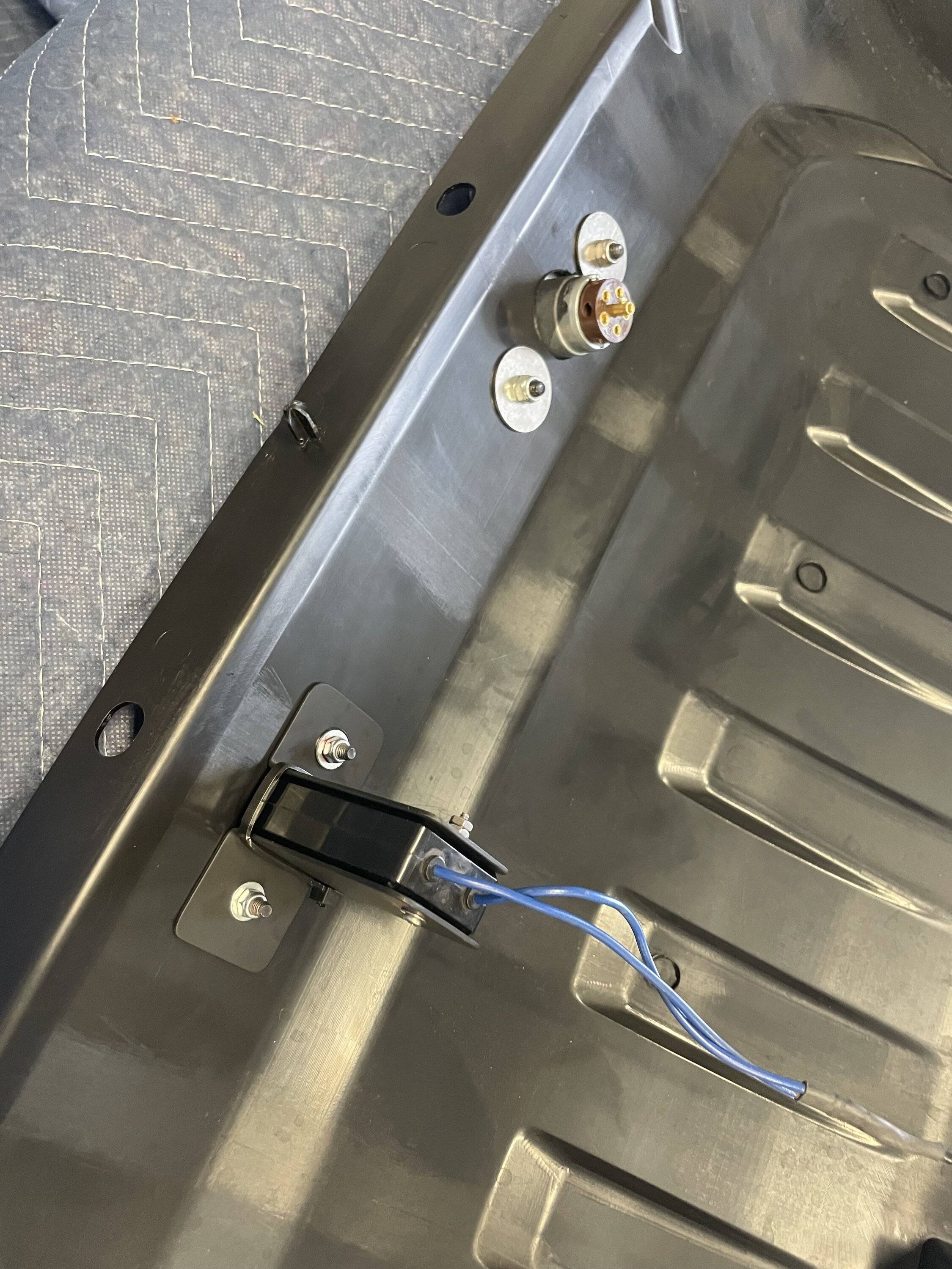

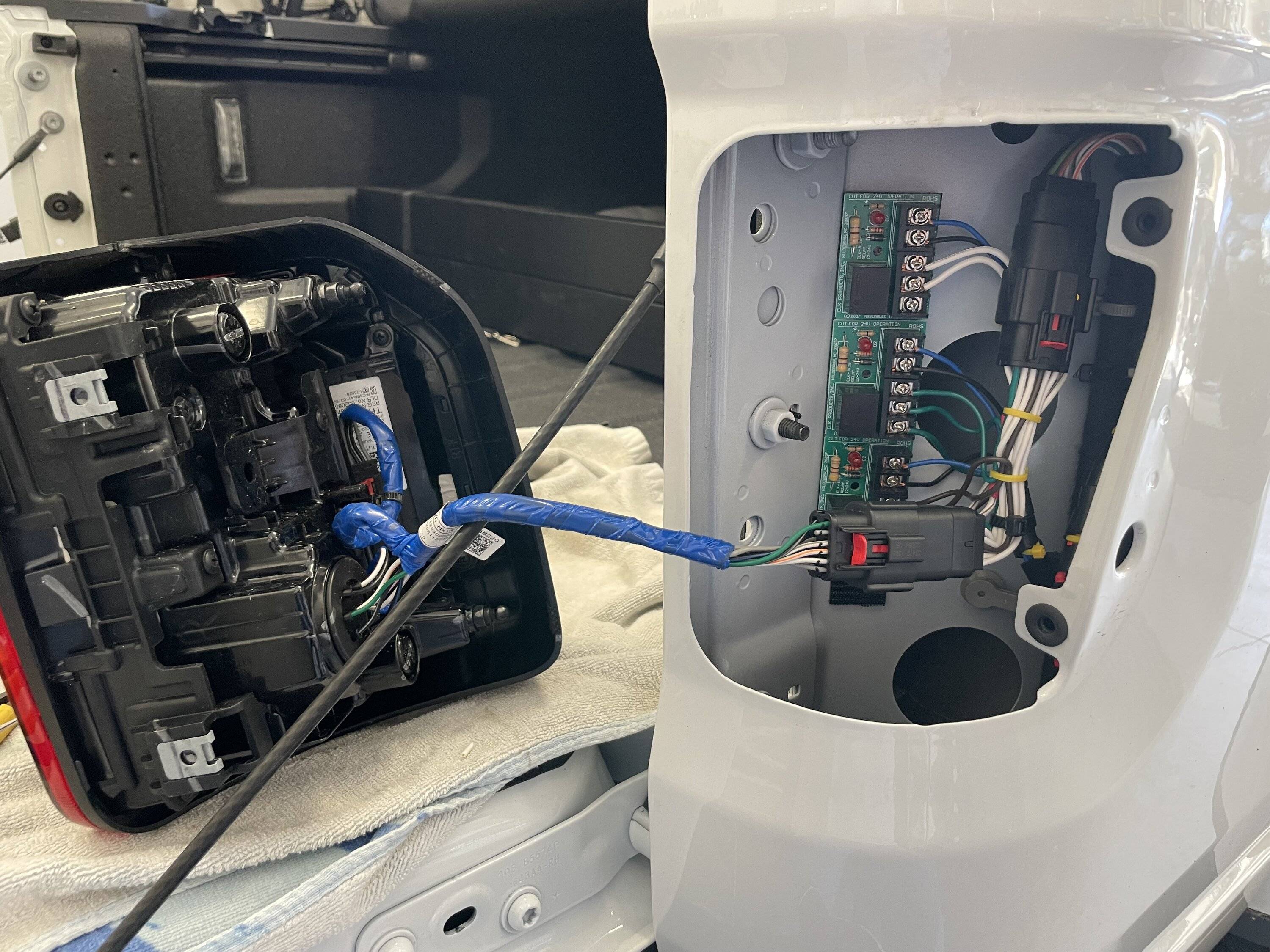

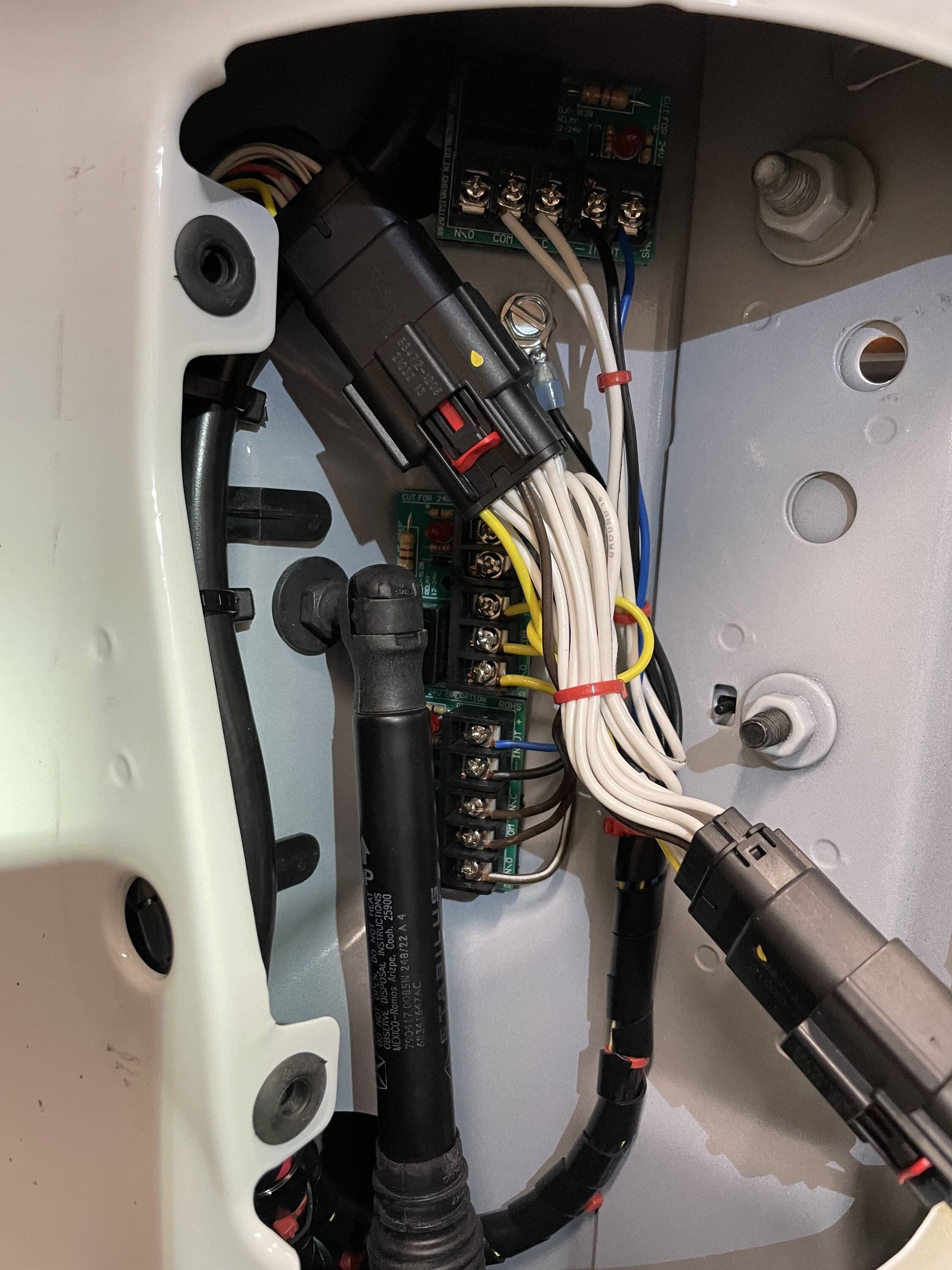

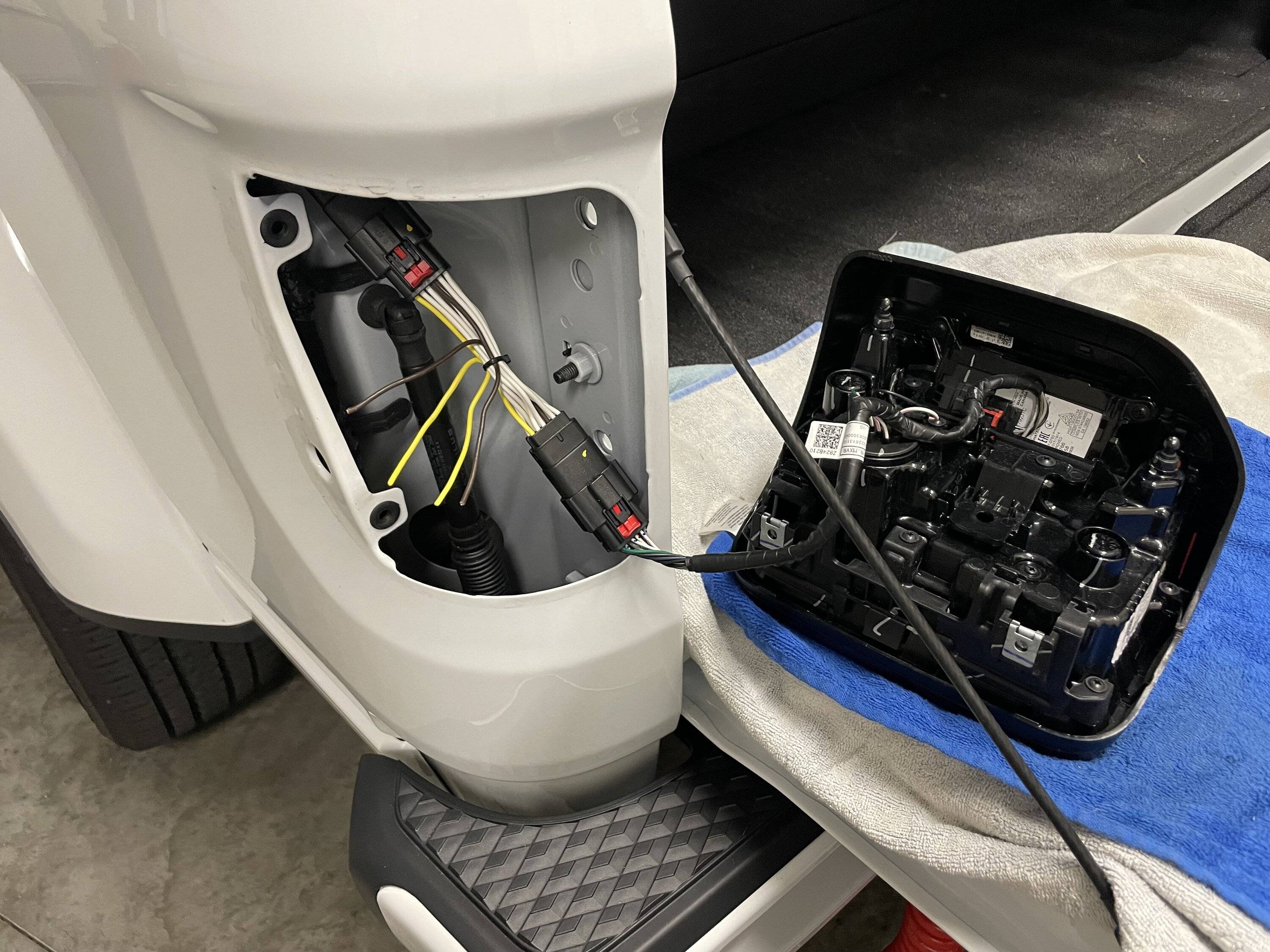

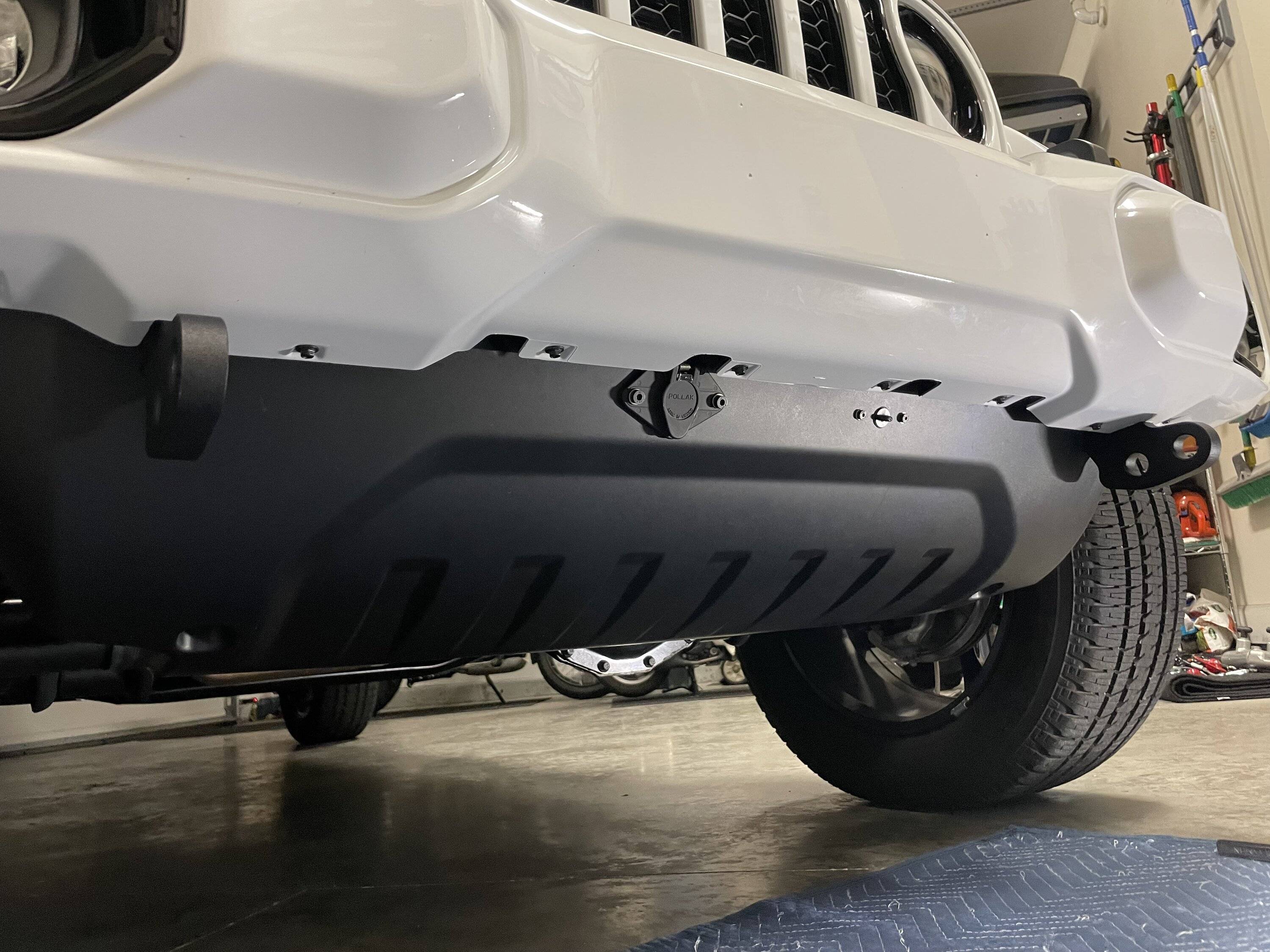

I decided to implement my own solution which activates automatically and also prevents the BCM from waking up.
Installed 3 relays per tail light (Turn/Brake, Tail light, and BCM sensor signal). Relays are activated when the RV's tow cable is connected (via 12V aux power). When RV is not connected, the relays are not powered and default to the Jeeps wiring.
Used a pre-built set of connectors from Curt so I didn't have to cut or splice any OEM wires.
Hardest part was snaking a 6 conductor cable through the frame rail from the front bumper to the rear tail light :)
