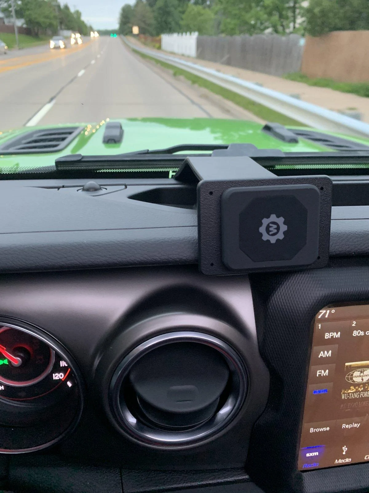

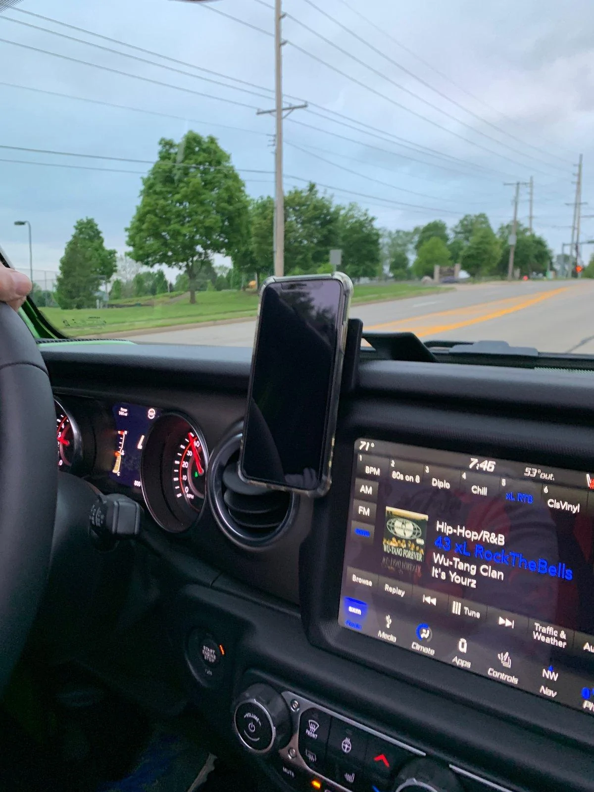

Thanks to a few on here for the idea of this, but i decided to go with a ProClip and a magnetic attachment. The location is good and out of the way and the magnet is strong. It came with a few sizes, but found that the larger rectangular plate interfered with my wireless charger at home, so i used the smaller (circular) magnet. It holds good and still allows for wireless charging in the cradle at home. I will explore a wireless magnetic option for the JL in the future, but this works for now. I might just run a USB cable up to it, but i typically dont have much of a need to charge in the Jeep.
ProClip - https://www.proclipusa.com/product/855431-proclip-center-dash-mount
Magnet - https://www.amazon.com/gp/product/B0756NFMCC/ref=ppx_yo_dt_b_asin_title_o02_s00?ie=UTF8&psc=1

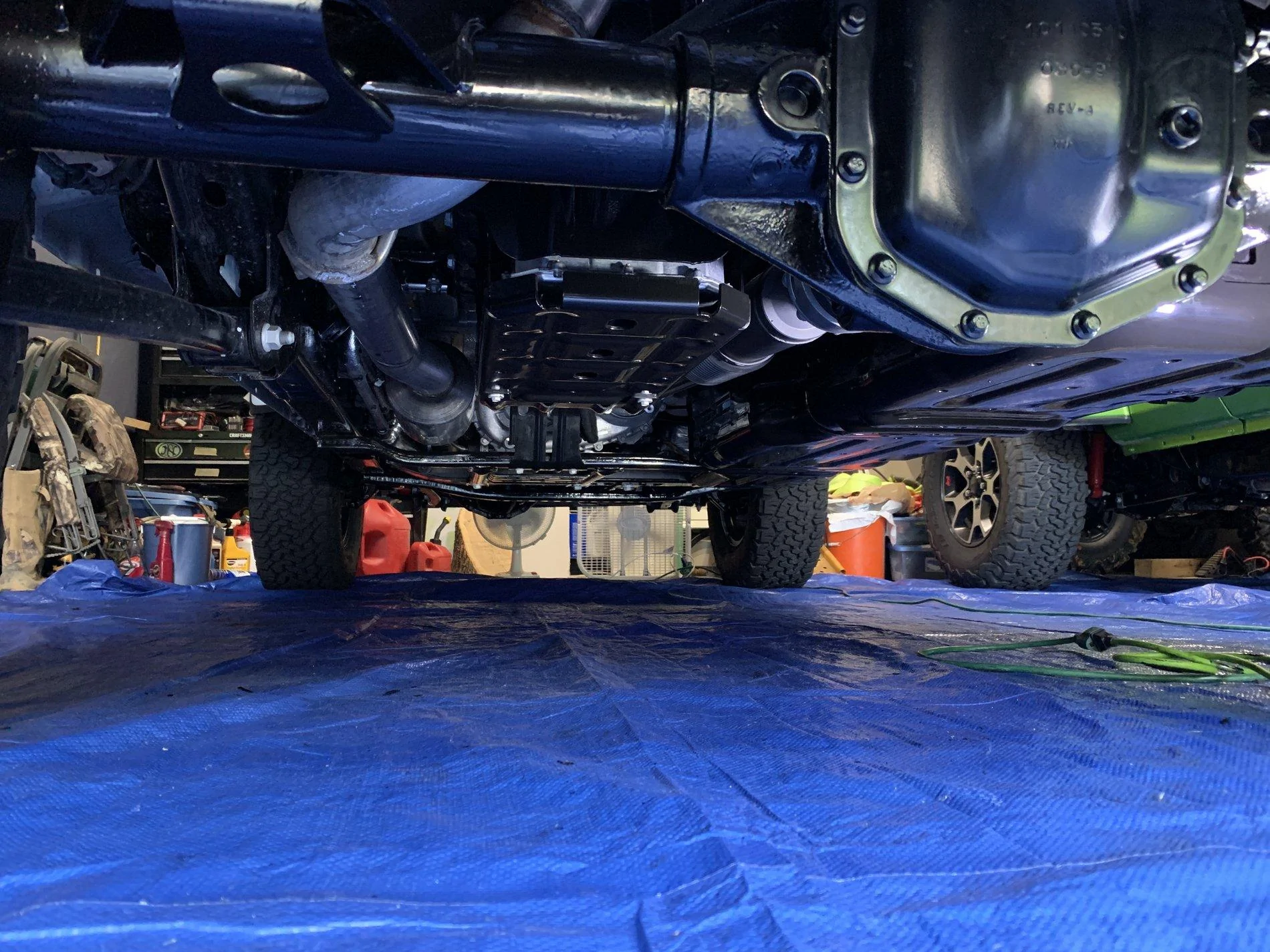

Did 2 coats of POR15 on the underparts of both of our Jeeps: hitch receiver, axles, knuckles, trays/skids, crossmembers and frame rails. Had to be careful not to hit threaded holes or existing bolts or metal seams. You might want to remove stuff at some point! :) It came out nice. I hope this effort helps to minimize the rust over the years! I did not do diff covers or bolts. For reference, it took about 1.5hrs per coat.

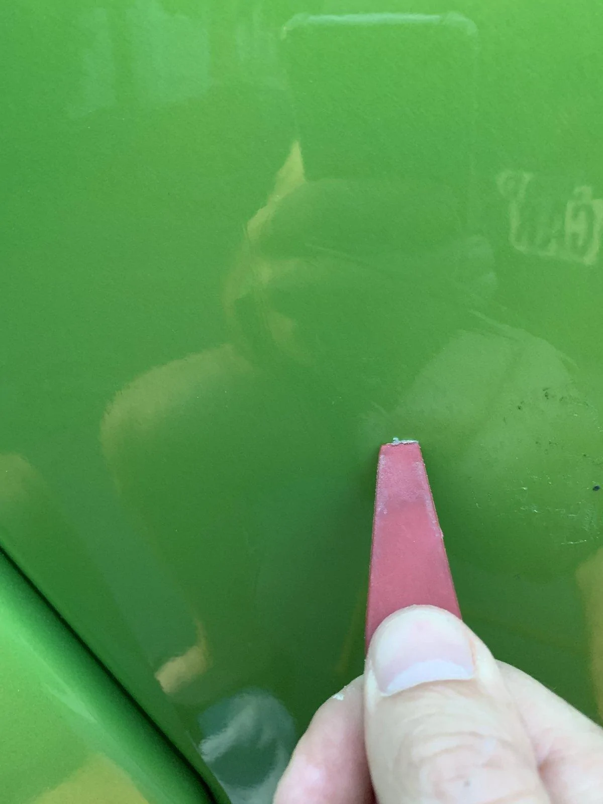

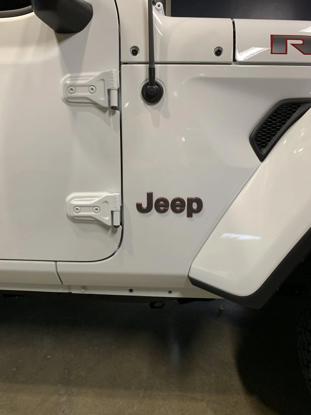

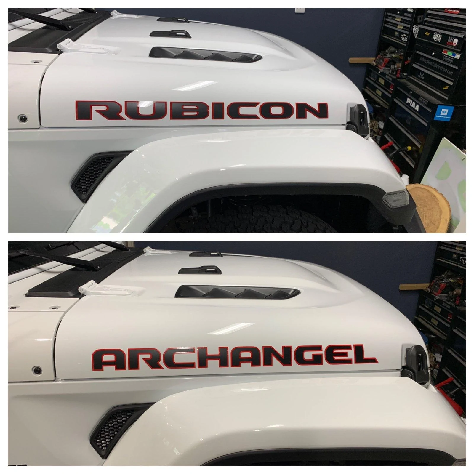

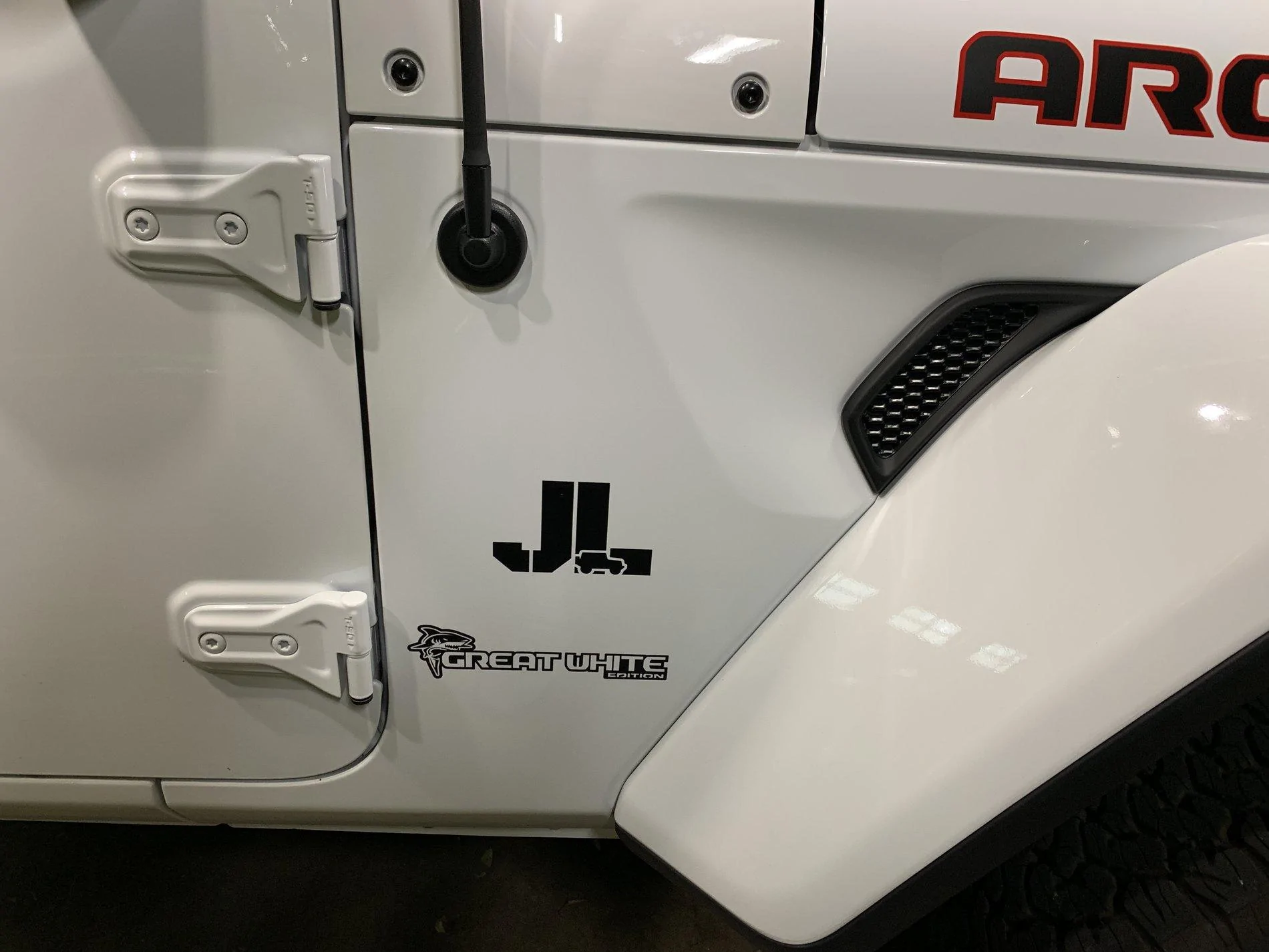

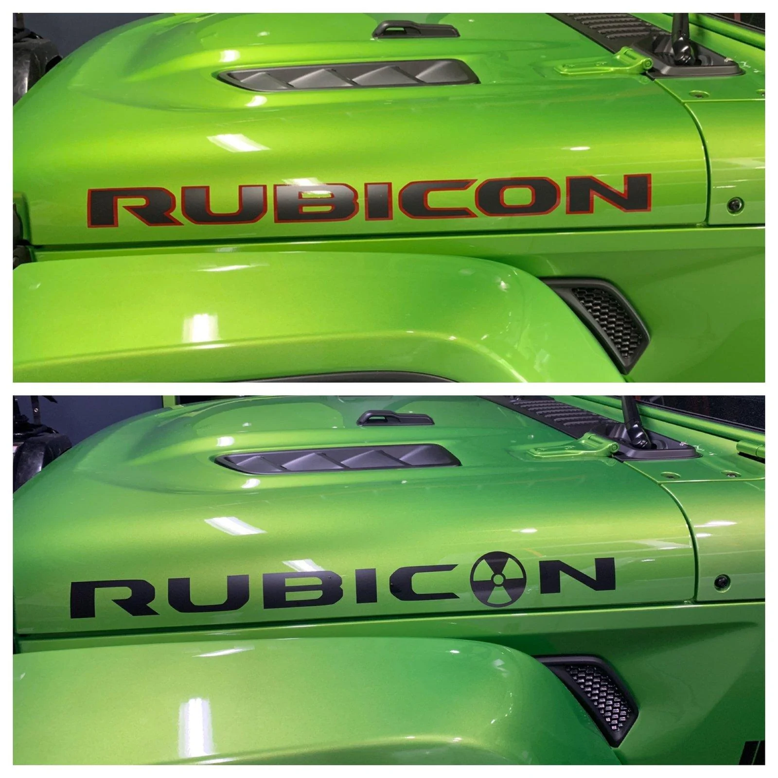

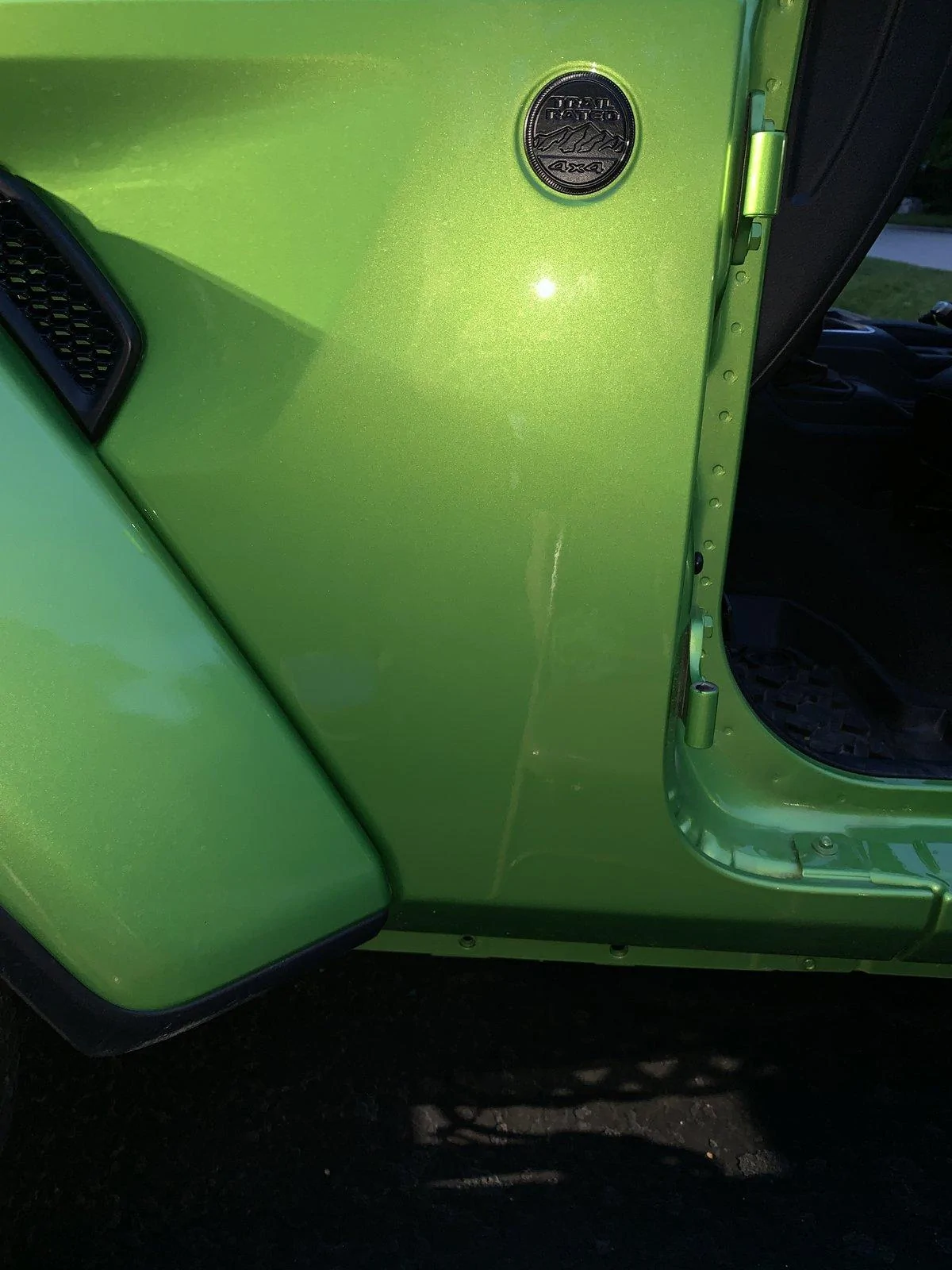

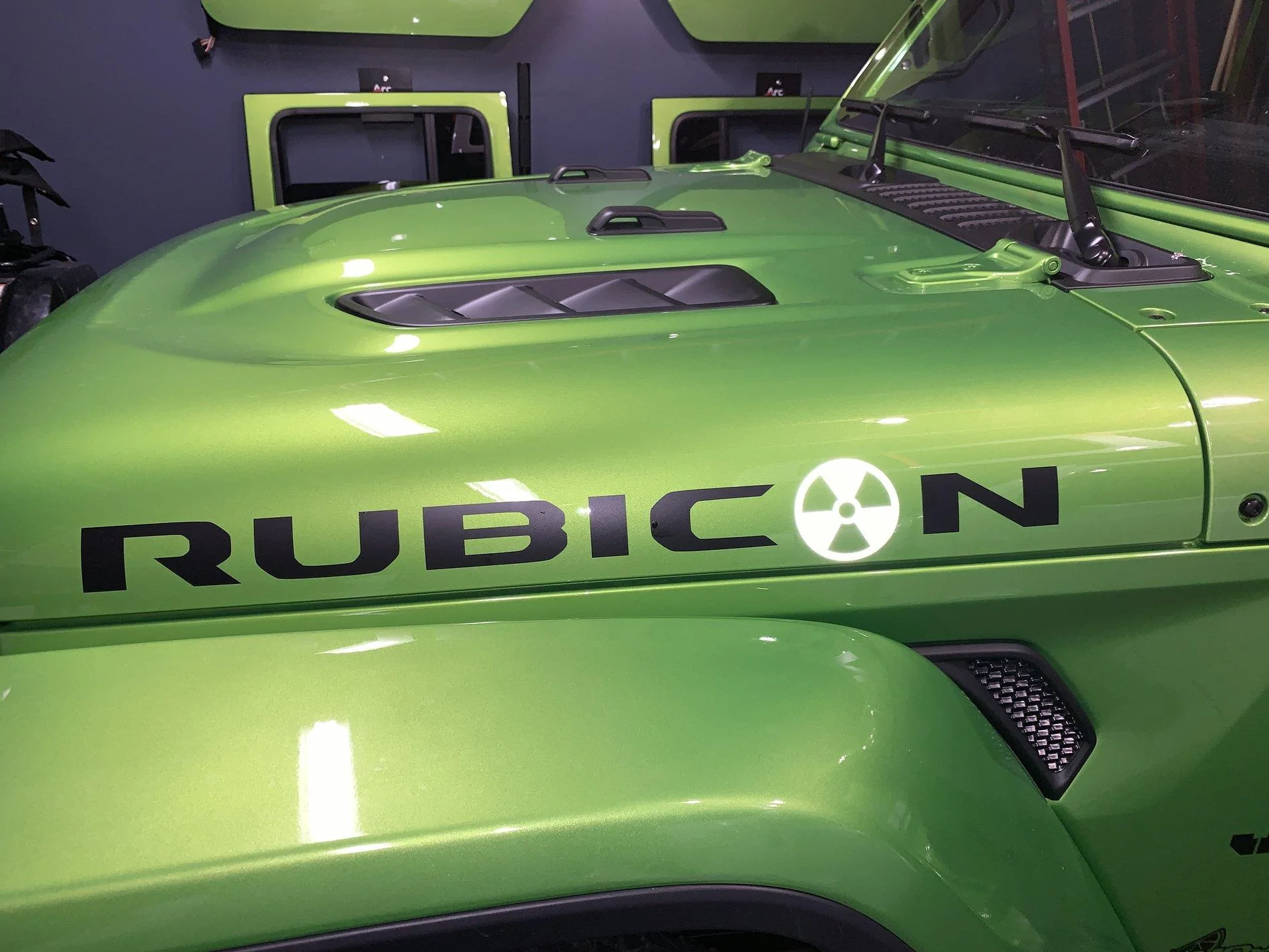

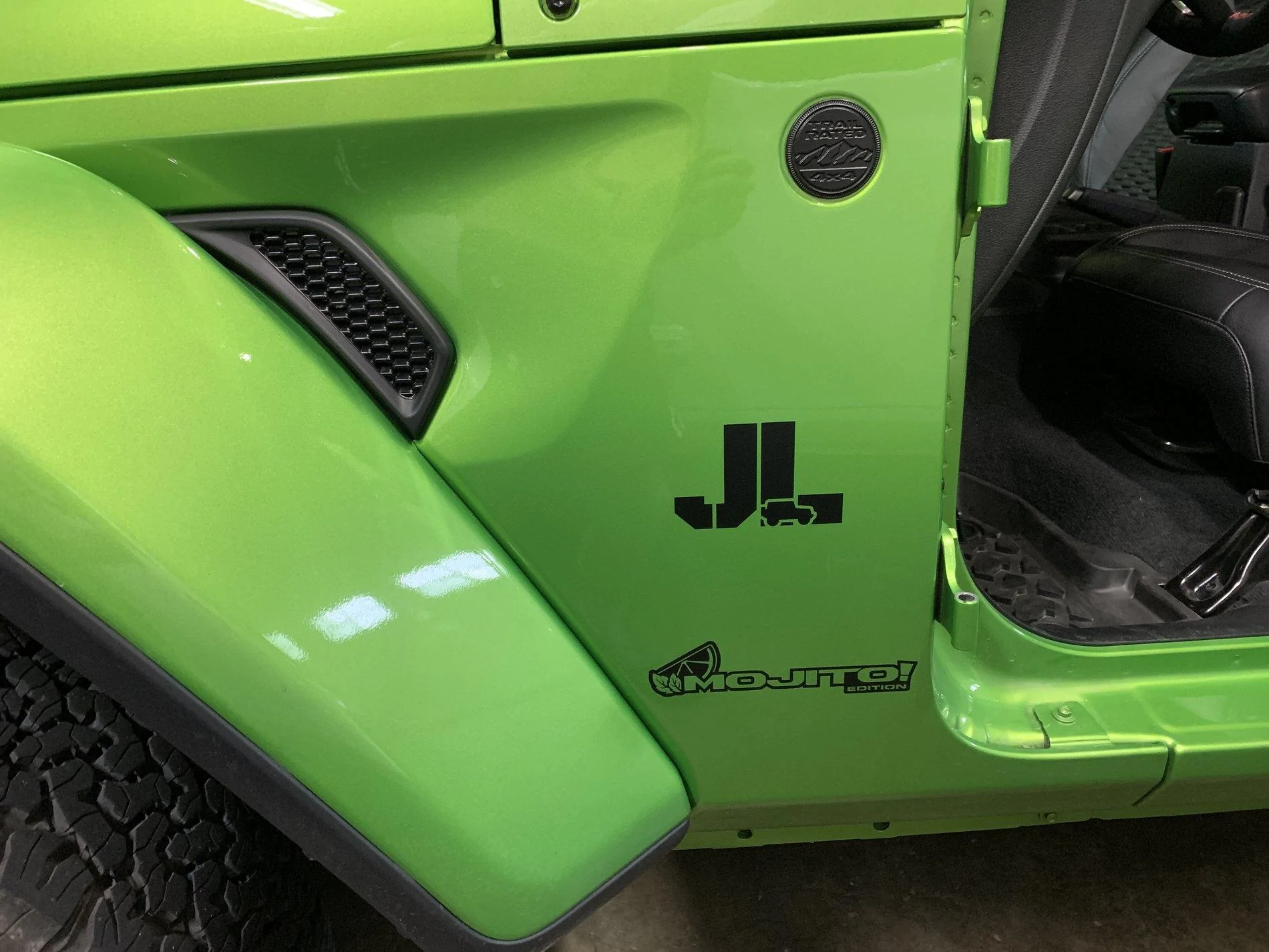

Our projects finally got their branding, thanks to Don at @pixeldecals. Thanks for all the assistance Don! Don really helped me understand my specific need with the radioactive sticker. Initially, i wanted a fatter font, but Don convinced (and showed) me that by adding a matching border, the font appeared too fat. I REALLY like the way it turned out, so thanks again. We both removed the JEEP badge and re-stickered with "JL" and our respective "edition" stickers. For me - i finally got rid of that pesky red accent color :brokenhearted:
BTW - that JEEP badge is on there good! Damn you @FCA :) That should be an ordering option :)
To remove, we used a thin trim tool to pry the individual badges of, then used a "scrape and lift" method, under the remaining rubber glue. The remaining "stucko" was removed with GooGone and a micro-fiber cloth. Left minimal micro-scratches. We only created some due to finding out the best process to use.....so HEED the warning :like:
The radioactive "Rubicon" does have the matte black reflective symbol :)

That is cool. Nice job! Did you design the graphics?

Thanks! We basically picked from designs offered from pixeldecals.com. They do a great job with replacement "Rubicon" stickers, for the hood. Since my build was named "Radioactive", i had the idea for the reflective symbol to replace the "O" in Rubicon. Don from PixelDecals helped in mocking them up to show what they would look like. In the end, i greatly appreciated his input. Others on here have cool replacement stickers too, along with other cool added ones:

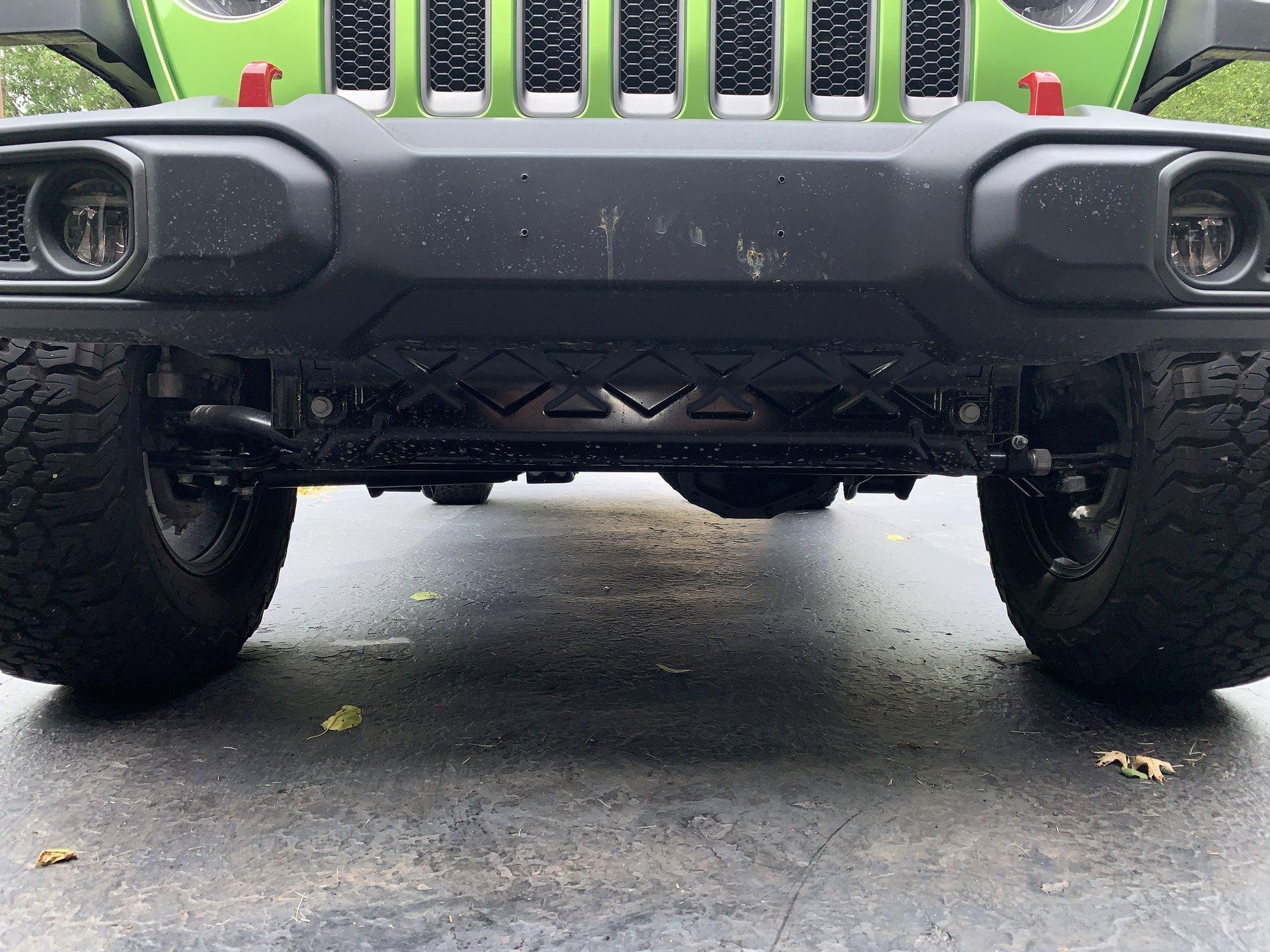

Small mod today: removed the front lower air dam. Couldnt handle seeing it and also prepping for the lifts/steering in the next couple weeks. A quick and easy day - gotta enjoy the weekend sometime! :beer: We decided to leave the metal plate that protects the e-disco (sway bar): didnt like the idea of it being exposed and didnt look as good.....we liked the "all black" look. For now, we are leaving it......dreaming of the day for some new bumpers. :please:
Followed instructions from here -
