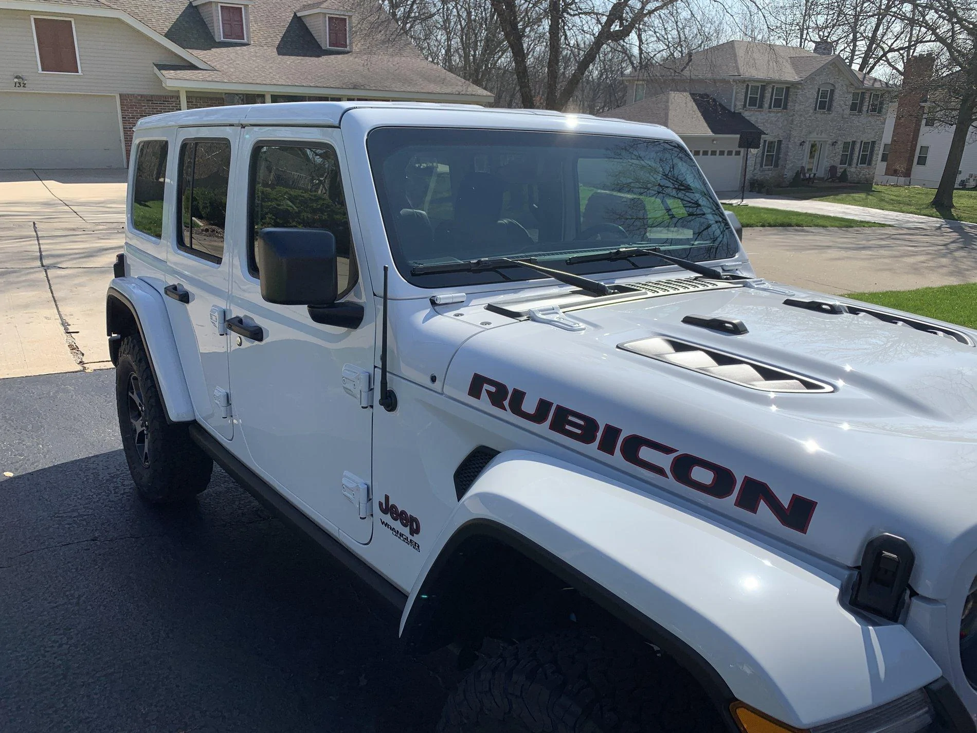

Let's start the build!!! Here's the acceptance at the dealer!
Happy Wife.... ;)
And so is born the "ARCHANGEL" build. :rock:

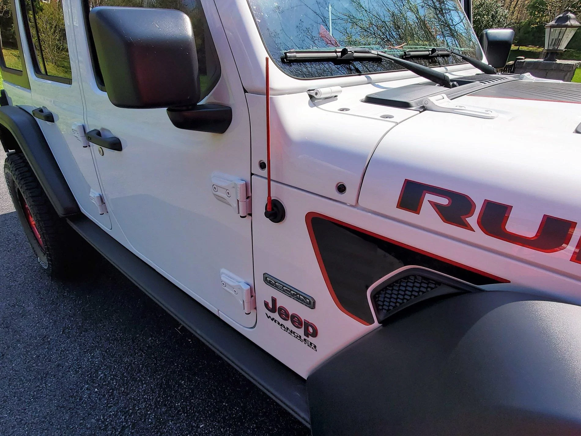

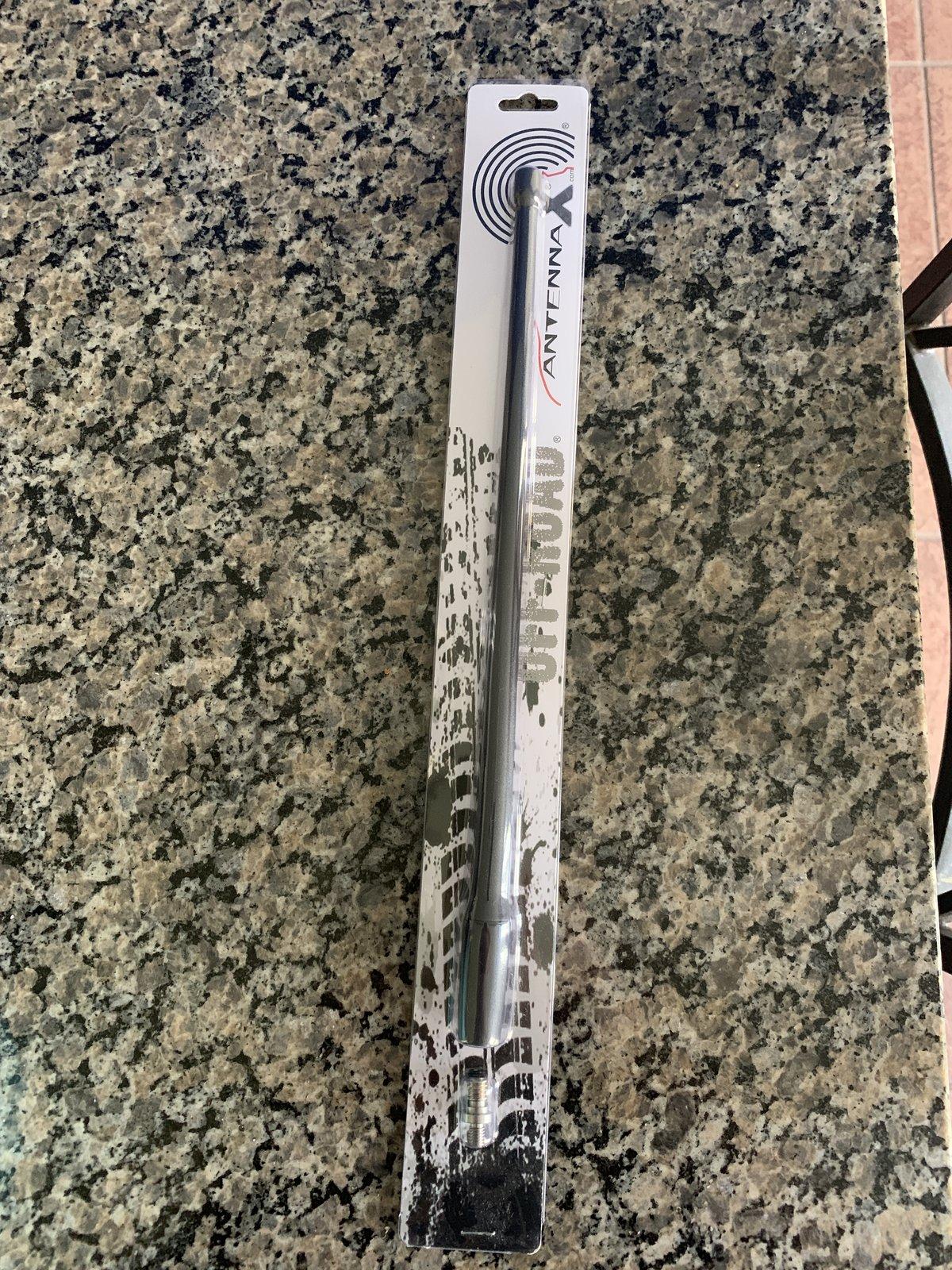

Antenna:
https://www.amazon.com/gp/product/B00651CLCS/ref=oh_aui_search_asin_title?ie=UTF8&psc=1

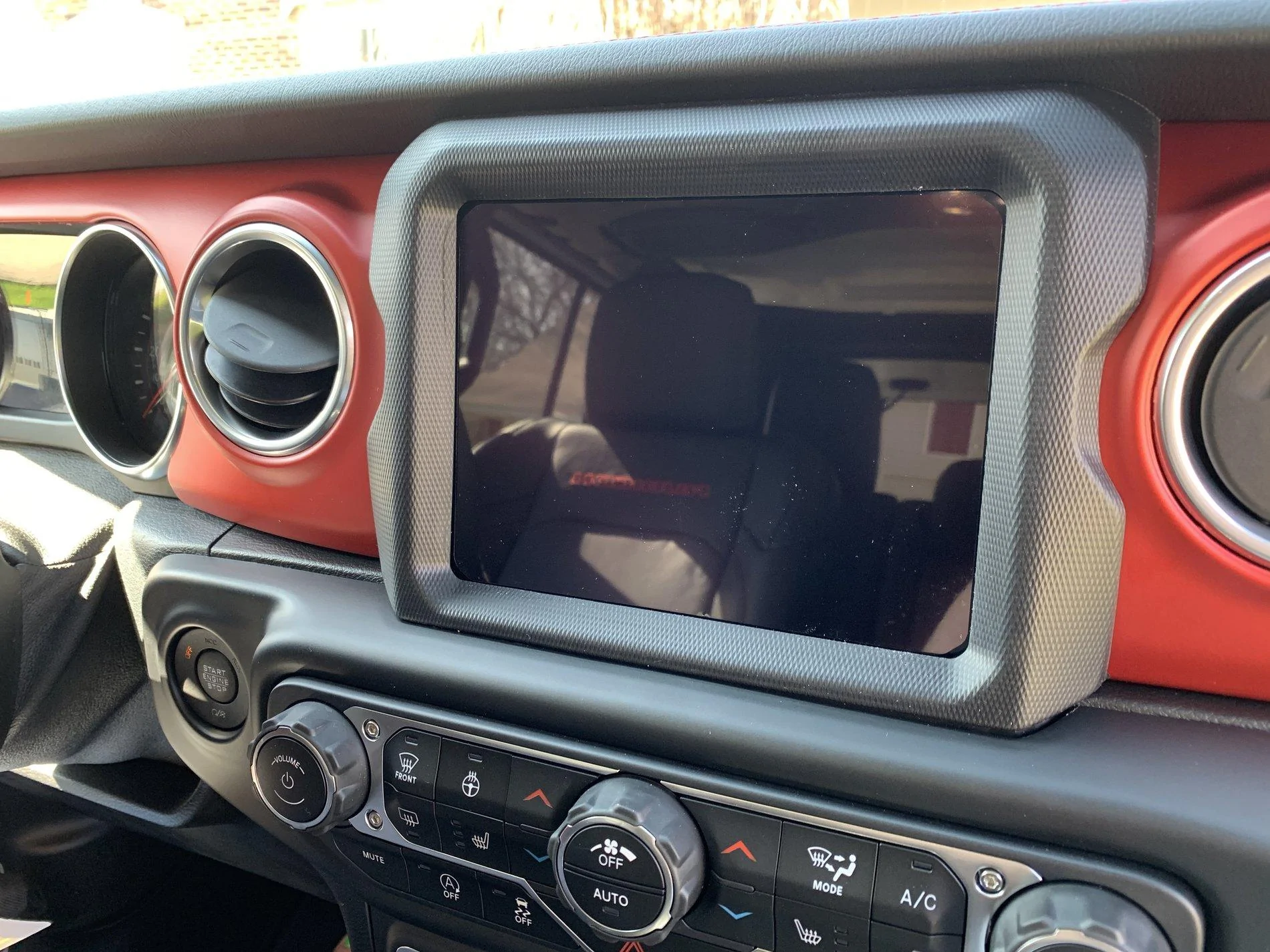

8.4" Screen Protector
https://www.amazon.com/gp/product/B0781V2P6J/ref=oh_aui_search_asin_title?ie=UTF8&psc=1
Note: Was easy to put on and walk out the air bubbles. It did add a reflection to the surface, where the typical surface is "matte", but seemed to really make the screen "pop" more. Like it so far....time will tell.

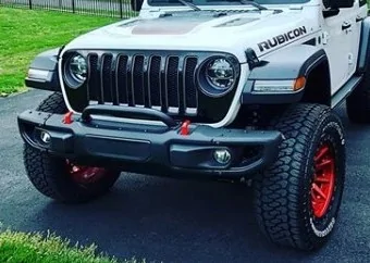

I'm doing some custom powdercoating on my new Rubicon Recon and wondering if I should change the color of bar from black to red or leave it black? Thoughts appreciated.
I did a photoshop of what it would kind of look like in red.

We used the USB/card as a "media source". We loaded them up with MP3s and can play music from them :)
To your question about the color: personally, i like the black for that bar, but that's just me. The red would make you stand out more. i dont think i've seen a red bar like that yet. Do whatever looks better to you. You could always paint it 1 color and if it doesnt work, then have it powdercoated the other color. Also - those red wheels look great! :fist bump:
Thanks so much. Makes sense on MP3 music choices. Great build you have going.
On the color, I wouldn't consider it if I wasn't taking in my EVO roof rack and KC light bar for powdercoating already. Wife and kids are mixed in opinion on keep the bar black or go with the red.

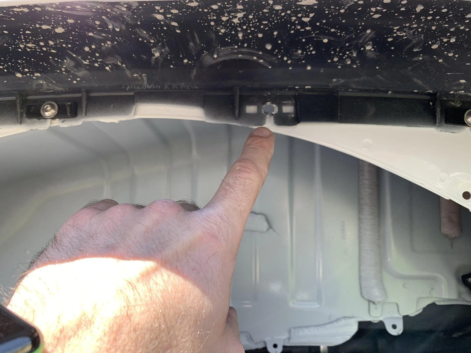

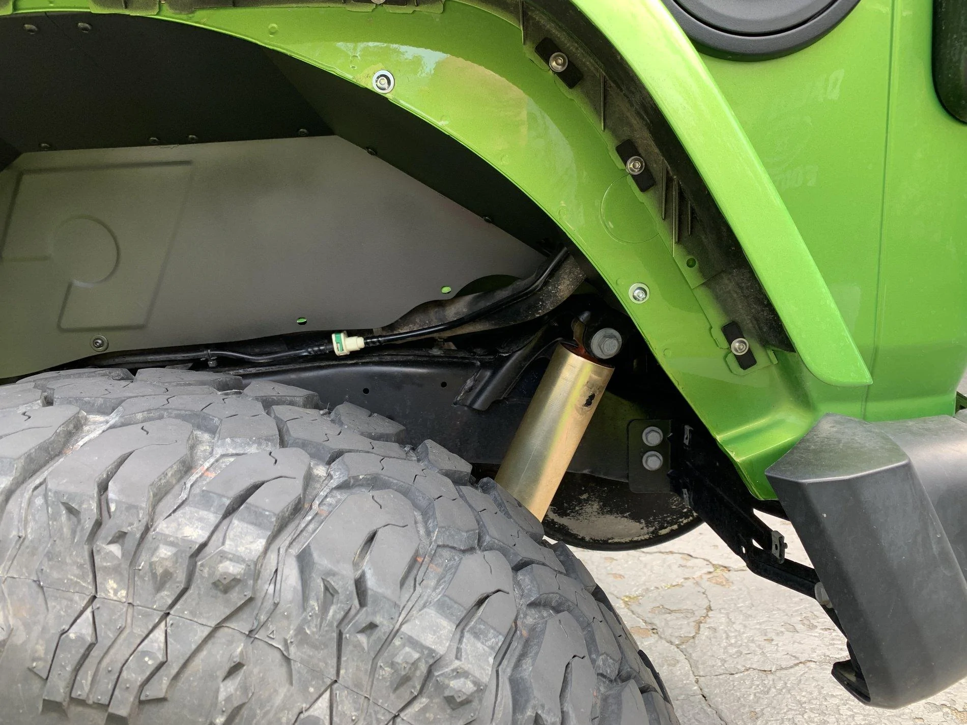

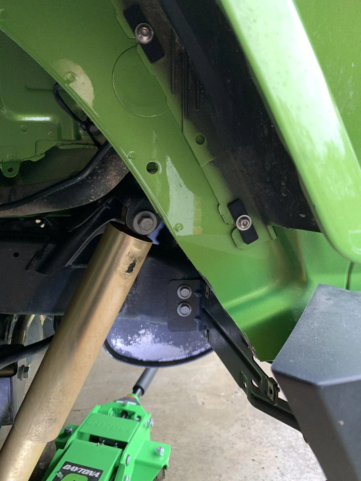

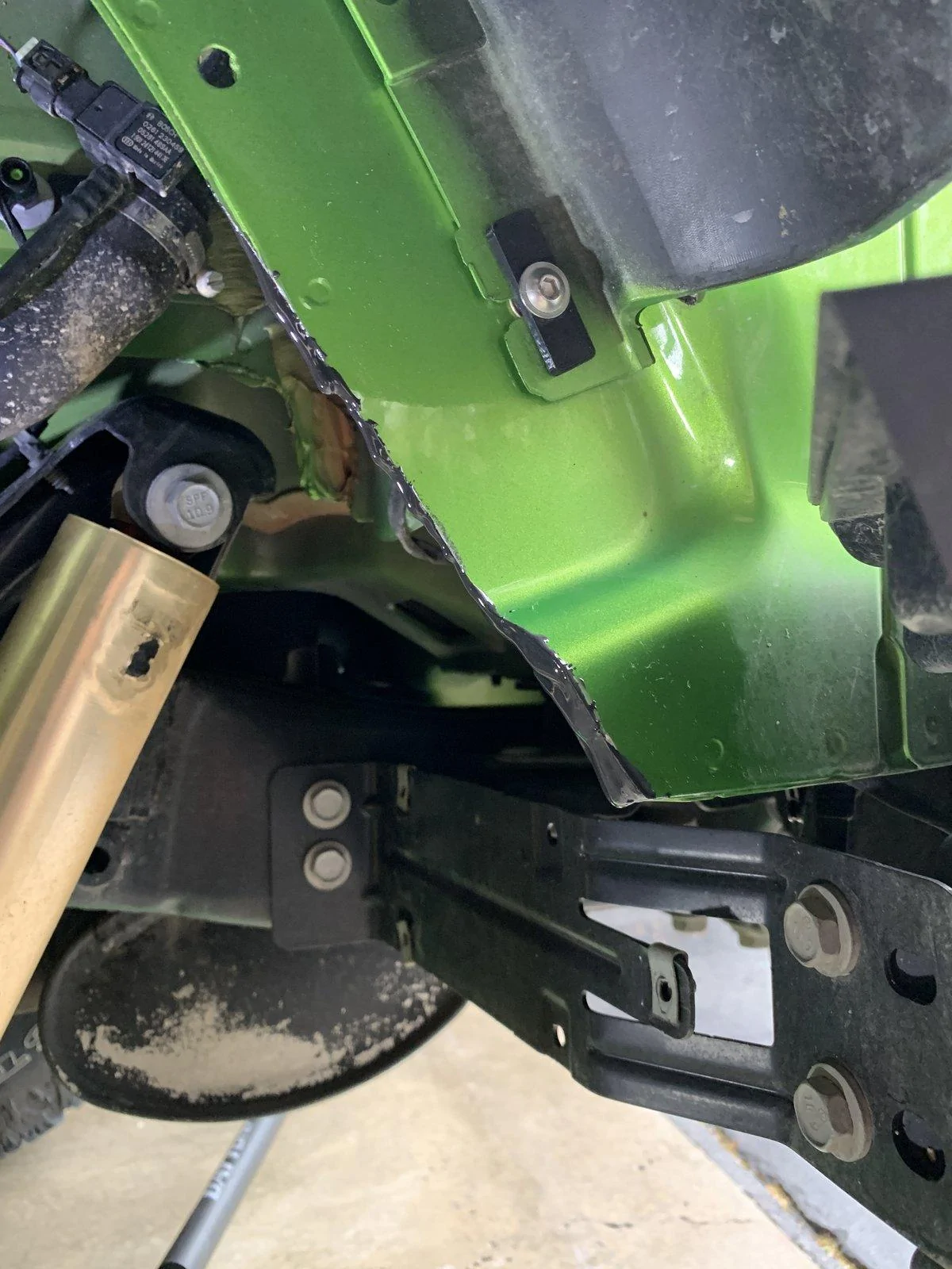

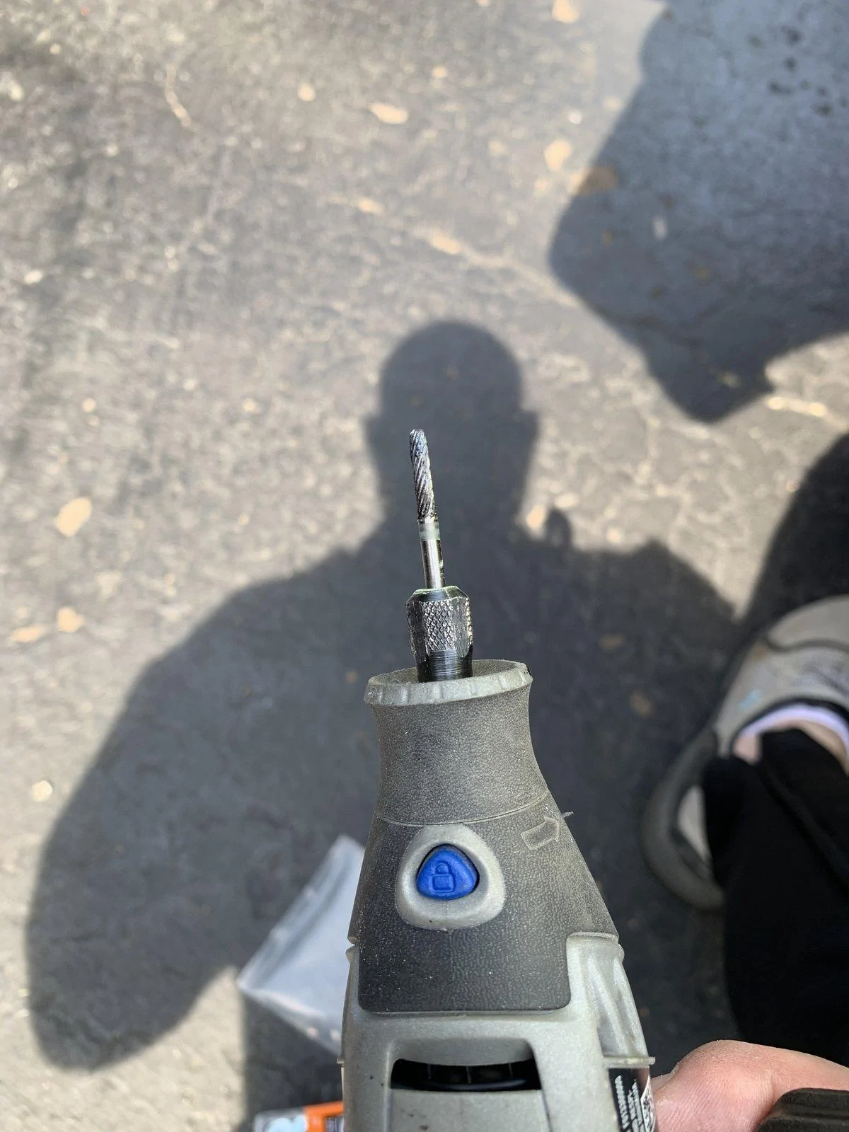

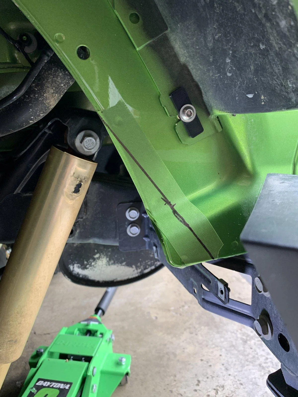

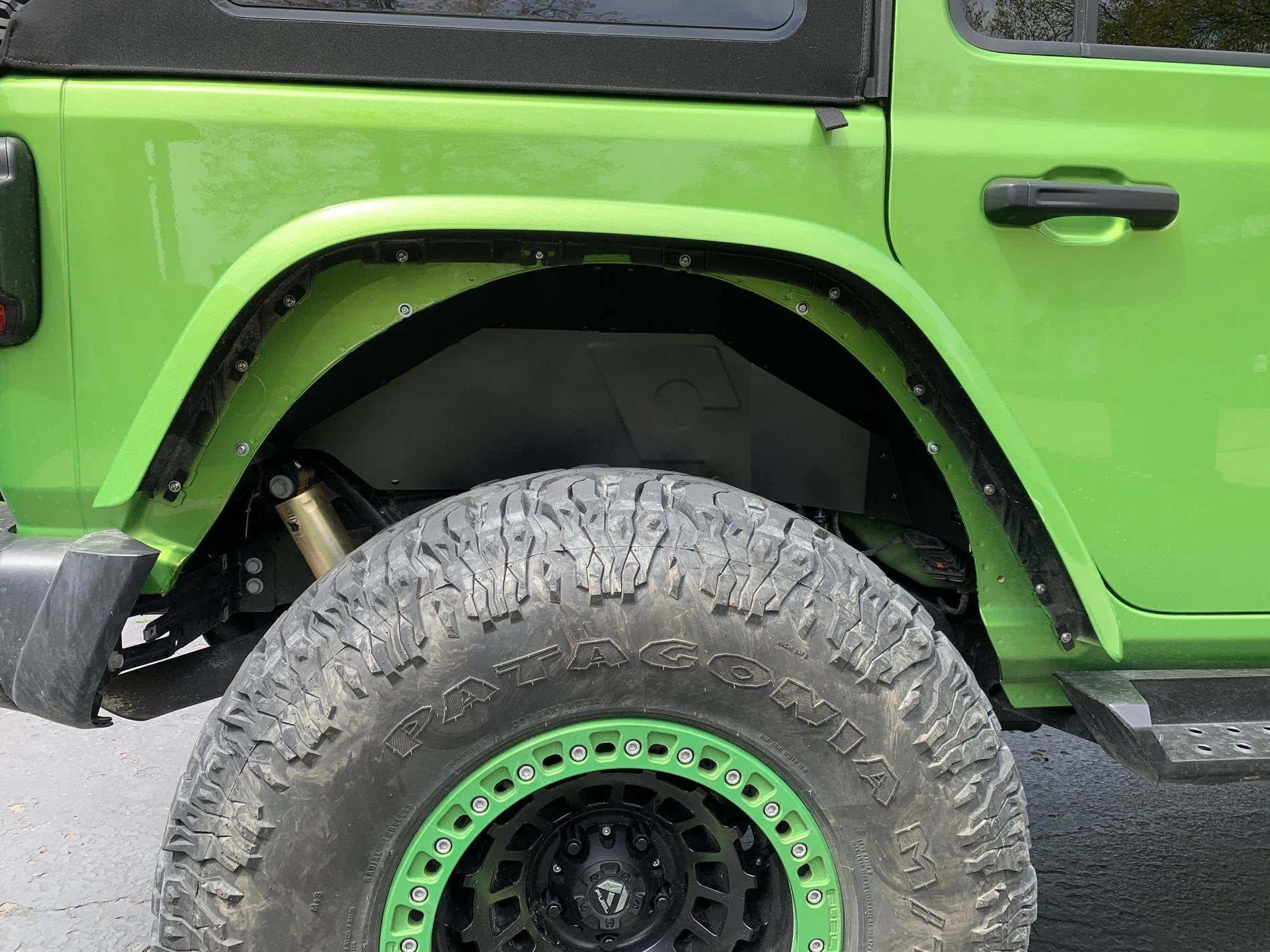

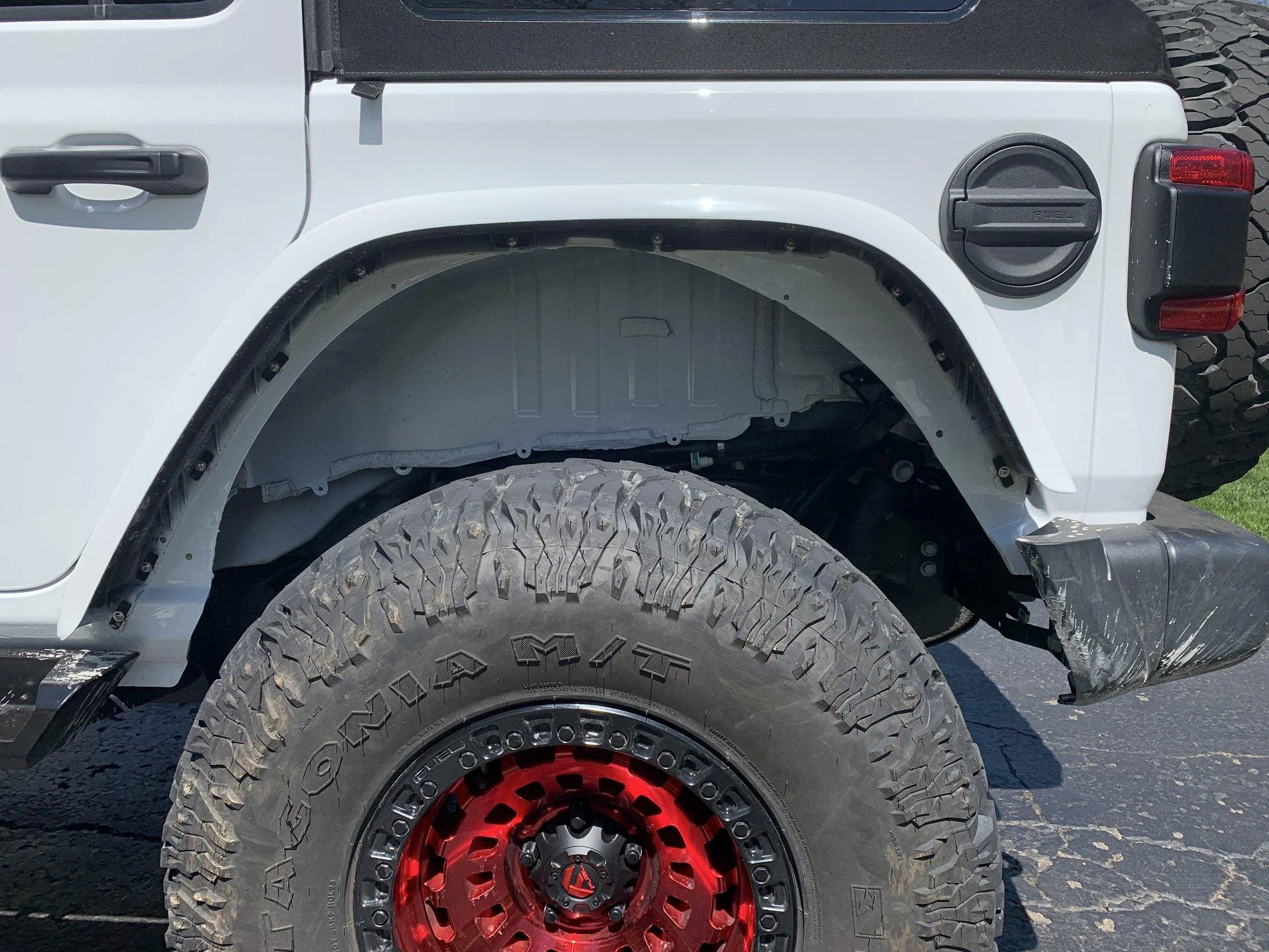

Back to the rear fenders! Based on our previous rubbing, i trimmed the rear fender as others have done. I wanted to try and keep a natural line, so i cut a longer (less gradual) line. I just used a dremmel cutting wheel. (1 wheel per fender). I grinded the edges smooth, used epoxy to fill, re-sanded and painted with touch-up paint. It came out pretty good!
Jeep Wrangler JL JL's JLs Builds IMG_3793
Jeep Wrangler JL JL's JLs Builds IMG_4905
Jeep Wrangler JL JL's JLs Builds IMG_3599
Jeep Wrangler JL JL's JLs Builds IMG_7973

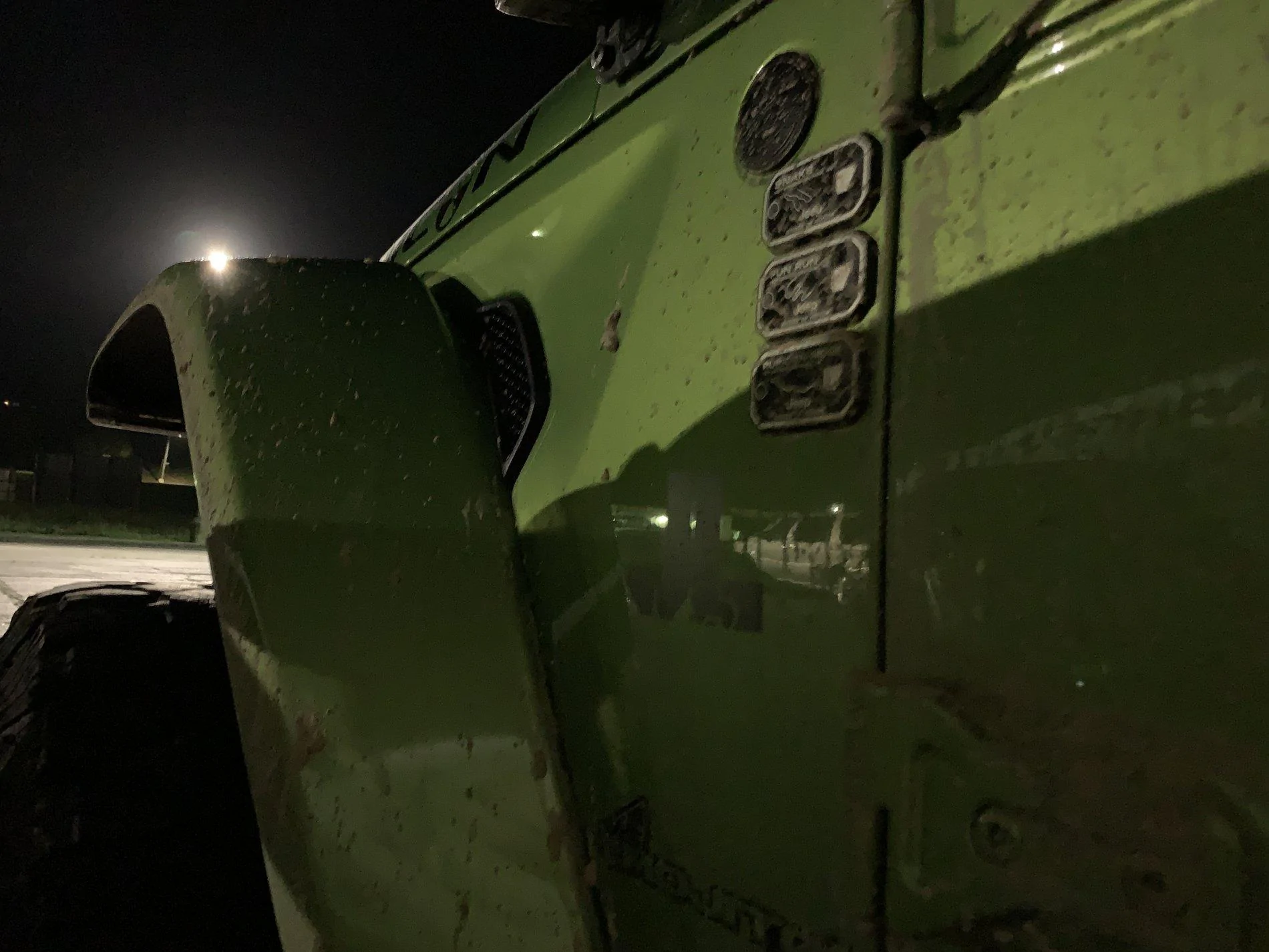

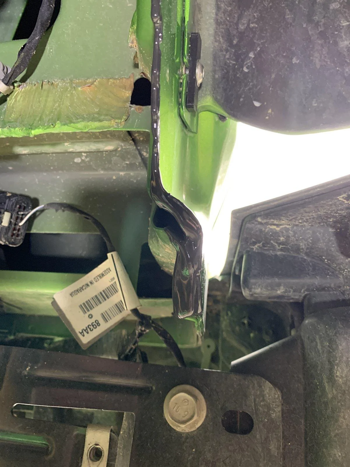

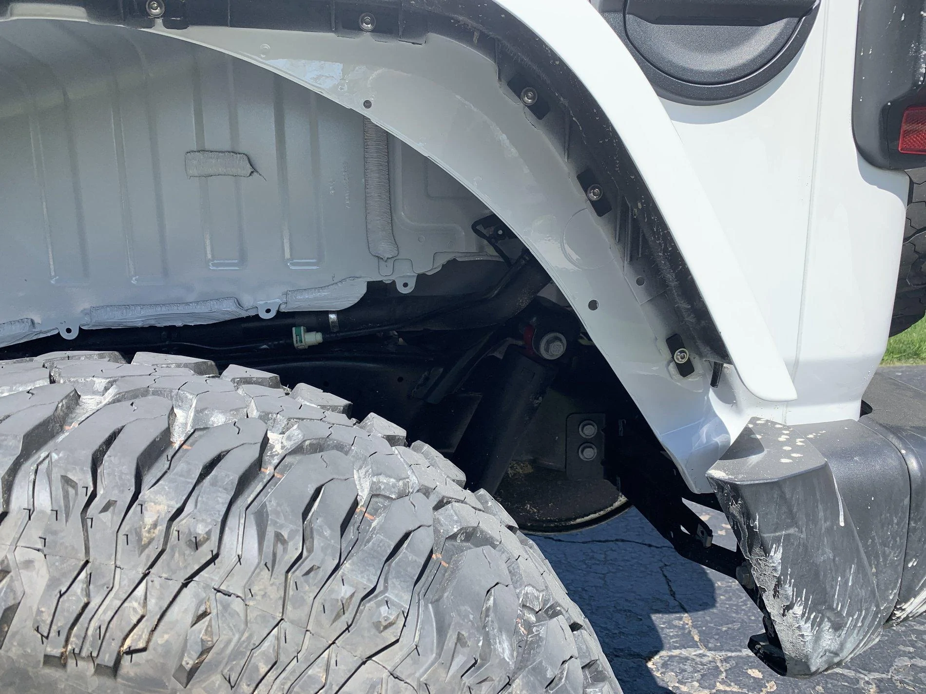

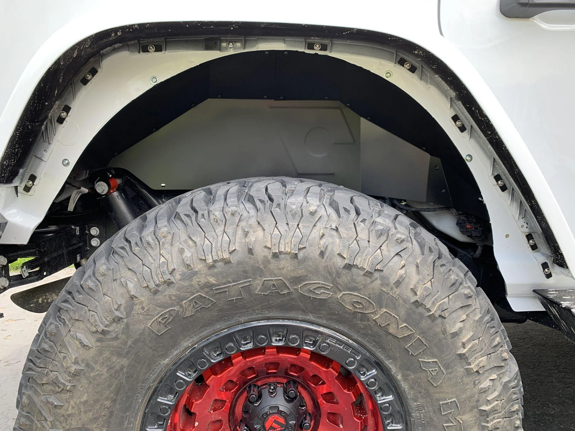

On to the Artec rear fenders.....these were not that easy to install for me. I guess i just needed something to do. The fitment seemed to be a little funky and i didnt use all the bolts, but in the end....they do look good and extremely sturdy.
NOTE: If you are running the AAL fender retention hardware, you will need to do something with one of the rivnuts/nuserts. If you are doing both at the same time, you'll just use 1 less rivnut. I did opt to drill the additional hole, as suggested. For the rivnut: i decided to "kick the can down the road" and deal with it (fully) later. I cut it from the back and ground it down, instead of drilling it out (for now). I used a dremmel cutting bit and a grinding stone.
Jeep Wrangler JL JL's JLs Builds IMG_5771
Jeep Wrangler JL JL's JLs Builds IMG_5772
Jeep Wrangler JL JL's JLs Builds IMG_5769
Jeep Wrangler JL JL's JLs Builds IMG_5770
Jeep Wrangler JL JL's JLs Builds IMG_5773
Jeep Wrangler JL JL's JLs Builds IMG_5778
Jeep Wrangler JL JL's JLs Builds IMG_5779

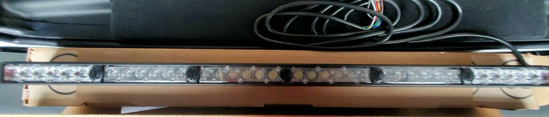

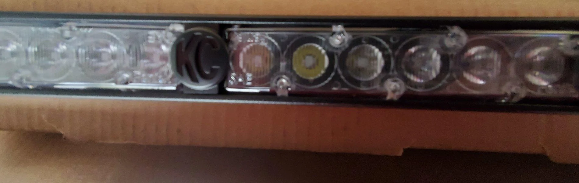

A few more things while I am waiting for my powdercoating and the next stage of my installs here are some pics of my new KC Hilites Gravity Pro6 with custom caps and put in a fire extinguisher, Jeep recovery bag from WARN, and a first-aid kit, and a red antenna.
i think it should stay black but i think the grill should be red! That would look sick and definitely super unique

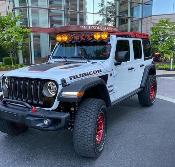

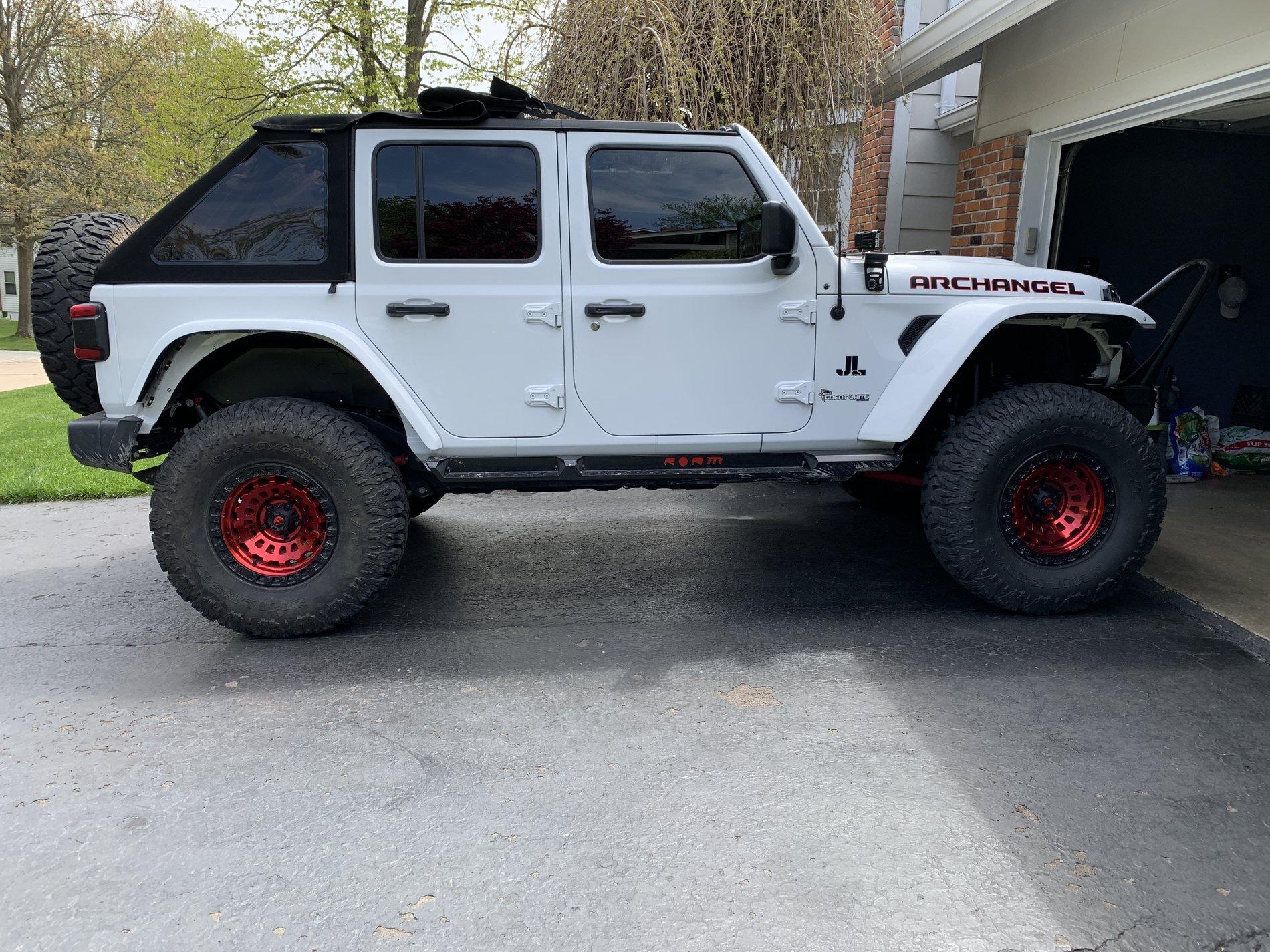

Build updates with the KC Hiilites Gravity Pro6 light bar with powdercoated brackets (white) and EVO roof rack and a KC chase bar (rear)
Jeep Wrangler JL JL's JLs Builds 20200516_101716
Jeep Wrangler JL JL's JLs Builds 20200516_101605
Jeep Wrangler JL JL's JLs Builds KC Hilites installed 3
Jeep Wrangler JL JL's JLs Builds KC Hilites installed 2

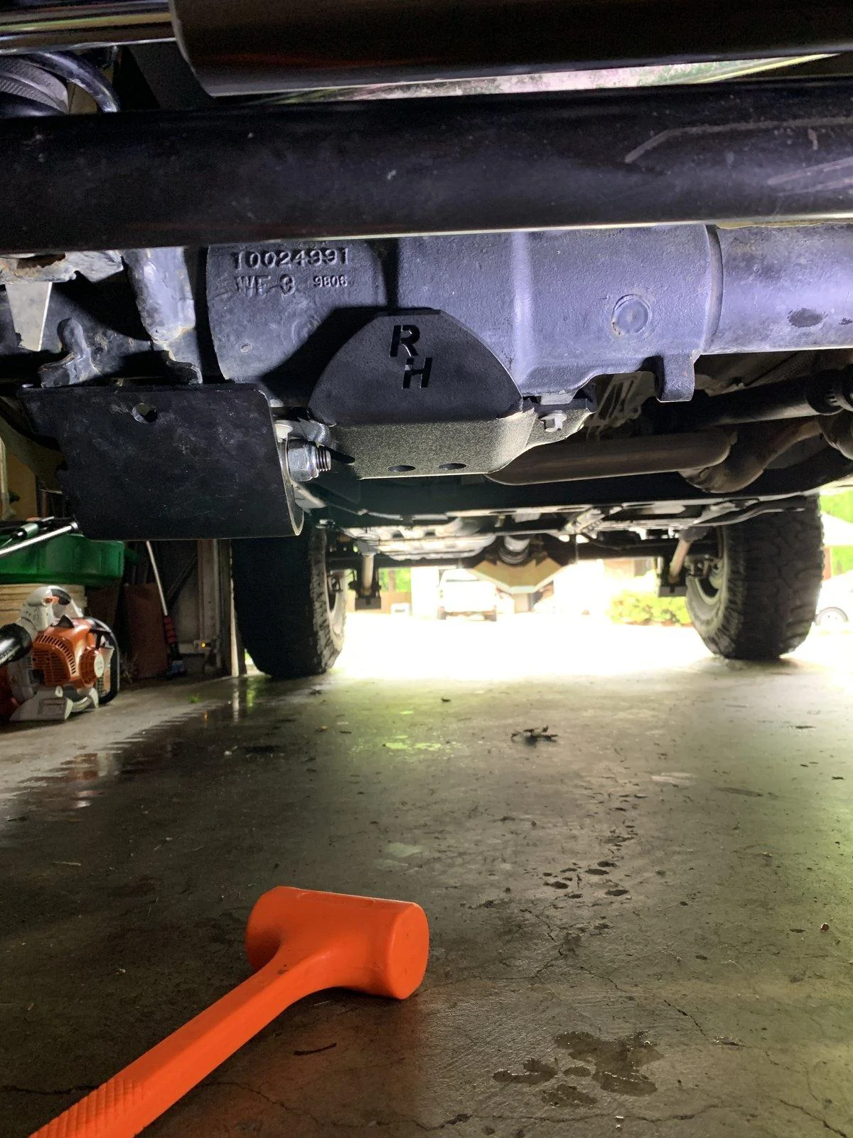

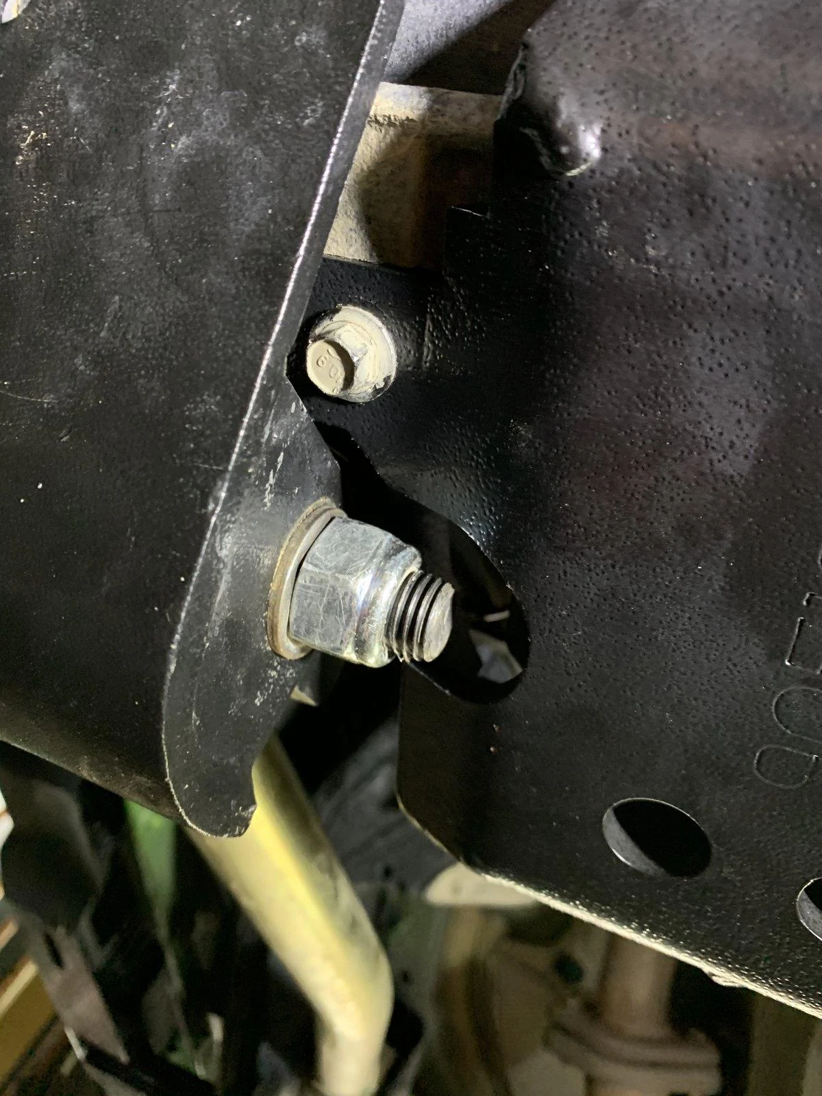

Threw the RockHard4x4 FAD skids on. They fit perfectly with the....well.....RockHard4x4 LCA skids. The MC FAD skid did not fit with the RockHard LCS skids. The only consideration is that I needed to remove the passenger LCA skid before installing the FAD skid. Heavy like the others.
Jeep Wrangler JL JL's JLs Builds IMG_5831
Jeep Wrangler JL JL's JLs Builds IMG_5832
