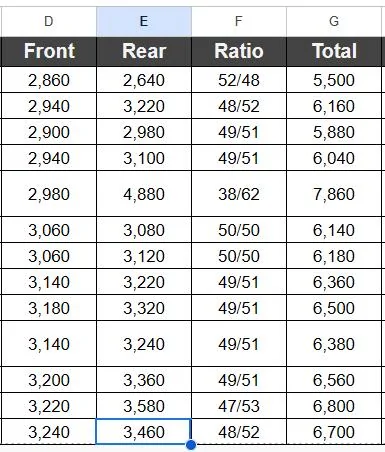

Depends on the load out for a trip, but my 2021 JLU Diesel is roughly 50/50 now. Closer to stock (the first row) it was a little more front-heavy but since then, the rear seat has been removed and replaced with a platform and camping build out that's shifted more to the rear.

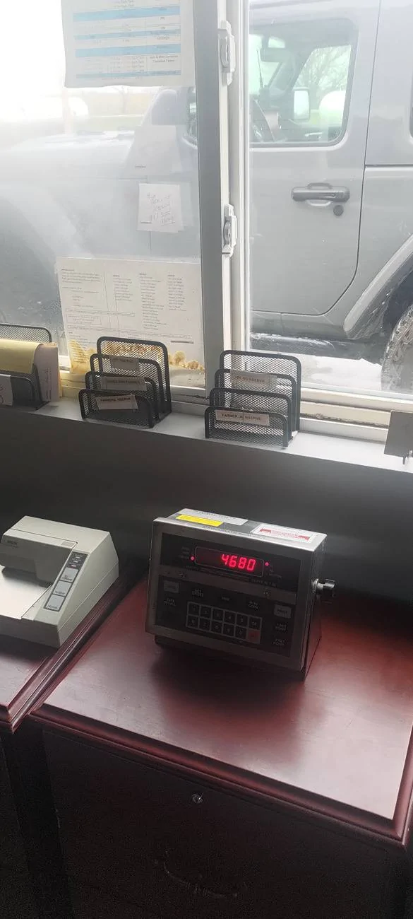

I'd say your at about 52-53% front and 48-47% rear for a Sport with soft top. I've weighed my Rubicon with hard top and it was nearly 50/50 with a full tank of gas.
Jeep Wrangler JL JL weight distribution % 1000006574
That's without me in it, plastic bumpers and backseat installed along with some recovery gear and other odds and ends.

I'm trying to figure out how you determined that your Rubicon was nearly 50/50 from a single number.
