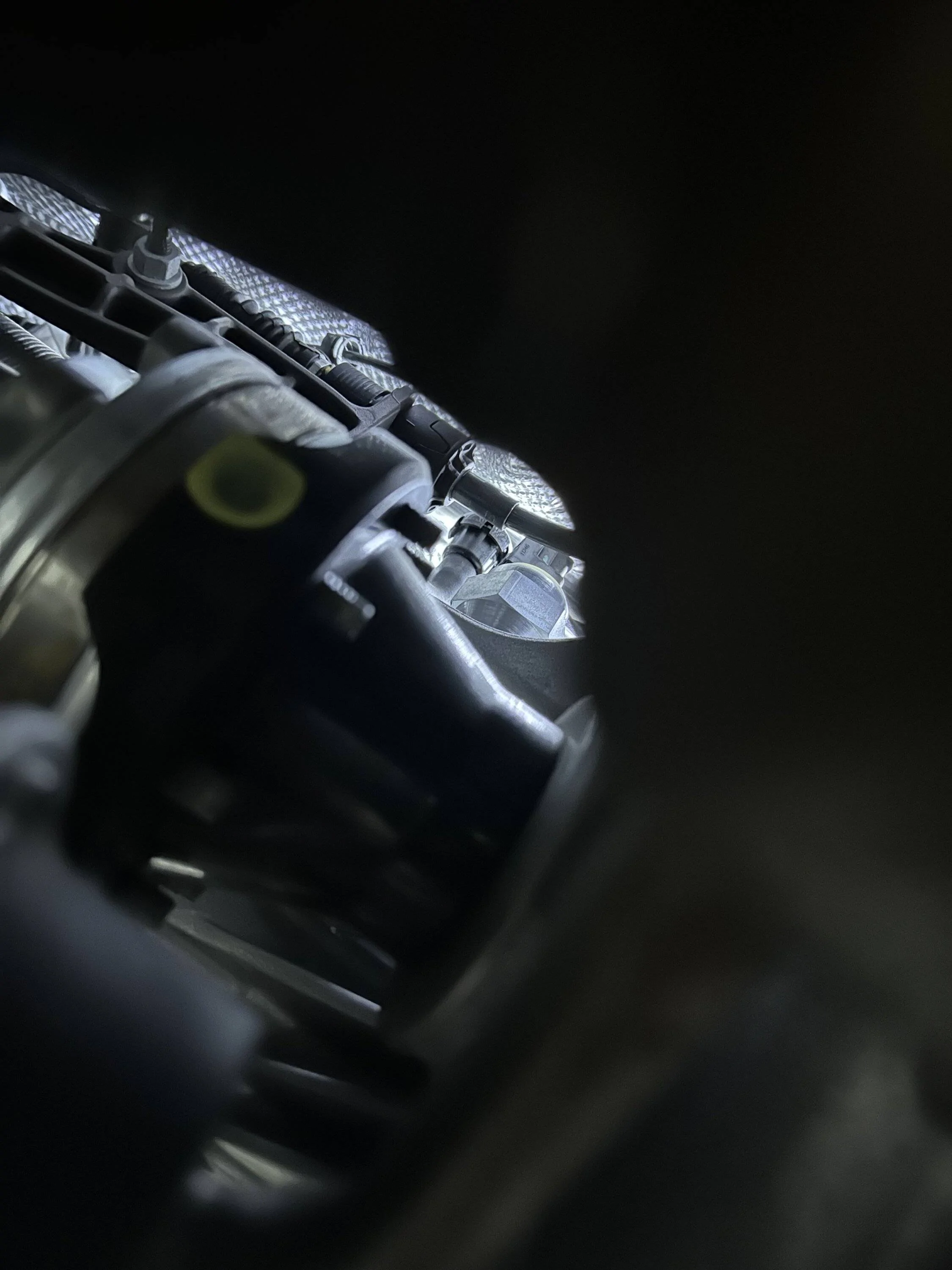

You might want to check where your transfer case vent is. Mine is on top of the transfer case at 27 inches, not the 33.6 water fording clearance Jeep claims. If yours is in the same place as mine I’d say you’d was below the waterline. Look at the picture.

Thanks, i had the checked and also I have ARB breather connected to the diff and transfer case.

I read the cap is a one way breather and designed to not allow water in if submerged. The rear axle breather is mounted pretty low too, but has the same cap.

I seriously doubt that. When pressure starts to build, it raises up. Plastic floats, when it becomes submerged, it raises up. I would still change it. Jeep doesn’t care, and says it is correct. I say bs. It lists the hose and cap at $25. Just the cap is $5. It is your choice $25 or several thousand for a new transfer case and possibly a new transmission.
