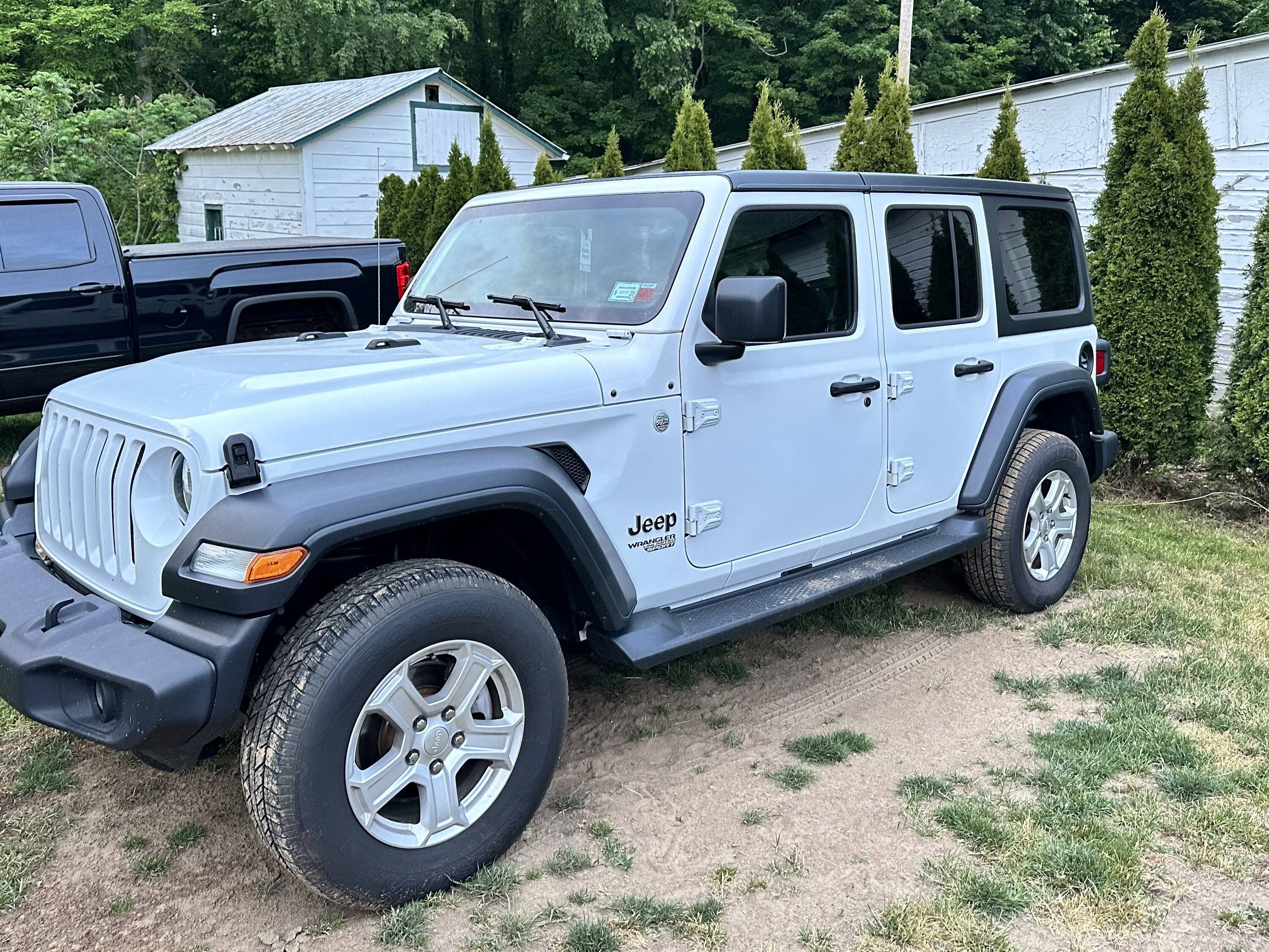

Looking for recommendations for JL speaker upgrades! Just purchased a stock 2020 JL and the speakers are subpar, definitely need something louder. If you could send a link or pics of what y’all upgraded w that’d me much appreciated!! ?

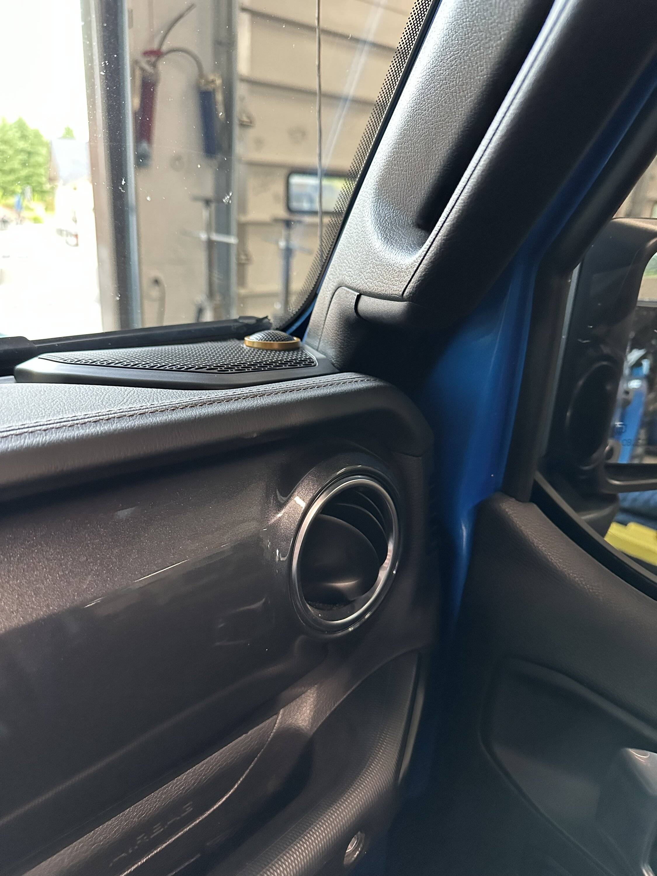

Since the tweeter is part of the grill, you’d probably need that whole piece. Have you asked them??
I got the bronze ones to match my 392 accents. Yes, it contrasts the silver stock look, but I thought the bronze was kinda cool.
Bronze ones look nice!
