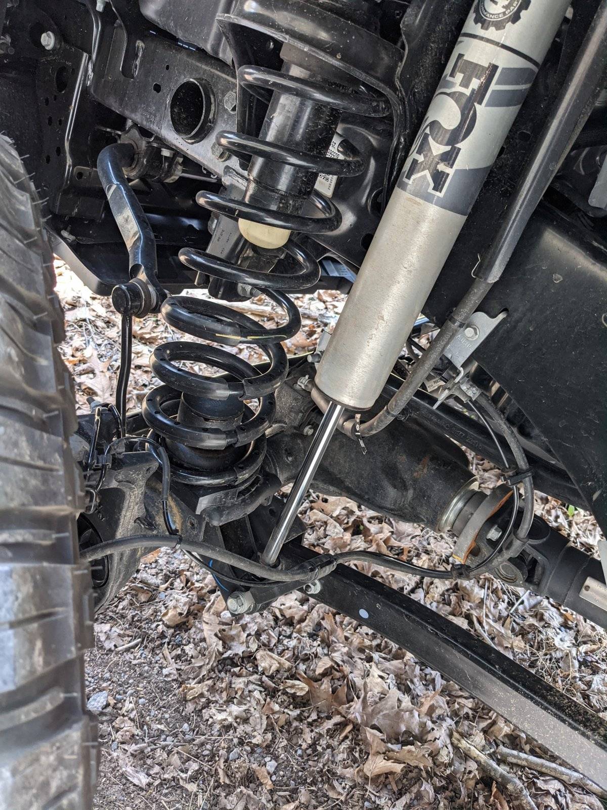

I used the teraflex rubber standoffs to prevent the soft brake lines and abs wires from getting tangled in the shock, knuckle, etc. I placed them on the inboard side of the lower shock mounting hardware.
Thank you for the clarification And the pics.
