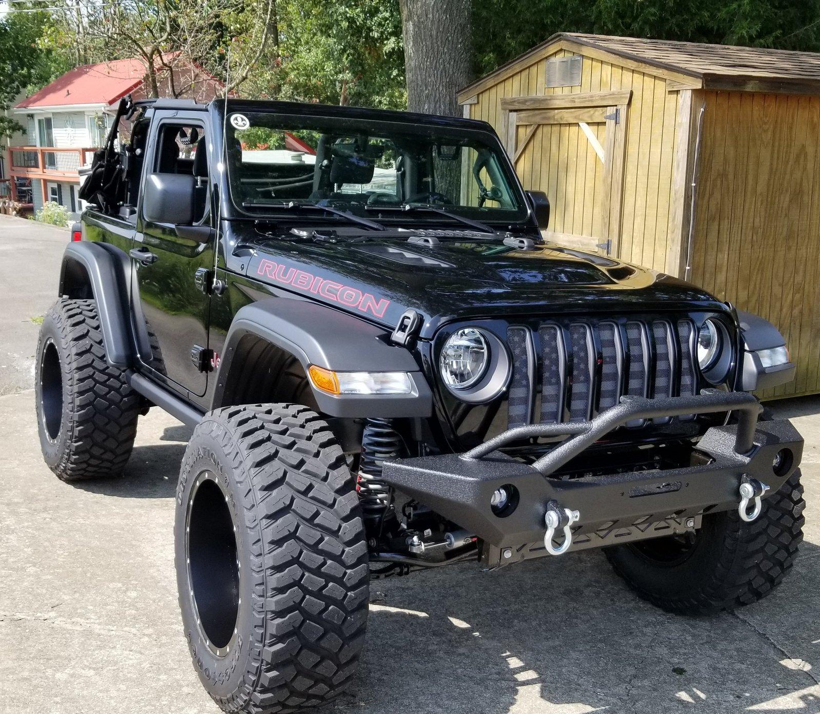

Well, I did not actually measure the height change. In my opinion the lift is a real 2 inchDo you happen to know how much actual lift the dynatrac kit ended up giving you over stock?
Thanks. I have an email out to dynatrac to see if they have a number on how much lift to expect on a 2 door. We'll see what they say.Well, I did not actually measure the height change. In my opinion the lift is a real 2 inch
lift. I added the .50 Teraflex spacer to compensate for the bumper and winch I put on. In hindsight a .75 spacer would have been spot on.

Pics aren't fully up to date, as many mods completed after weather rolled in. Below is the master spec and mod list:
2018 Jeep Wrangler JL Rubicon 2 door
2.0l 4 cyl turbo
8 speed automatic
Electric Infotainment Sys Group
Remote start system
Premium Black Sunrider Soft top
Aftermarket mods
Suspension
Rough Country Stage II 3.5" lift w shocks, extended control arms, and U joint drive shaft
Firestone Destination M/T II 37x13.50R20
20" XD Series Grenade black wheels
Speedometer Re-Cal
Exterior
Ace Engineering license plate relocation w/ B-Up camera mount, LED lic pl light, and 3rd brake light
Barricade Adventure HD front steel bumper
N-Fab Rock Rails with step
Under the Sun Blacked out Distressed Old Glory Grill Insert
Jeep vanity plate with B & W American flag
Clay block cleaned and Ceramic clear coated
Door edging
Door Windows Tinting
Silver RUBICON decal on tailgate
Hurricane decal on hood
Carbon Fiber License plate frames
Interior
Weathertech Front floor liners
Weathertech Cargo liner
Black door entry tread Sills
36 x 48 Cargo net
qty=8 12" bungee ball tie backs
Mopar Grab Handles
Touch screen protector
Cellphone mount and routed cell phone cable
Amazon Echo Dot
Bartact tactical cordura black/red Seat covers
Molle storage bags
Zahal tactical Molle mount hand gun holster
Lighting
LED fog lights
LED Bugeye headlights
19" Bull bar LED light bar
Jeep brake light receiver plug
Towing
Trailer Towing Class III 2" hitch Receiver
2" Trailer Hitch w/ 8" drop
Trailer wiring and 4 prong plug mount
Recovery
Smittybilt 9500 lb waterproof winch
Tie down chain w hooks
Tree Saver strap
Tow Strap
Two (2) 13500 lb snatch blocks with 7/8" corbels
Come-along
Collapsible Shovel
Summer time top/doors off
Safari Rear view mirrors
Jeep/Mopar cab cover
Ace Eng. Front door storage hangers
Self-made Soft top window storage out of towels and paracord
Miscellaneous
Black Canvas tool bag
Molle First Aid Kit
Portable Step Stool
Dash Cam w aux rear security camera
Hatchet
Survival knife
To Come:
· Tonneau/Duster Cover
· Alien Sun Shade
· Targa Bikini
· Wrap around Windjammer
· 2” Receiver Spare Tire Mount
· Steel Rear Bumper
· Backup Lighting
· Under vehicle rocklights
· On board air compressor
· HiLift Jack/mount
· Taser JL
· Front facing camera
Actually the quality was very good, especially considering the low price point. The powder coating looks good, is of a good uniform thickness. no fish eyes or orange peel anywhere. No edge coverage issues or adhesion problems. From a fabrication standpoint, the welds look nice, have good penetration, and the mounting brackets were accurately located--made mounting pretty easy. The slots for the winch mounts mated up fine, as well, no issues mounting the winch.Jeep looks great. How is the quality of the Barricade Adventure frt bumper? Powder coating etc look like pretty good quality?

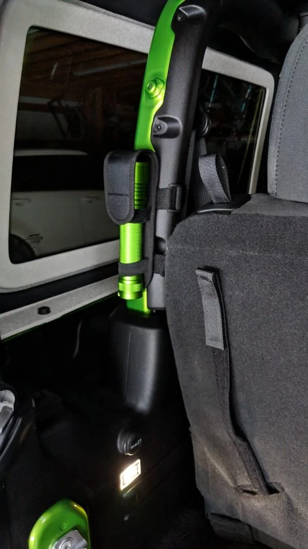

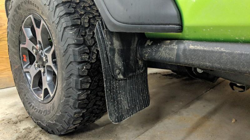

Loving your Mojito accents.I painted the hub part of the disk break.
Matching Flashlight.
Home made mud flaps.
Green Jeep on my phone case.
My alter ego.
