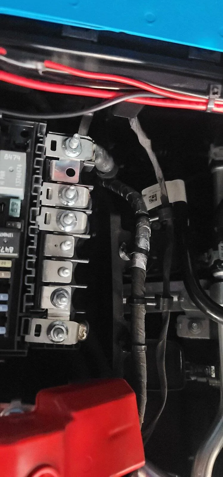

I know the thread is old, but hopefully someone else wil see this and it might help them. If it should be somewhere else let me know or post it for me. I have a 2021 Wrangler Rubicon that I bought just over a month ago. This weekend my wife was driving and the dash freaked out, literally every warning came on and once the car shut off it wouldn't start again. I've heard of people losing power steering and stalling, while trying to figure out what my issue was, but that did not happen to me. The jeep was driven home with all the warning lights on and parked. I came across this forum and used the advice and checked my fuses. This was quick and easy, with all the fuses checking out. I then read about this similar issue in regards to the Aux battery dieing causing the jeep to go wonky. So I pulled the main battery and fuse box and checked for the Aux battery......there was nothing there. Being a brand new jeep owner I was shocked to find out there was an Aux battery, I was then even more shocked when the compartment was empty. Further research told me that the N5 terminal was my positive lead for my ESS and N2 was my Aux battery. I also found out you could access the Aux battery from the fender well, FYI much easier. Once again brand new jeep owner I thought huh my 2021 has the battery that you need to access through the fender well. So I did. I popped of the fender well, found and opened the compartment, and there was nothing there. This is when I knew I fuc$*d up.....they were indeed the same compartment but for some reason a small part of me wanted to find an Aux battery. Also thought someone may have stolen the Aux battery because the fender looked like it had been accessed before; the plastic rivets did not go through the tire well rain guard. So after a day of scratching my head, metering voltage, checking grounds for tightness, and research; also finding out there is no Aux battery on a 2021 (FYI Jeep used a metal jumper between N1 and N2), I decided I'd call the dealer and have them fix it. I put everything back together, and when I reconnected the negative battery and tightened it I went ahead and grabbed it to check the connection...it rotated 45 degrees and popped off. I slid it back on rotated it the other way, at which point it felt like it made a better connection, yes the bolt was tight. As soon as I opened my car door I knew something was different my RPM and MPH bezel lit up as to where before it wasn't, just my center message screen would come on. The Car started right up.... so I made my little sleeve out of tinfoil and slapped around the negative battery post seems to be working.....fingers crossed that was the issue. Hopefully my experience helps.

Can You take a picture of the Jumper? This may be the their new way of dealing with this set up! I have read multiple times of forum members removing the cable from aux and wrapping it and installing the jumper between N1and N2 but have never heard of this being implemented from the Dealer.

Don't you think that it's more likely that his jeep is equipped with the eTorque system instead of ESS?

eTorque system.... is indeed what @Rhadams1986 's JL has..
With eTorque ........and the JL, you will see the factory has placed a solid metal jumper between N1 and N2 in the Power Distribution Center (PDC).
You will also find that there is NO, Aux battery negative cable attached to the Main batteries Neg terminal... you will just see an available stud on the Main battery terminal, with no cable attached to it...
And indeed, the plastic box under the PDC/ hiding behind the passenger fender flare, is there... but does not have an Aux battery in it.. it is just an empty box.

I have the 3.6 with ESS. No explanation yet, I just dropped it off at the dealer. I don't think the 2021s came with one. Looking at the leads on the fuse box it looks like N1 and N2 have a metal plate between them for the ESS, as to where previous ones didnt..... Once again brand new to Jeeps.
And yes, there are also other differences......

The eTorque system isn't a hybrid in the normal sense and doesn't improve gas mileage. Why are you sure that it's the ESS system. Are you the original owner?

The eTorque system doesn't have a second battery under the fuse box. It does have a second battery but it's larger and under the vehicle toward the back.
