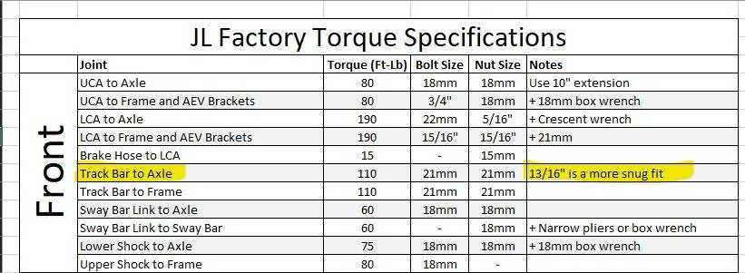

These are my notes for fastener size and torque settings:
Jeep Wrangler JL Jeep specific tools? 1739459393600-70
Dont suppose you would be willing to share that sheet? Ive been meaning to put together a tool kit for the Jeep and every time I start I just get frustrated and give up lol
Sure, I've seen other copies floating around on here somebody else made. I copied this info from the AEV lift install instructions. I also replaced my trackbar bolts with an SAE size but I can't find what the size is =/
Awesome this at least gives me a starting place to sort and figure out thanks!
