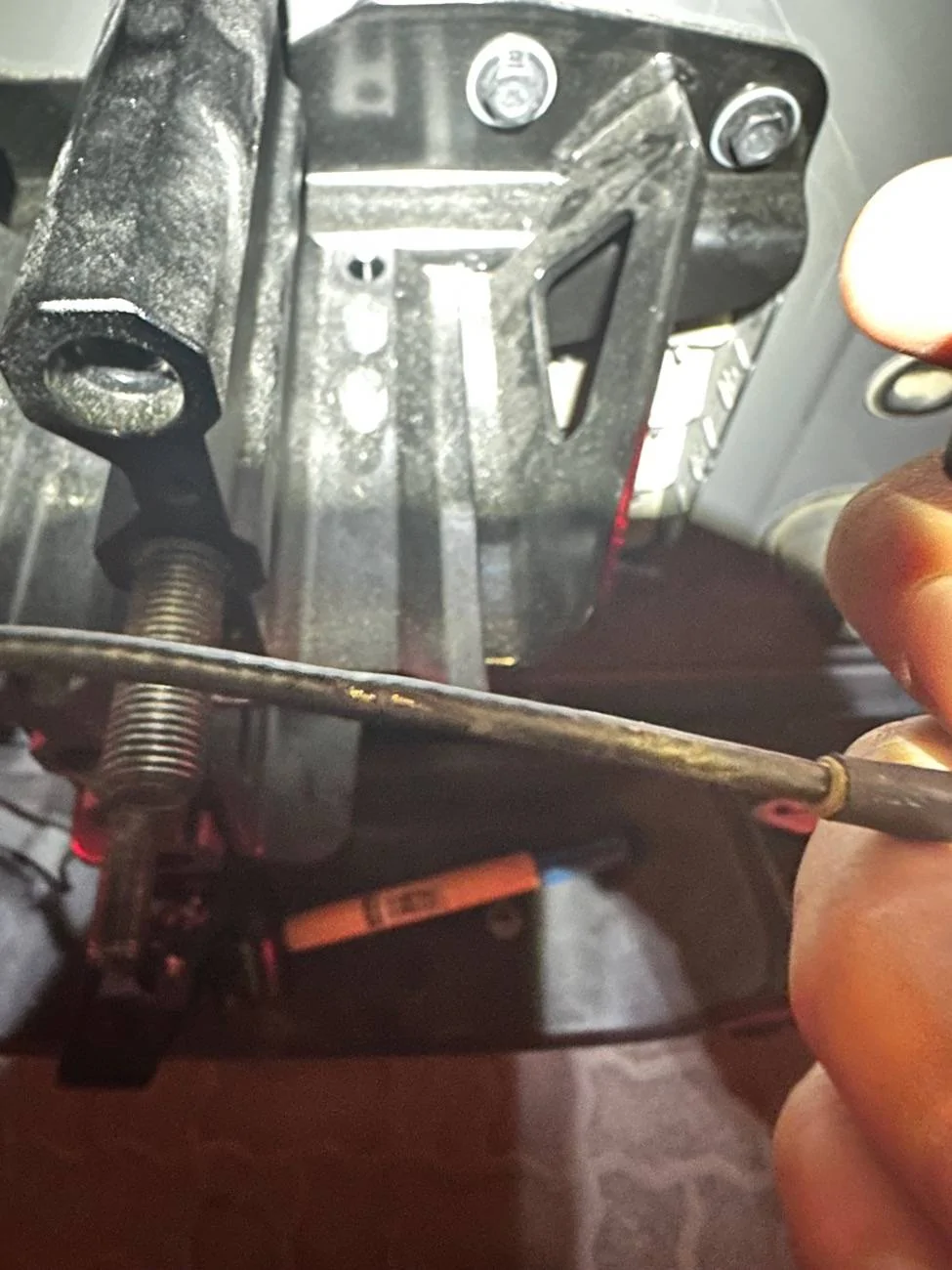

Hey guys and gals,
Hope everyone’s doing great.
I installed my adjustable spare tire carrier earlier today. But then my back up camera failed to work. I think the damaged wire shown in the pic is the problem. I’m new to jeeps and have basic to no electrical knowledge. Can anyone tell me if there are 2 wires (+ and ~) in this harness so i can just cut and reconnect them properly? Just wanna make sure before i do more damage. Thanks in advance.

Hey guys and gals,
It's not an area I have much experience with, but that said:
https://www.jlwranglerforums.com/forum/threads/jeep-jl-wrangler-wiring-diagrams.19185/
Then under this menu:
Backup Camera System
https://www.jlwranglerforums.com/JL-Wiring-Diagrams/BACK-UP-CAMERA-SYSTEM.pdf
might be a good starting place.
