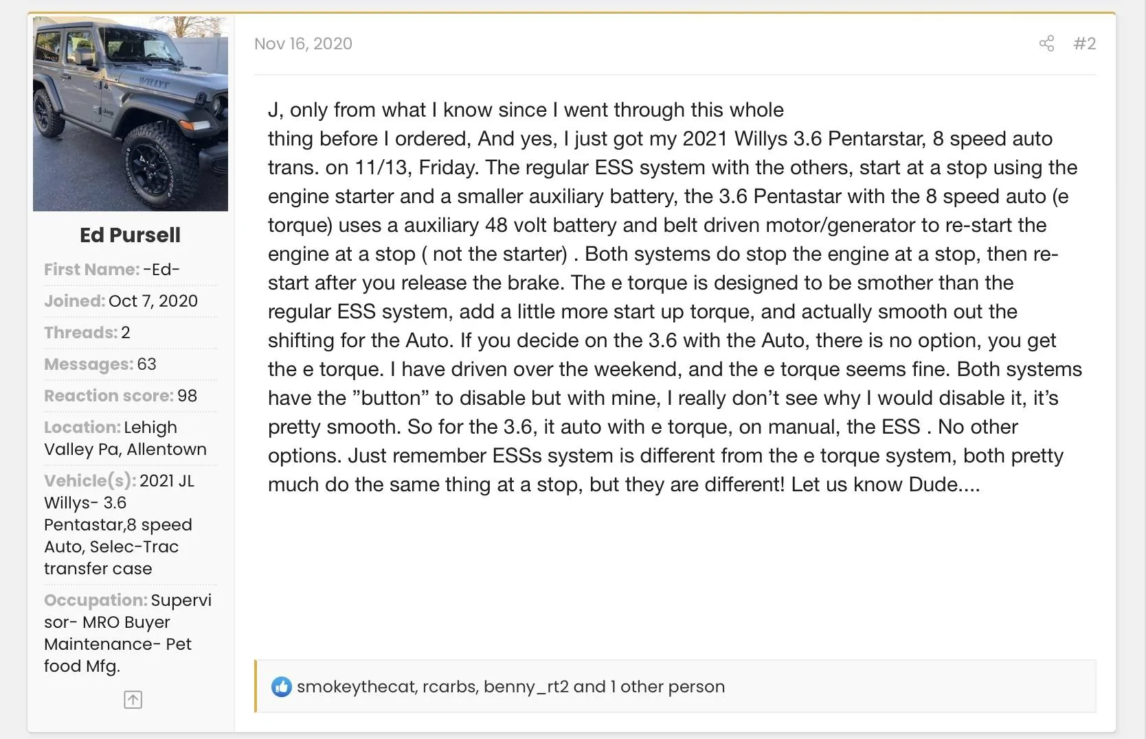

Here is a post about the difference in the engines!
Jeep Wrangler JL Jeep called! 8889FEDB-646E-48A3-BCF8-DC1039DF12A6

I also got this call today, any ideal about the difference of the two engines? Check your call, on my call she said it would be built with 3.6L ESS not the 3.6L BSG.
I might have mixed them up when she called because I was quite confused at the difference in the engines. Thanks for the info!
