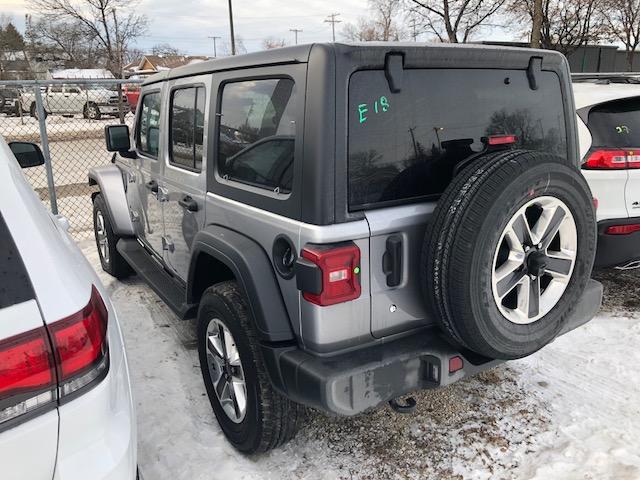

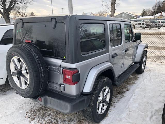

Reported Jan 20, 2018: Mixed-finish fenders in delivered JLU: https://www.jlwranglerforums.com/forum/threads/how-does-this-get-through-quality-control.3041/
Photo credits (from original thread): warc1
