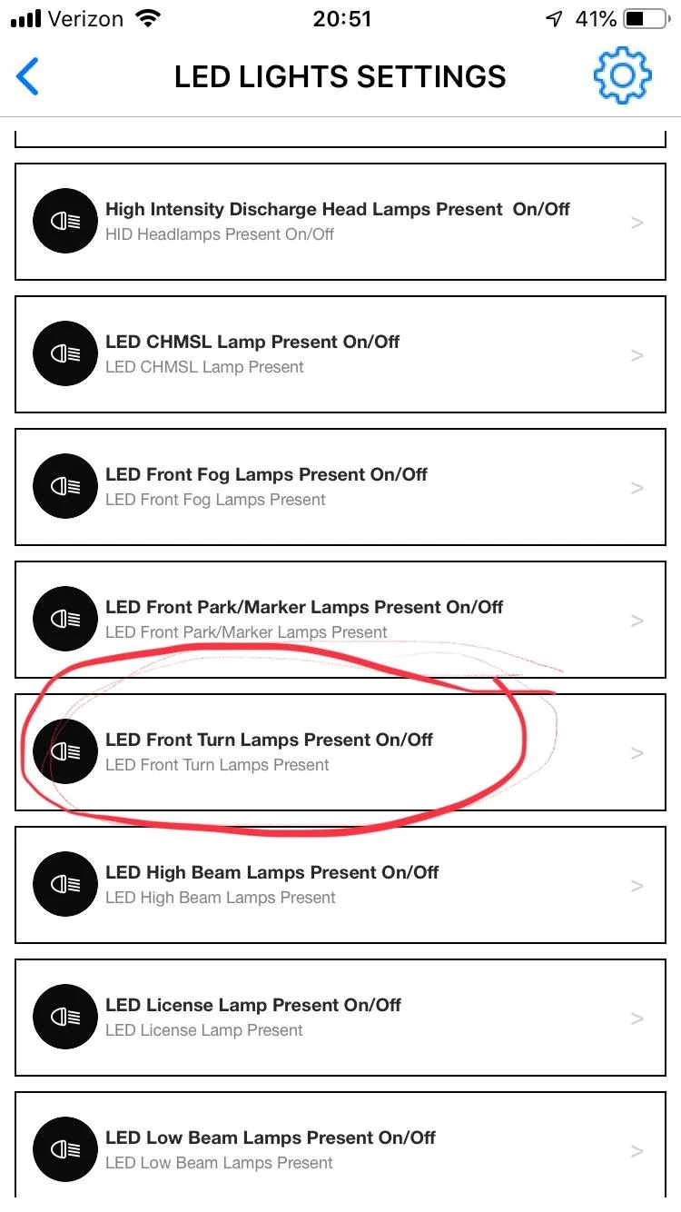

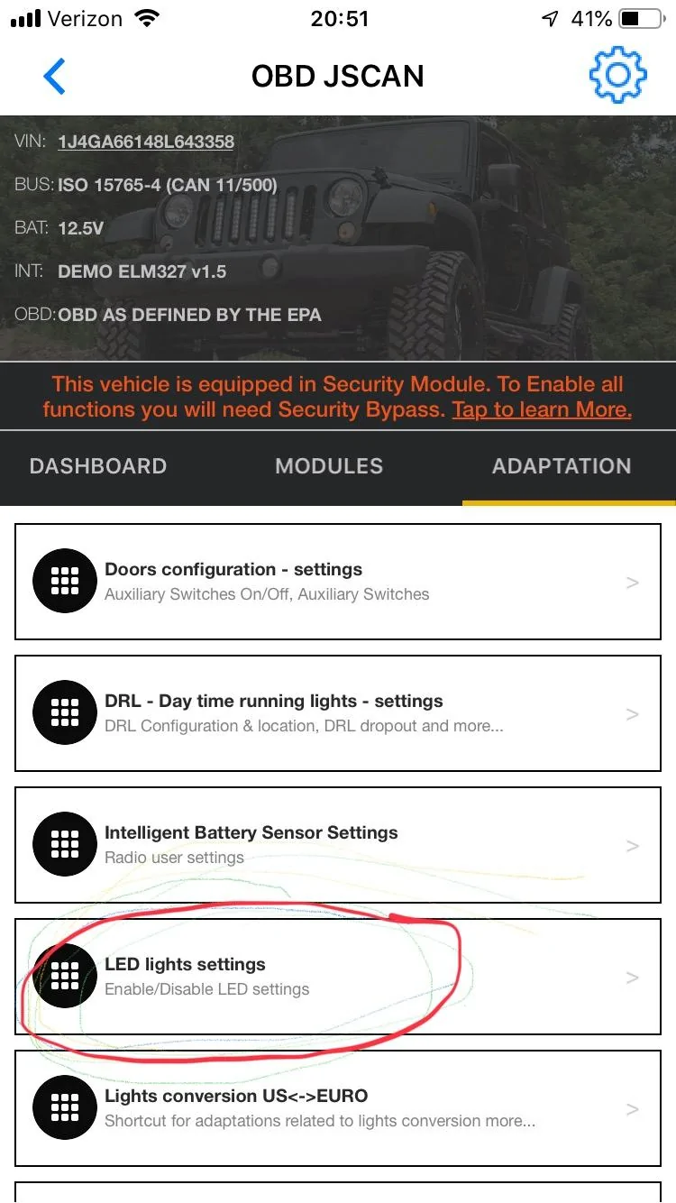

Thanks I’ll reach out to him. These are my current codes, and current drl settings
Replyed to your pm. The LED turn signals don’t draw enough current so the BCM thinks they are out. Change the settings for LED turn signals here and that should fix it.

So, I have updated everything to reflect properly. I have also turned off front turn light diagnostics.
When I reset all ECU’s, the code will not populate for about 15-20 minutes, at that point the turn signal lights out message appears again.
Another thing I have thought about changing is the light draw settings, has anyone done this to any success?
