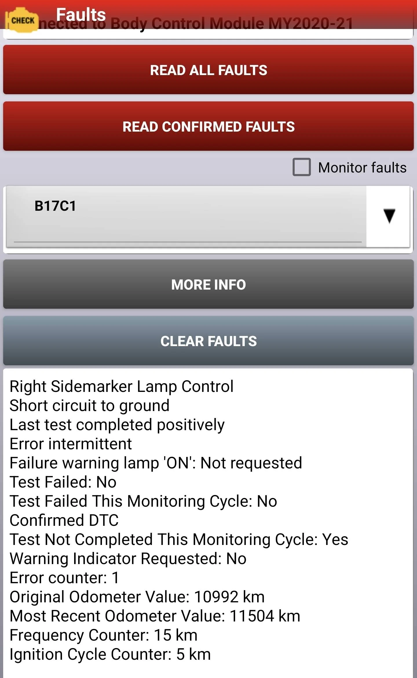

2. You've still got codes if you scan:
This has been posted before, and is the cause of that:

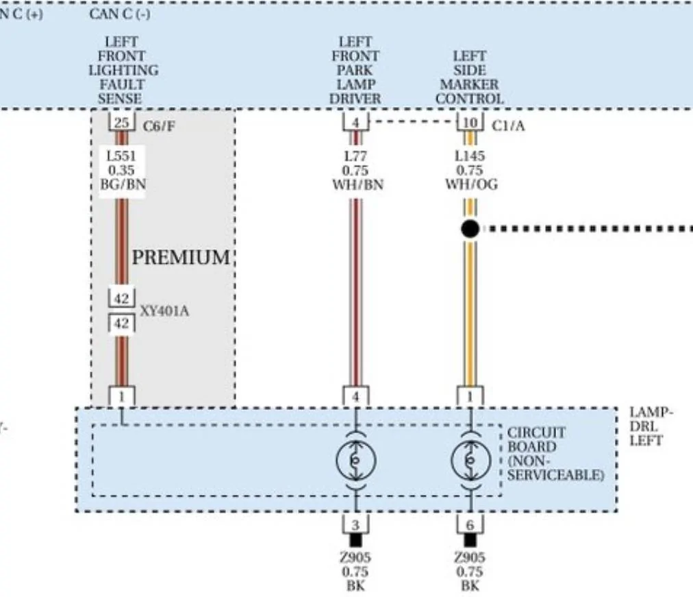

Pin 1 of the DRL harness on a factory LED truck is a fault sense wire, and runs to BCM pins 25 and 28 of BCM C6/F, 1 per side. Pin 1 of a factory halogen truck is the side marker control circuit, and runs to BCM pins 5 and 10 of BCM C1/A, 1 per side.
Now - you can run these wires if you want, by depinning and taping off Pin 1 of the body harness side of the DRL connector, and running a new wire per side to connector XY401A WAYYYY deep in the dash, or directly to the BCM C6/F connector. All you gain is the truck will sense when a light is out and tell you. Not worth it to me...I'll see they're out from the reflection in front of me at a stoplight.
So - you still have the faults when you scan. Simple - depin Pin 1 from the DRL harness, DRL side. Video I made:
Cliffs:
1. Turn off the 3 Diagnostics settings for turn lamps.
2. Depin Pin 1 from the DRL light harness.
No hyperflash, no dash errors, no codes, no wires going to the wrong place.
