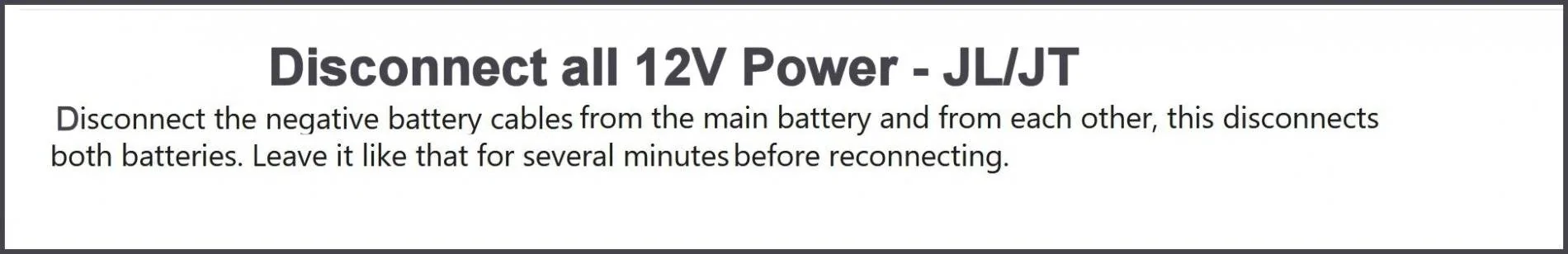

@Laguna22
Since lights all work, I'm not sure why you have "fast flash and my dash still says the light is out. "
All you had was a damaged tail light that you unplugged and then replaced with a new LED tail light....
You might try disconnecting all 12v power for a few minutes say 15 minutes then reconnect power... Here is how to disconnect all 12v power...
Jeep Wrangler JL Help with OEM LED tail light issue Disconnect 12V Power

Well, disconnect power didn't help, but time did. In the middle of a drive yesterday, signaling returned to normal speed, and now the error message about the bad bulb is also gone. I think something must have needed to dry out some more. But I'm all set! Thank you for your help.
