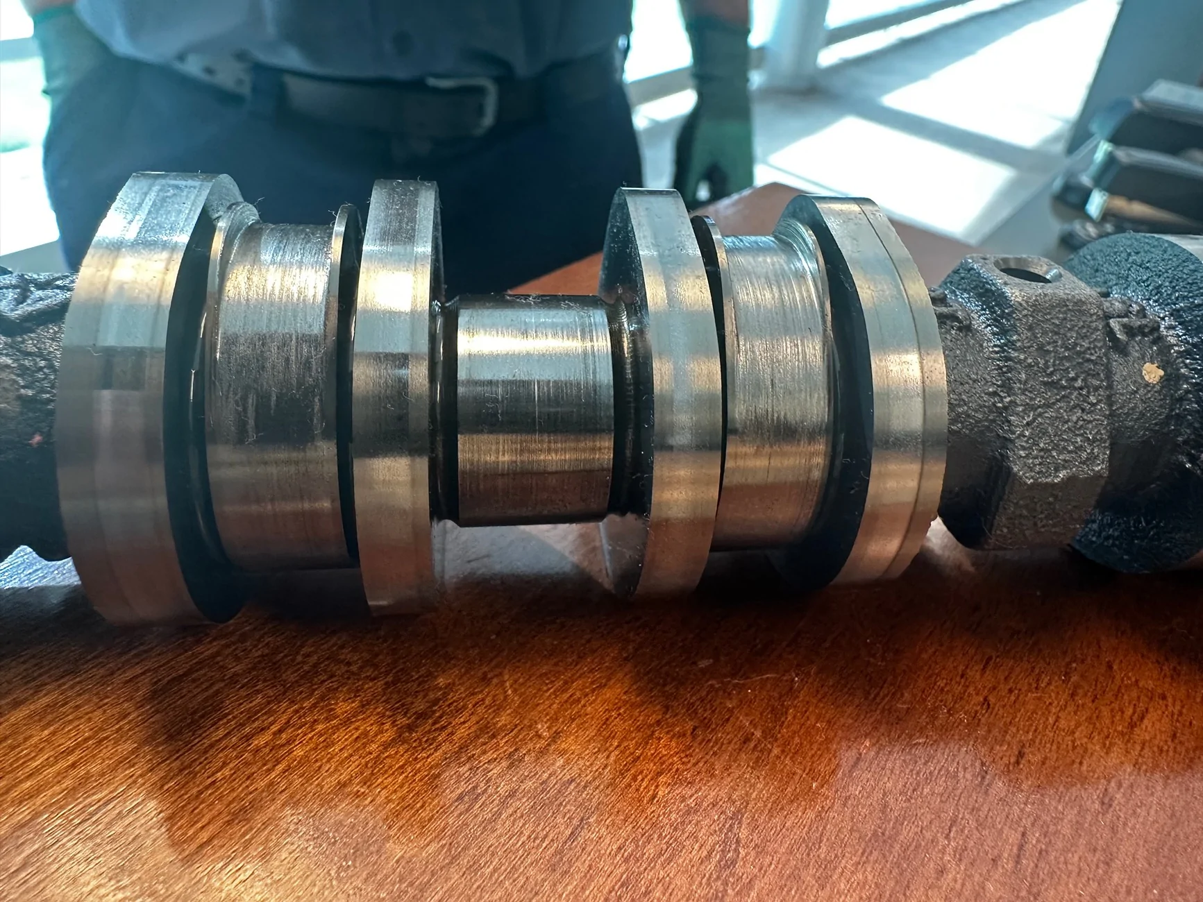

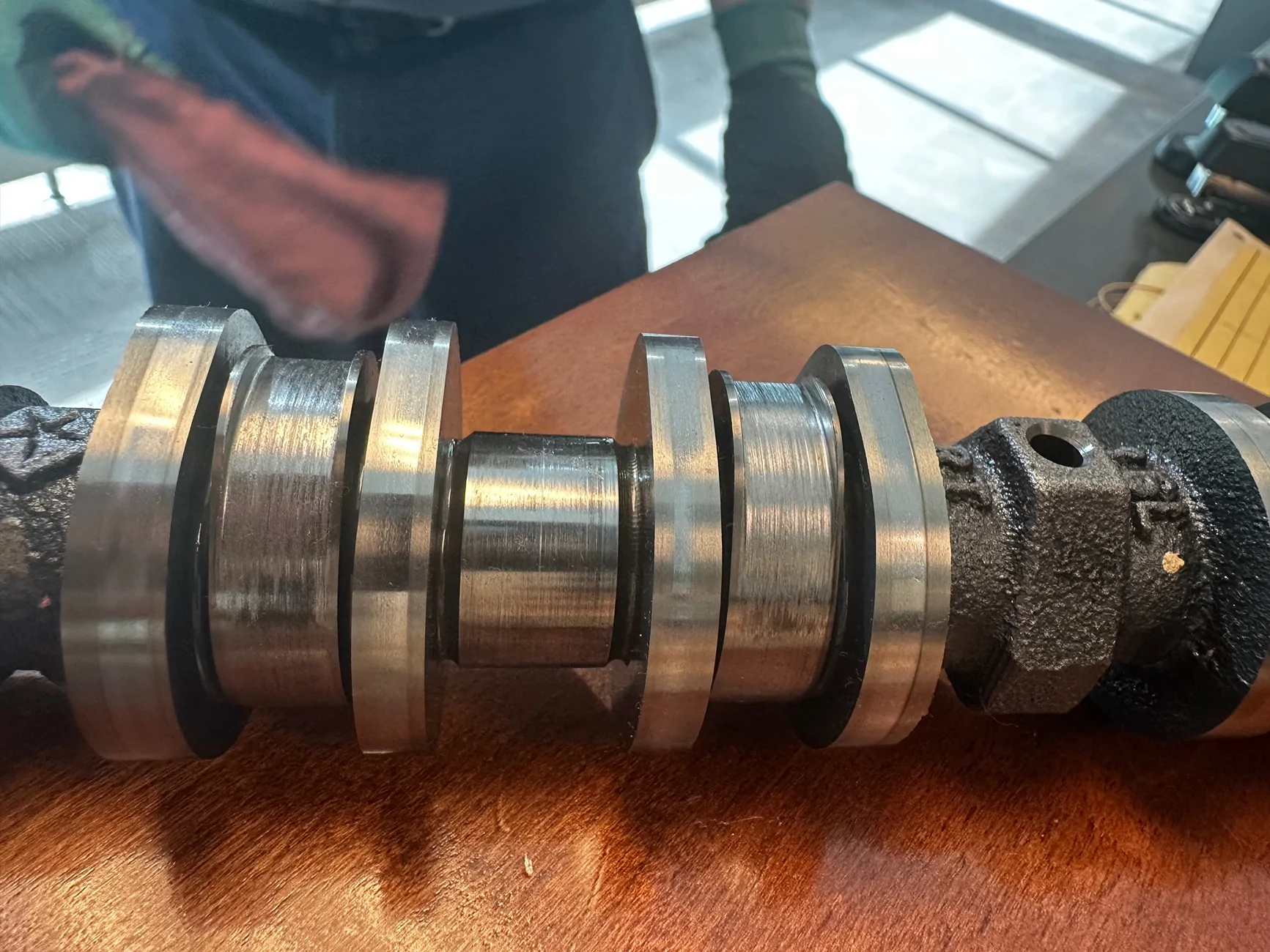

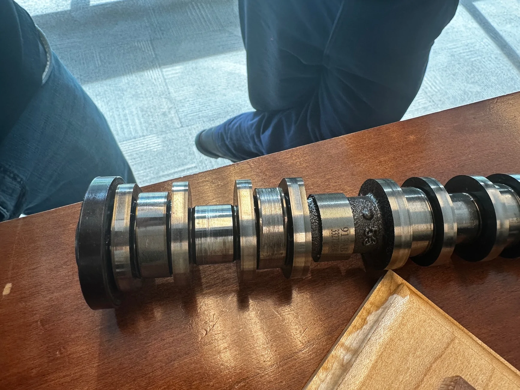

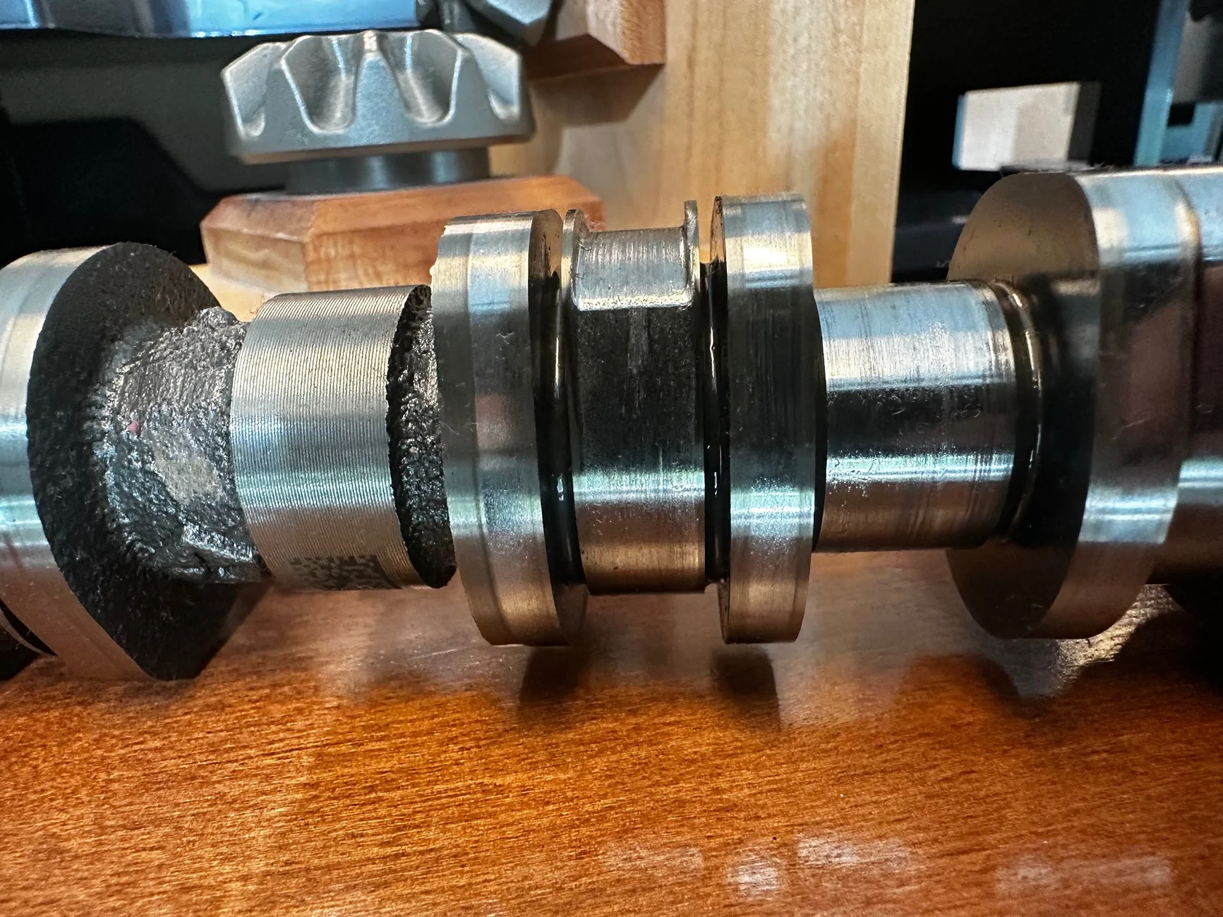

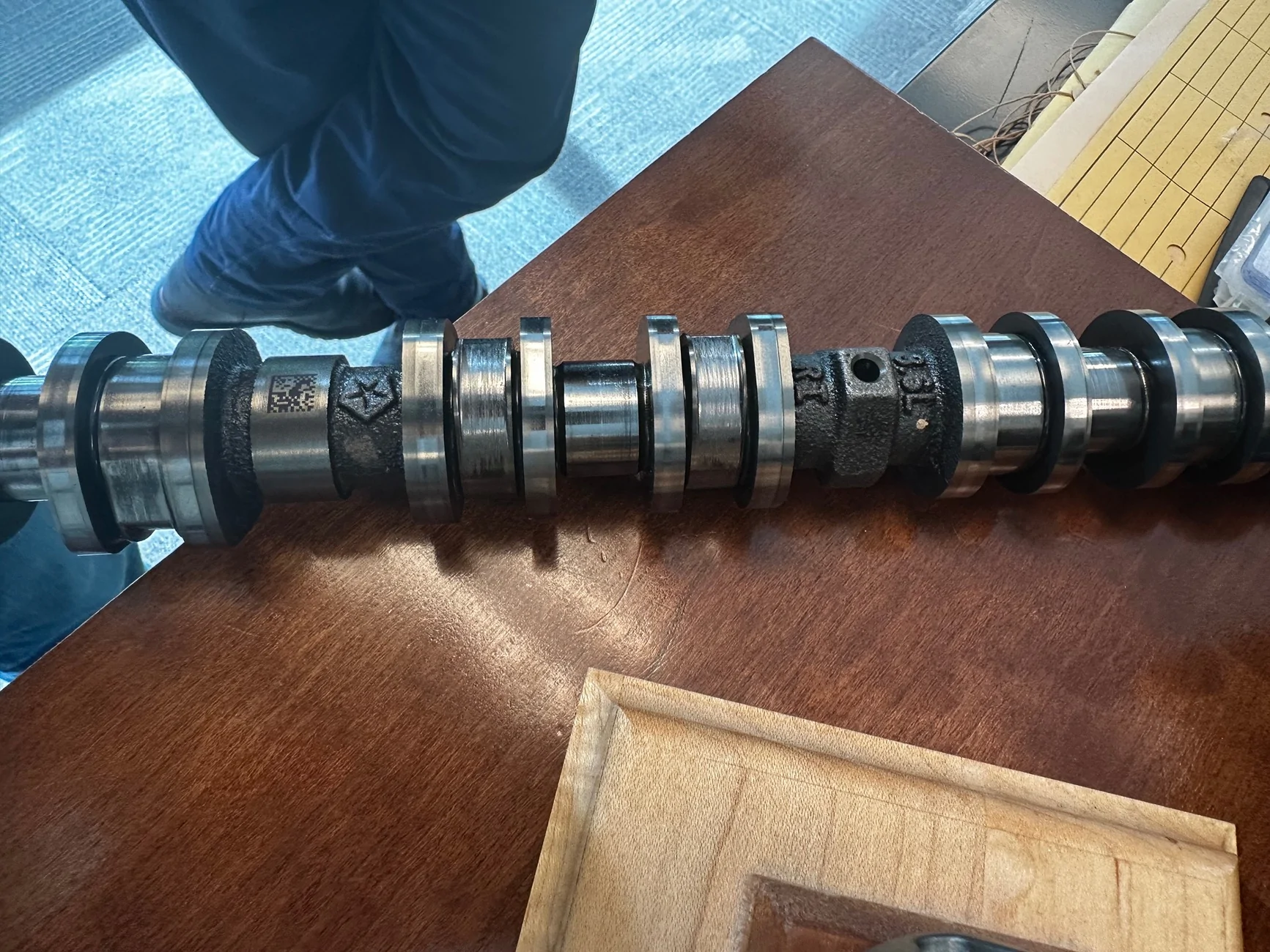

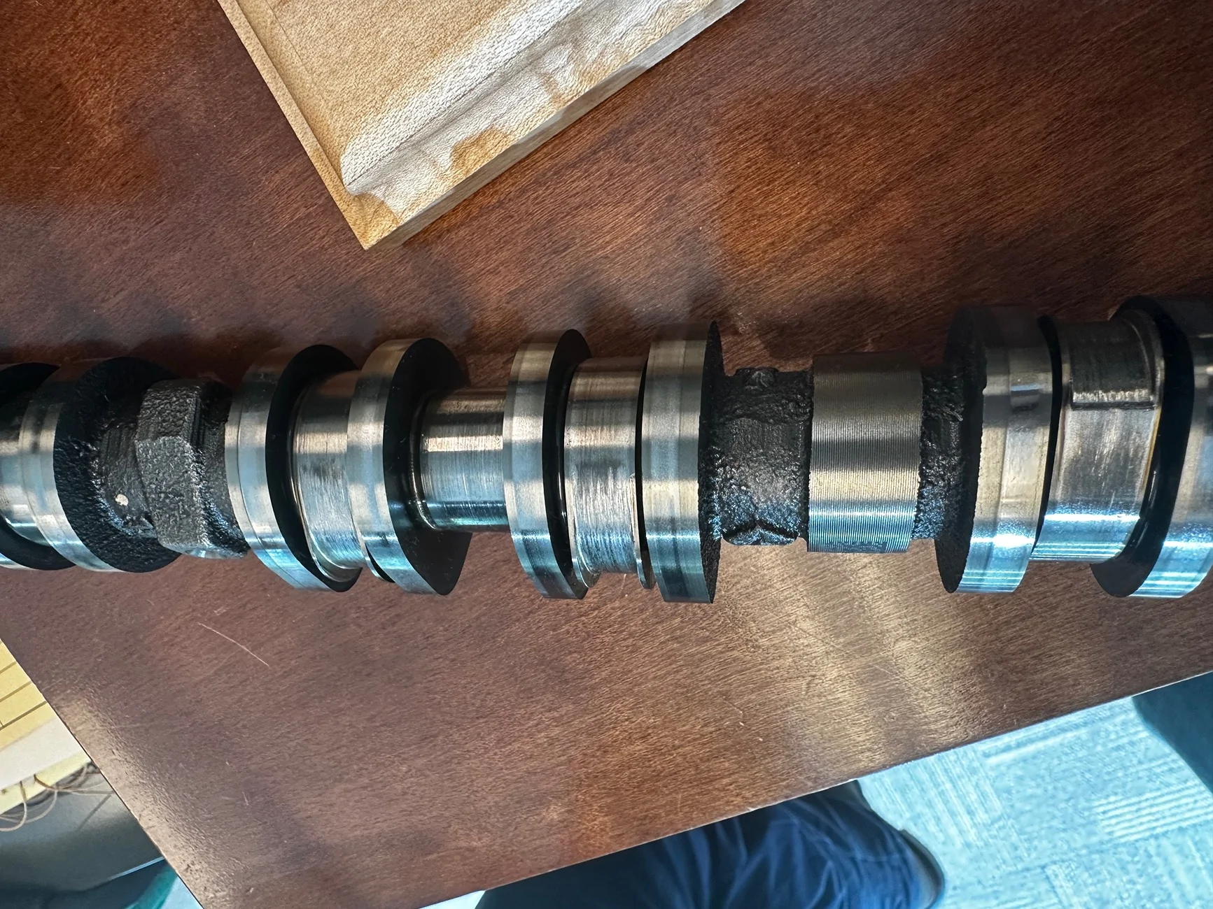

Cam shaft in the process of leaving the chat, my buddies 3.6 cam with 99,000 miles.

Lofty, thank you for leaving this nightmarish pictorial in my mind. YES. I agree it needs to be done, even if only to do a cam upgrade. I am thinking of buying the Wrangler from my wife just to do right thing and not just watch her drive it into infinity griding that cam for its bearing-erosive powder. Maybe, its a good thing it sits in the garage for weeks on end.

My buddy bought the kit from the dealer for around 500 bucks and did the work himself. No issues since and it’s been a few months, and he daily drives it!
