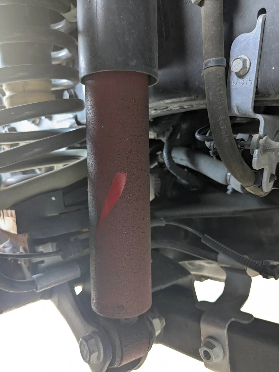

My Rubicon has 25K miles. I noticed that both front shocks appear to be leaking. I took it to Rydell CDJR in San Fernando, CA. They said that the shocks aren't leaking and the "mist" is normal. The service advisor also called it "sweat." My rear shocks were already replaced at 15K miles because they were leaking. Now, the rear shocks are clean and bright red with no seepage at all.
Is the dealership right, and this is normal? Or should these shocks be replaced? I put a finger mark on the shock in the photo below to demonstrate the level of oil on the outside.

a little seepage can be normal but that looks excessive. I would wipe it down and see how fast it comes back.

I consider that blown. Does it still work.

That means the shock is losing pressure and oil and bypassing the seal. That is not normal. If you are just grocery getting, the Fox 2.0s will be fine and if you are hitting the dirt, get the Fox 2.5s. The 2.5s are great for both the dirt and the highway, if you don't overload the vehicle.

if this was "normal", why are the rears not doing it?
which dealership is giving you this BS? sounds like another dealership to stay away from (as too many are).
i'd consider this an opportunity to change shocks (and dealerships).

It is not normal for a shock to leak at all, especially that much.
