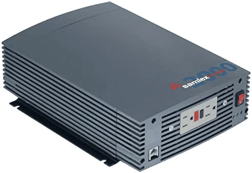

I did this exact project a couple years ago and I found the key was an inverter that has an all solid state output stage, kept the unit a manageable size. At the time my choice was a Samlex 2000 watt, about $340:

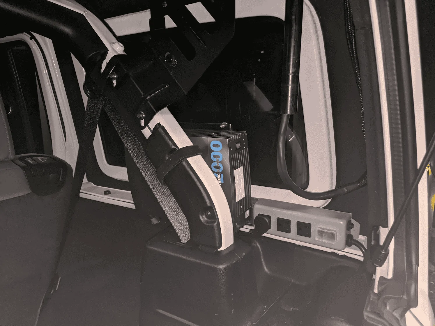

It's mounted in the back and I use it every time we camp.
Jeep Wrangler JL Inverters? 1657466713304
It runs off of a house battery mounted in the cargo area storage tub, if you're going to run it from the vehicle battery check your wire sizes, can draw over 150 amps.

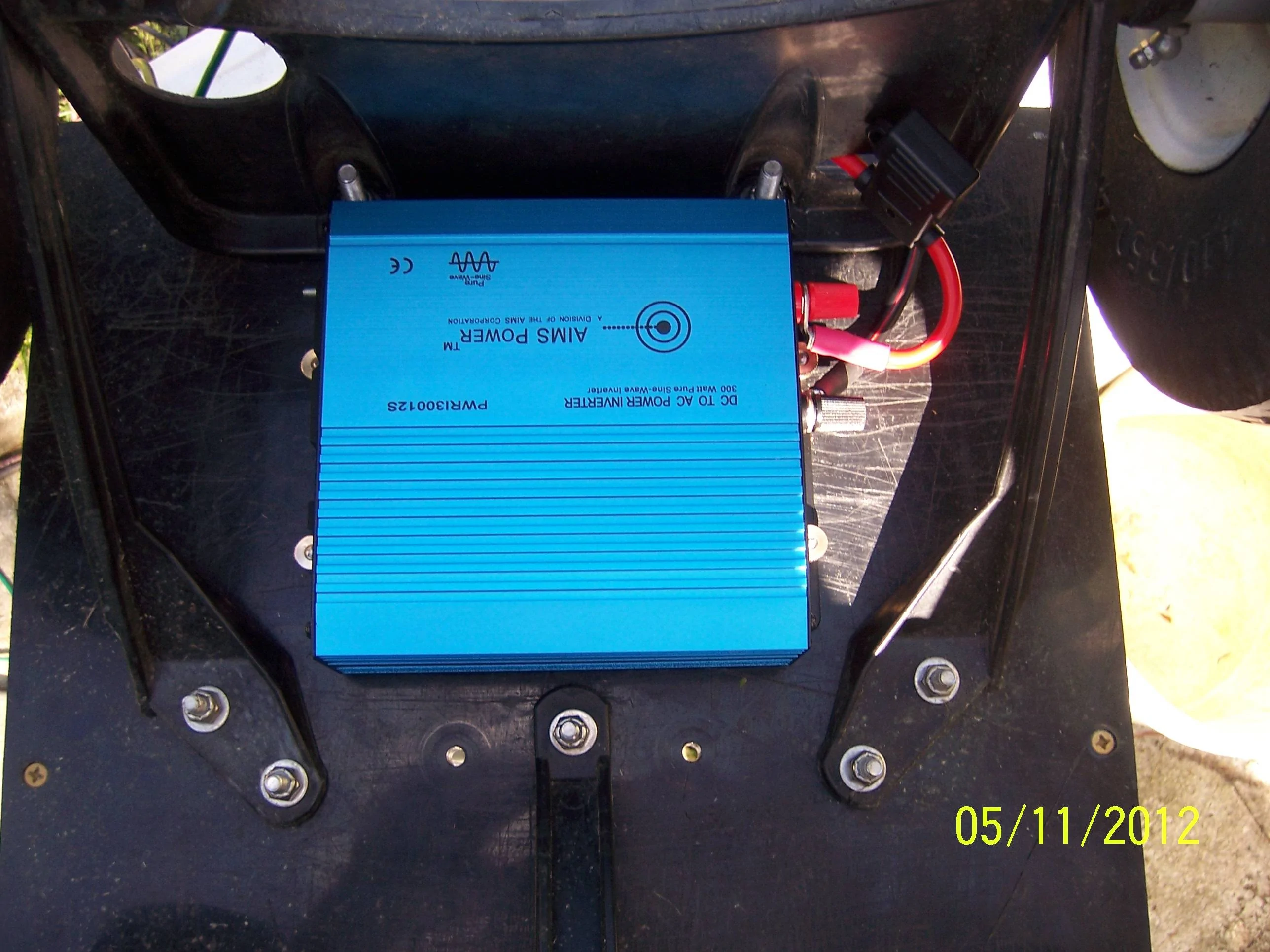

The undercarriage is from a wagon (I still have the tub) https://www.northerntool.com/shop/tools/product_208007_208007
Makes it easy to maneuver and keep facing the sun. Its all plastic and I changed the hardware to stainless. Originally built with flooded L/A batteries I wanted no problems with corrosion, then there was the odd chance of something shorting out.. plastic no problem. Wheels were changed to marathon run flats. The originals lasted a few years but then it seemed like every day a tire was flat.

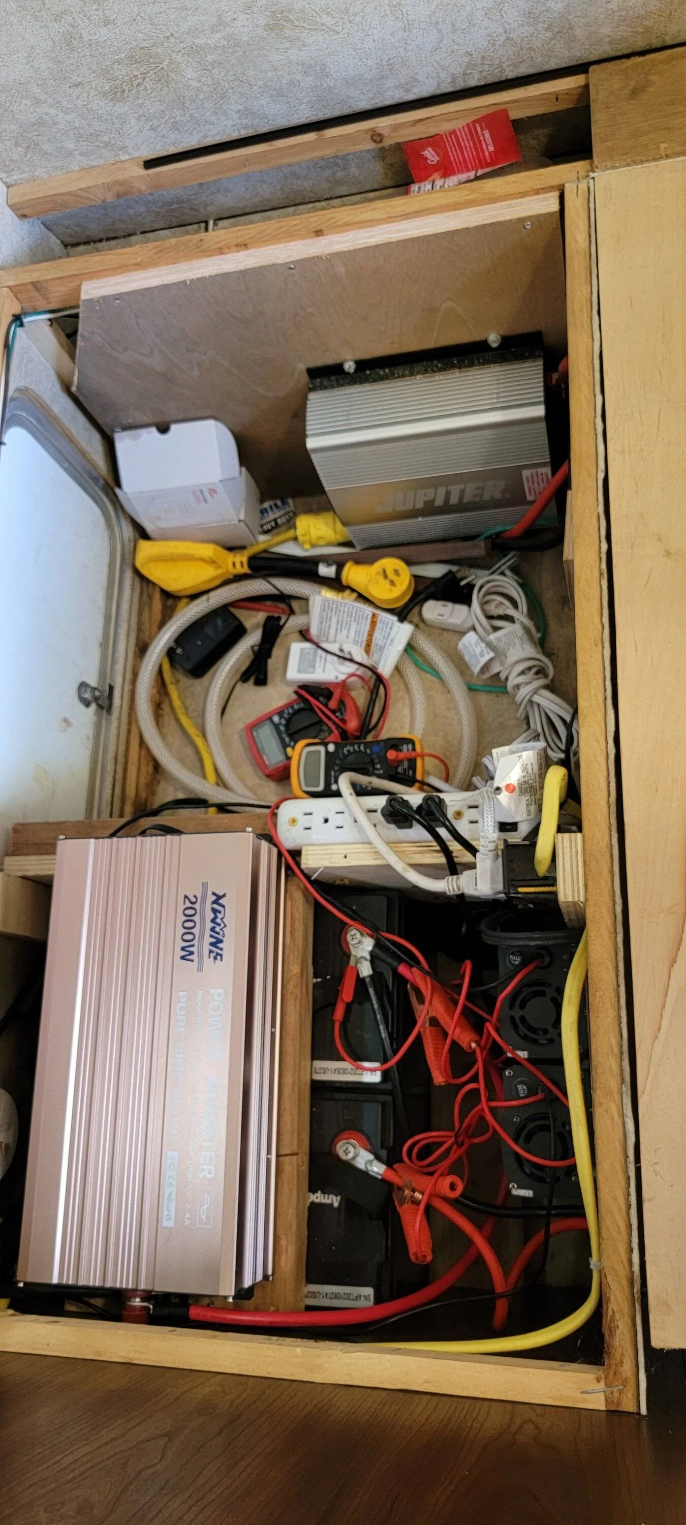

For the last coulpe weeks I have been converting a passenger van for sleeping and cooking. It came OEM with a second battery isolated from the starter battery for powering accessories. So, I installed a $260 1000w Renogy inverter with thoughts of powering a $40. electric water kettle , or $80. 700w RV microwave or $40. 700w heater, not all at once. With a new $200. deep cycle Renogy 125ah battery, the inverter would shut down in seconds. As recommended by Renogy, I added a second matching battery and the same inverter runs any of them beautifully. After all was done, everything was just under a grand. Yes burning propane would have been much cheaper, I already owned the gear for that, haha.
What was the voltage at shut down? Where did you get a 125Ah AGM for $200? Using my 2,000 inverter with one of my 12V 100Ah LiFePO4 Deep Cycle Batteries, I can put a 1,500 watt load on it without shutdown long enough to cook or boil water. I run two LiFePO4 to the pure sine wave inverter. The 2K cheap inverter is feed with it's own AGM battery.
I have dual propane tanks so the inverter primary runs my refrigerator.
