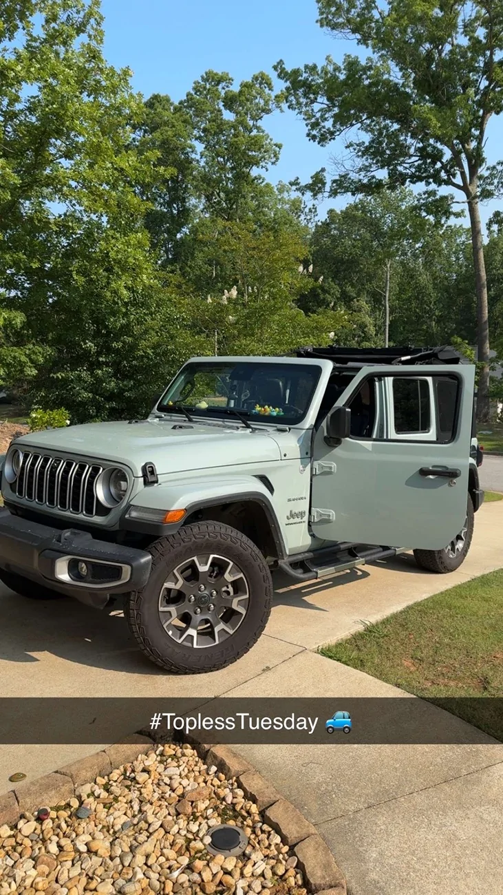

Hello, all! My name is Matthew, and I am new to the forum. I have a 2024 JLU Sahara w/ the 2.0L turbo engine, soft top, Earl blue/grey.
