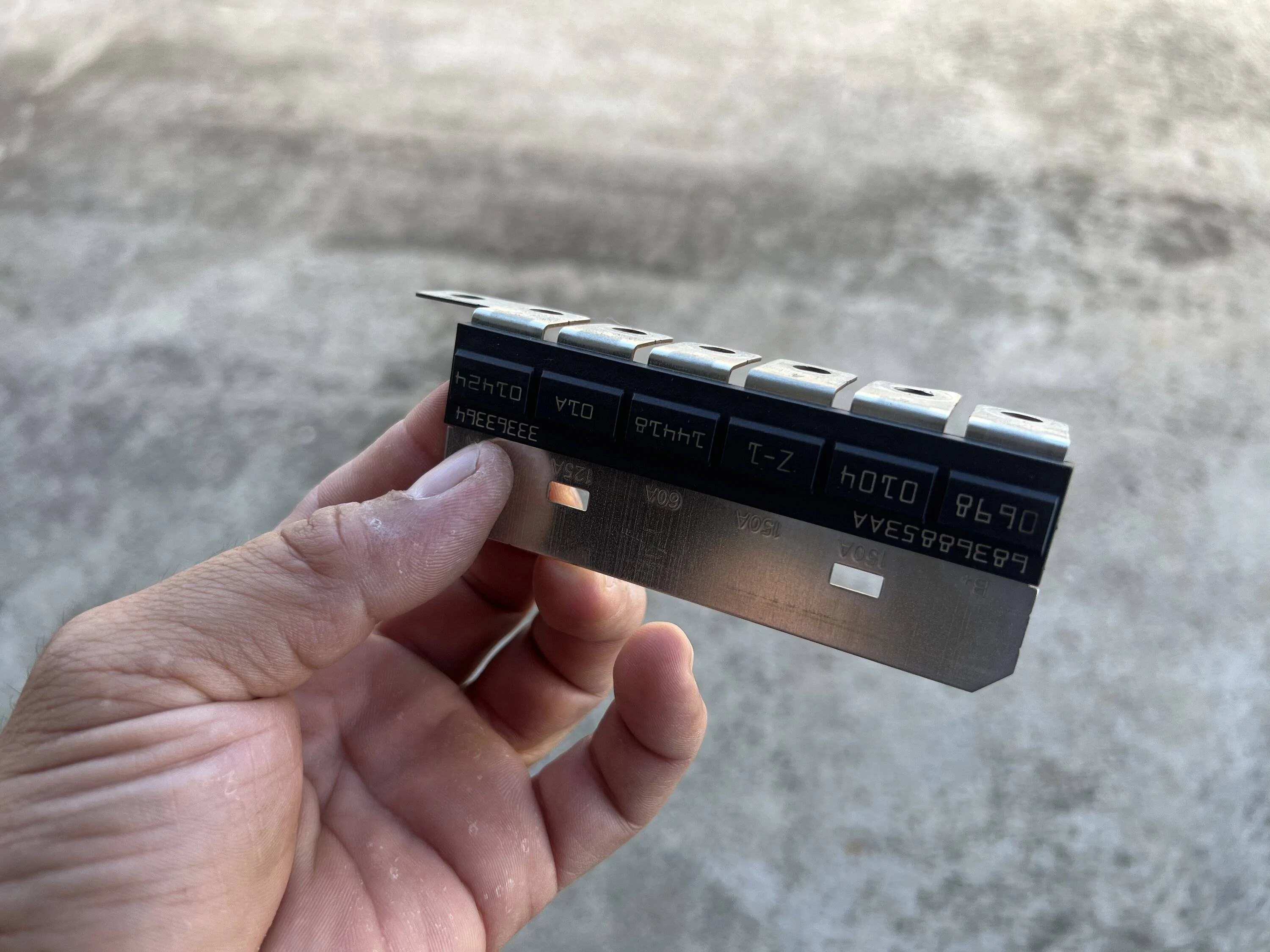

@Rhinebeck01
Your Assumption was Correct.
N3 Fuse has no continuity.
Just ordered a Replacement WITH an Extra just in case.
Going to Disconnect Aux Battery for now until the new parts arrive, to make sure the new battery does not go bad.
Super happy for knowledgeable forum users as yourself.
Thank you and happy new year.
