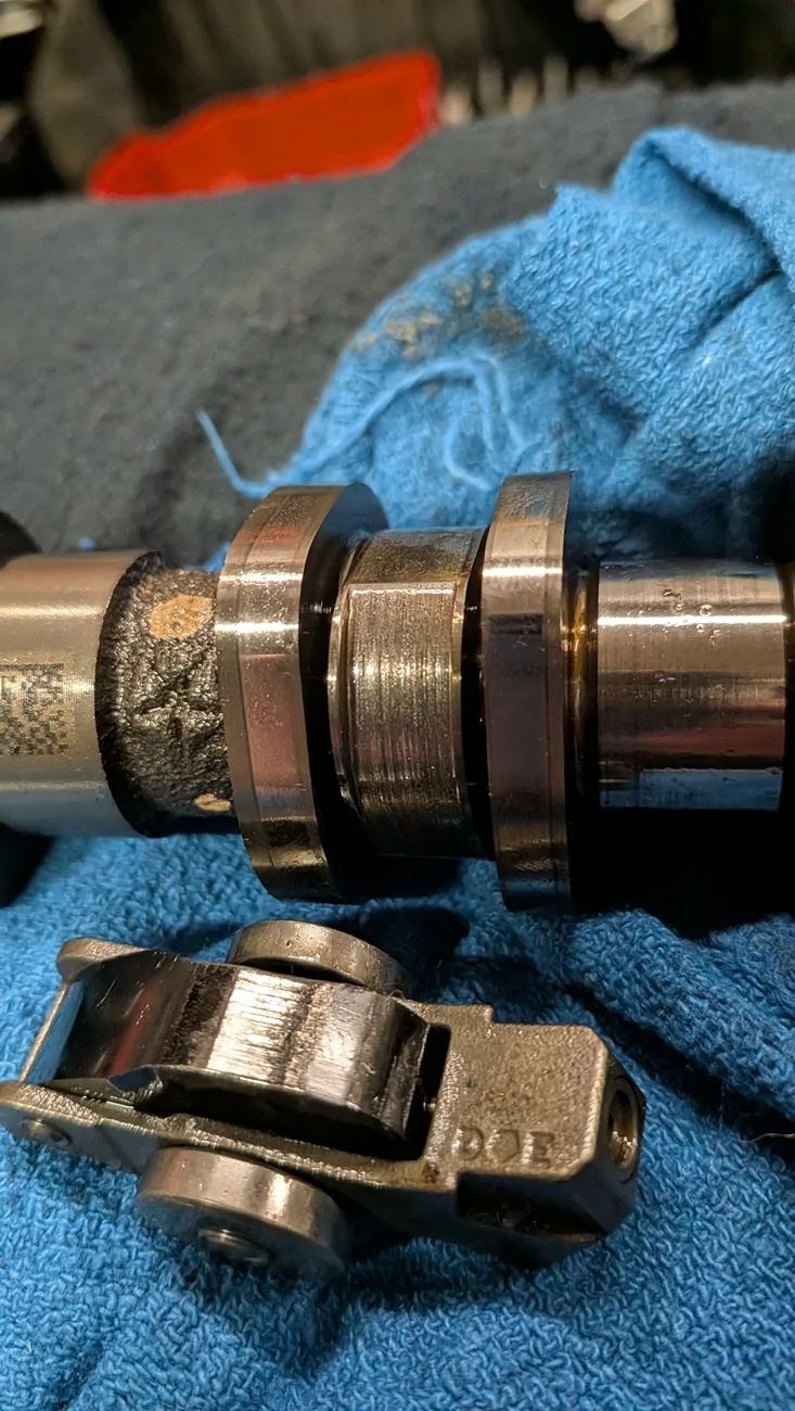

I had cam and rocker failure on my 2020 JLUR 3.6L. The failure occurred on bank 1 over cylinder 3, with the intake cam lobe and rocker being the only parts damaged at 46,000 miles.
I have maintained a 5,000-mile oil change interval using 0w20, but I am considering switching to 5w30 given my location in Northwest Ohio. Additionally, it appears the bank 1 intake cam is frequently back-ordered.
I put a magnetic oil plug in, hopefully there was not a lot of metal in the engine. I first noticed the tick at higher RPM's around 3500.

Back to the topic of Cams. The picture above is similar to others that I've seen from the PUG. And it still makes me question the metallurgy of the cam. Hear me out. Yes, what we see is abrasive wear of the lobe due to lack of lubrication. There is no spalling or pitting which would typically be present when a hardened surface is overloaded. We just see a perfect groove where the slipper wore away at the cam. That to me at least looks like soft metal and lack of lubrication.
Really is what it looks like

The followers use rollers and a slider like section. Most of the failures are on the slider portion. This leads to a rolling bending metal fatigue failure of the cam. Which points to either a metallurgical problem, lubrication problem, or both.
That would be a design failure to me, should be roller
