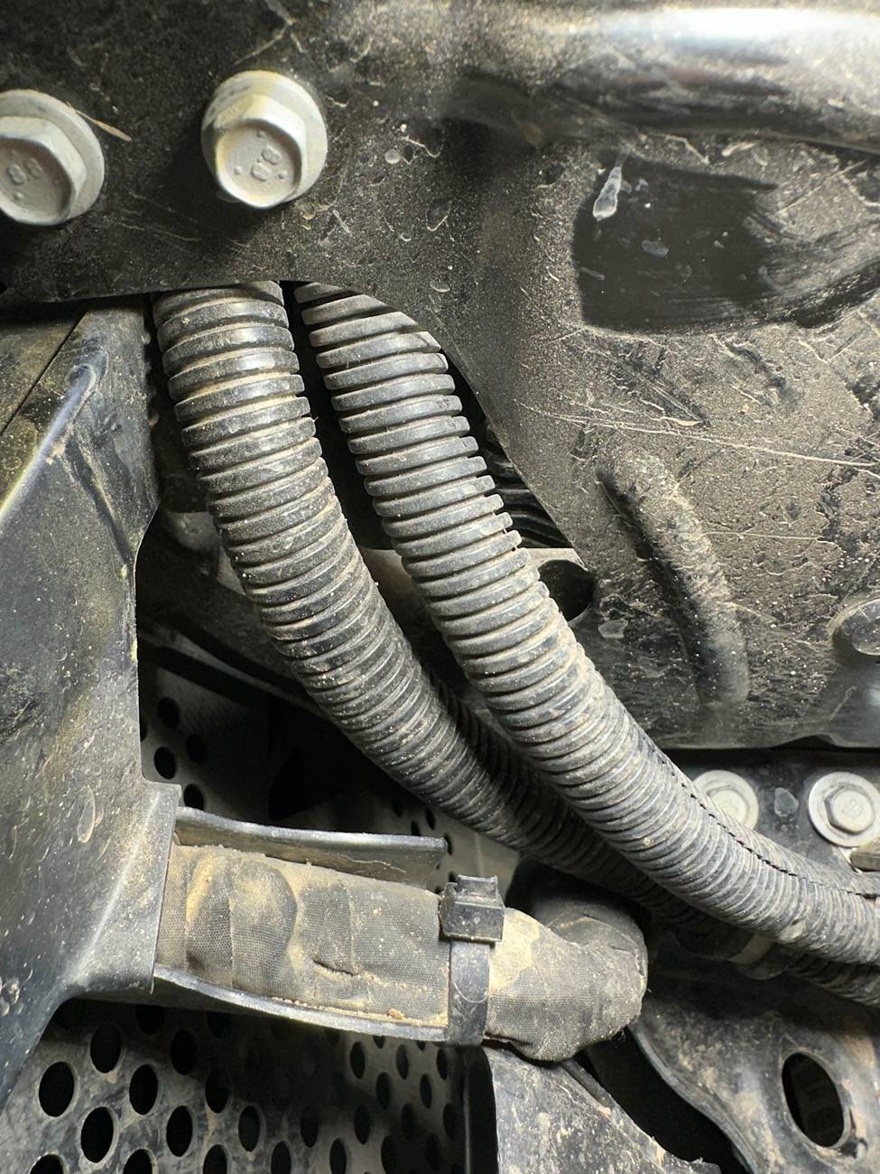

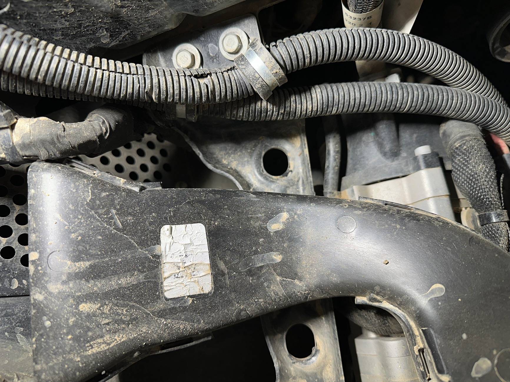

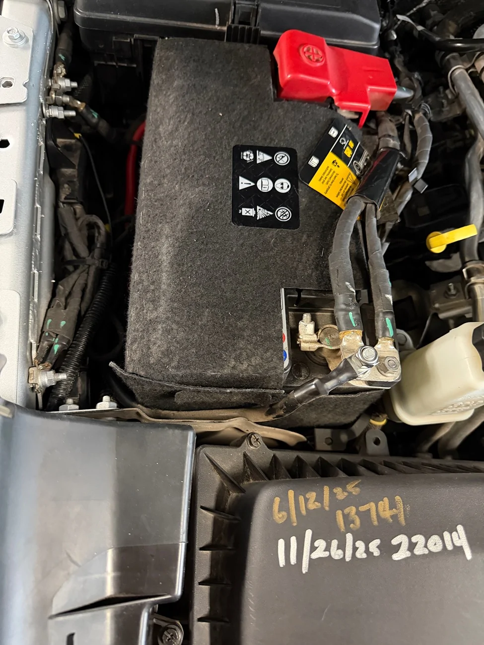

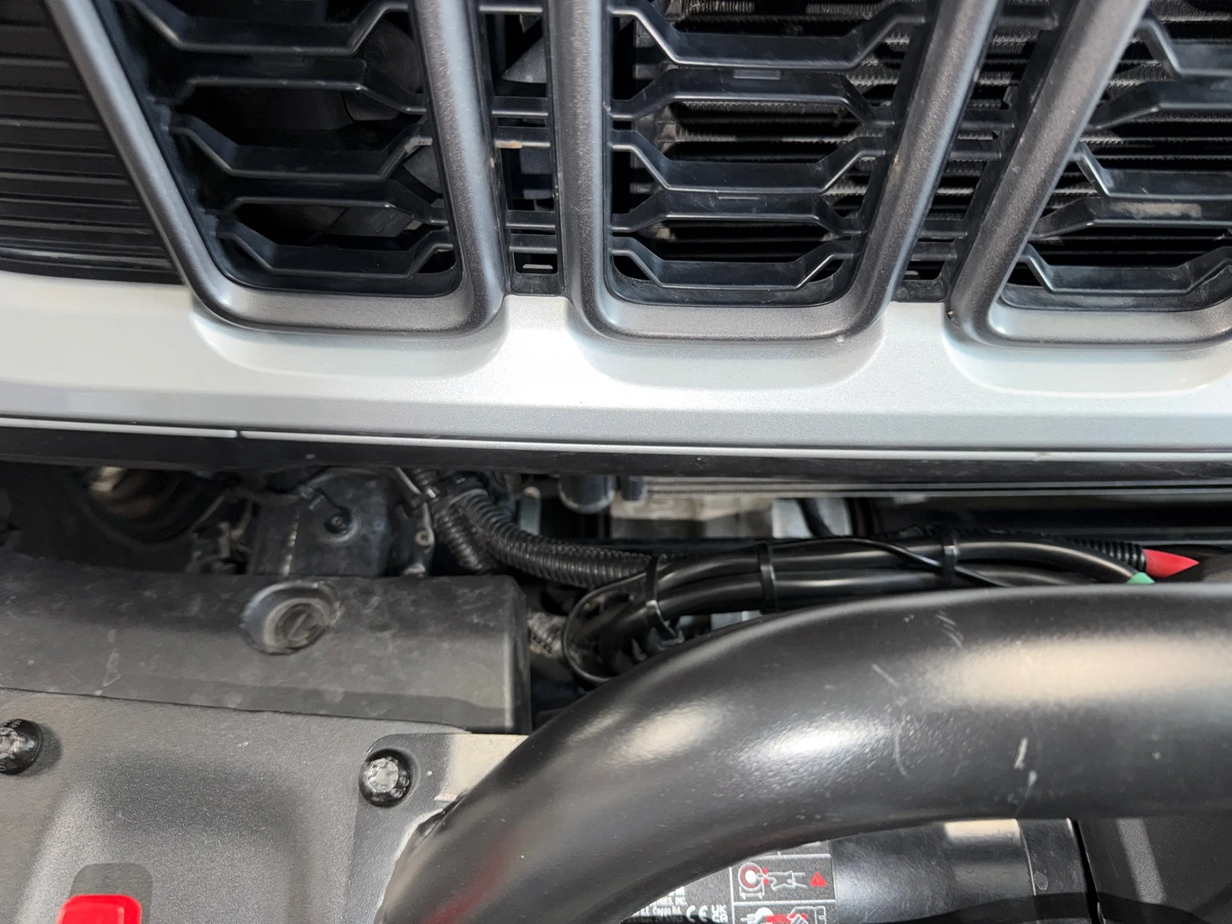

If you remove 3 bolts you can prop the air filter box up and route the winch wiring underneath the air box without removing it. I added fire resistant wire loom and used a couple of clamps to secure the cables at the front of the battery tray for good measure. Just ignore the dirt in that pic that was taken a while after the install,

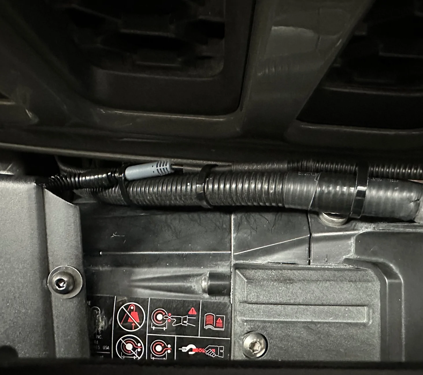

I sheathed the wires in plastic wire loom, and ran them up between the plastic fender shield and the grille/ fender. Then secured them with Zip ties, and went right to the battery. Super easy, took 10 minutes.

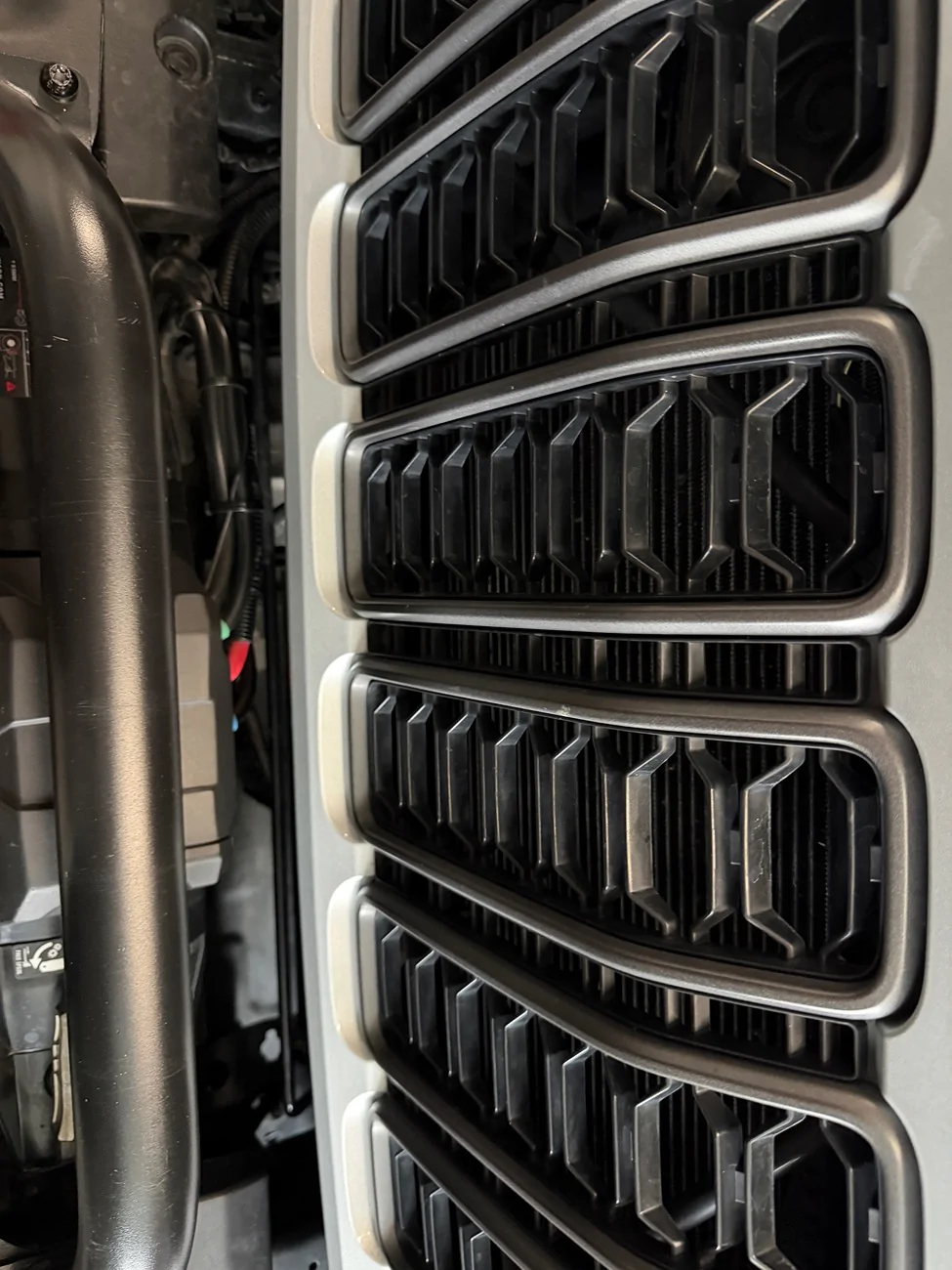

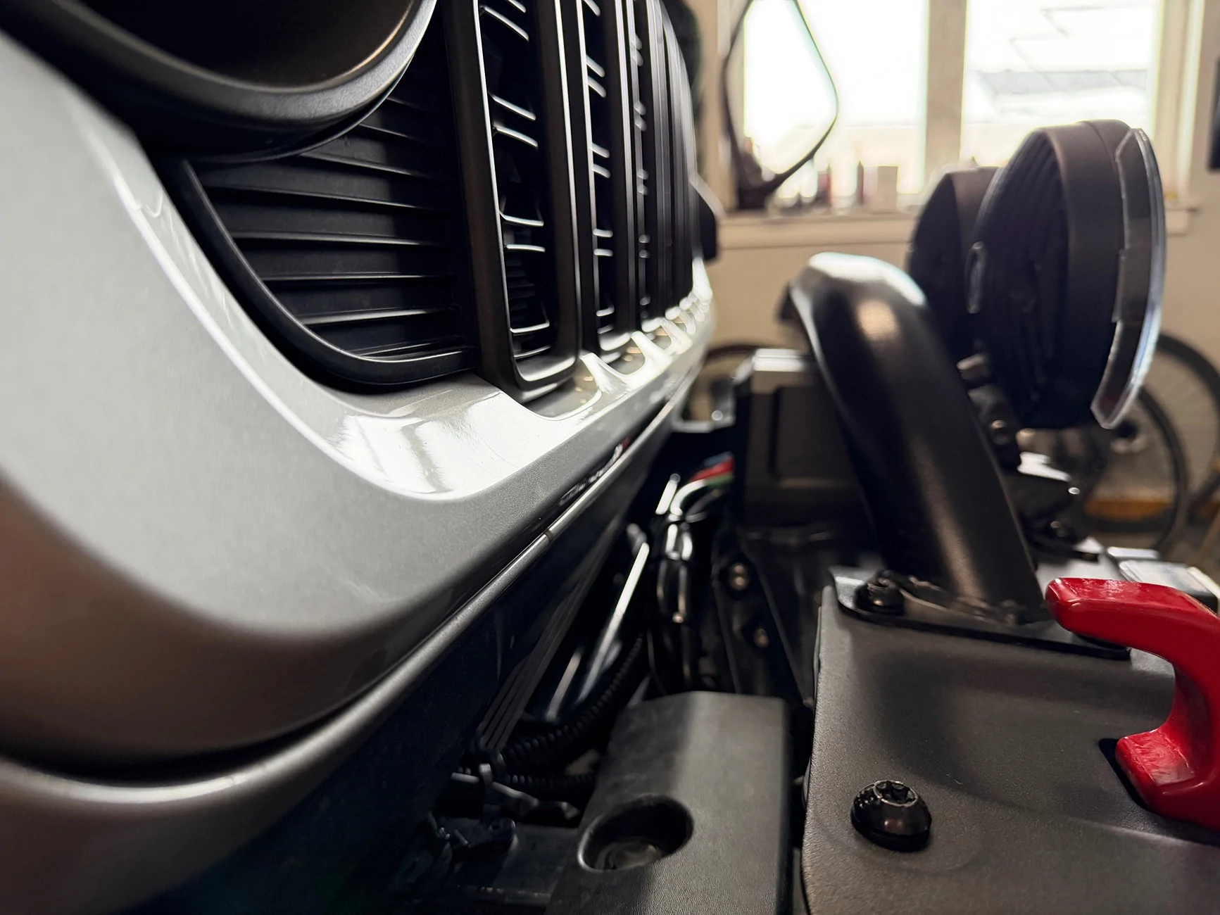

not on 24 and up...I pull my grill with no issues...and makes it much easier running wires.. there are 6 push pins holding and it just unclips...no need to trim anything on the grill like about shows. also being an old drunk I find it easier to remove things that trying to fight with getting stuff around them. takes literally a minute to pull the grill and the same for pulling the air box and makes it simple..but I know we all have our own way of doing things so no right or wrong.
